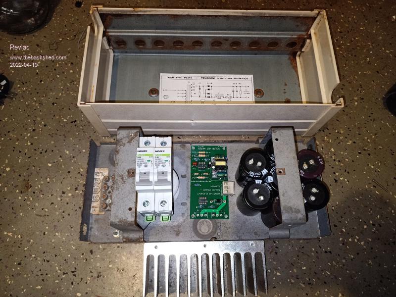

A little progress, found an old Telecom 48V power supply, will use it to house all the parts for the hot water circuit board.
The capacitors will be ganged together and hopefully covered, so nothing can enter and get toasted.
The on/off switch will be cut into the cover on top and the heat sink will be at the back underneath.
I might even put an old analogue volt meter on the front just for something to look at.....If I can find it....it was on a bench somewhere.
Cheers Aaron
Off The Grid

I get the impression that you place too much emphasis on the word "tuning".
There is no need to "tune" this simple method of heating water directly from solar panels.
All you need to do is to adjust the trip points when your Mosfets conduct to the expected solar panel voltage - that's it - any more just complicates this project unnecessarily.
Have a look at my build here: www.thebackshed.com/forum/ViewTopic.php?TID=15655
This has now been running for 20 months with zero adjustment required.
