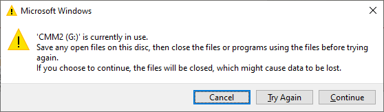

Time for a useless bug report but perhaps it might serve as a data point if anyone else experiences something similar ... alternatively I might just be an idiot.
It looks like I managed to corrupt my SD card again, though not fatally this time. I reached a point where LISTing one file would corrupt/overwrite the contents of another file !!! And after restoring the contents of both files it would do the same thing again, and again consistently. I honestly can't see how this makes any sense at all given LIST is presumably a read-only operation, but that didn't seem to prevent it happening.
In the end, and suspecting an SD card corruption problem I took a copy of my files onto a PC, reformatted the SD card and copied them all back on, and so far it all seems good, but I haven't thrashed it much since.
Just in case I am being stupid:
1. When is it safe to remove the SD card from the CMM2.
2. If I "eject" an SD card from a PC and am warned that it is in use, but given the option to continue anyway (after which it says it has been successfully ejected / is safe to remove) is it actually safe to remove?

  Quote  1. When is it safe to remove the SD card from the CMM2.
Any time when you don't have a file open. FatFS does buffer writes to some extent so this could create problems particularly when creating a new file.
  Quote  2. If I "eject" an SD card from a PC and am warned that it is in use, but given the option to continue anyway (after which it says it has been successfully ejected / is safe to remove) is it actually safe to remove?
What OS? I've never seen this dialogue on W10 but if I did I certainly wouldn't continue as you have no idea what the OS has buffered

Windows 10 (and my more usual Raspbian), on the former it is this dialog:
In any case I would have thought the worst I would get is a file not containing the latest/expected data and the symptoms I reported suggest I more seriously corrupted file-system - I'm very far from an expert on this.
