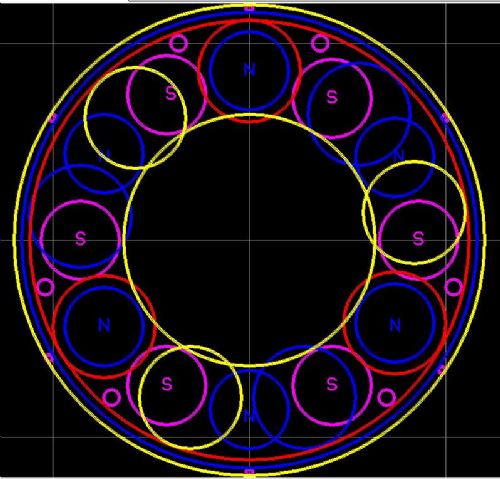

This is the typical layout for magnets and coils. 3phase [red,yellow and blue] and 3coils per phase, and 12 magnets, 6 pole pairs on dual rotor disks.

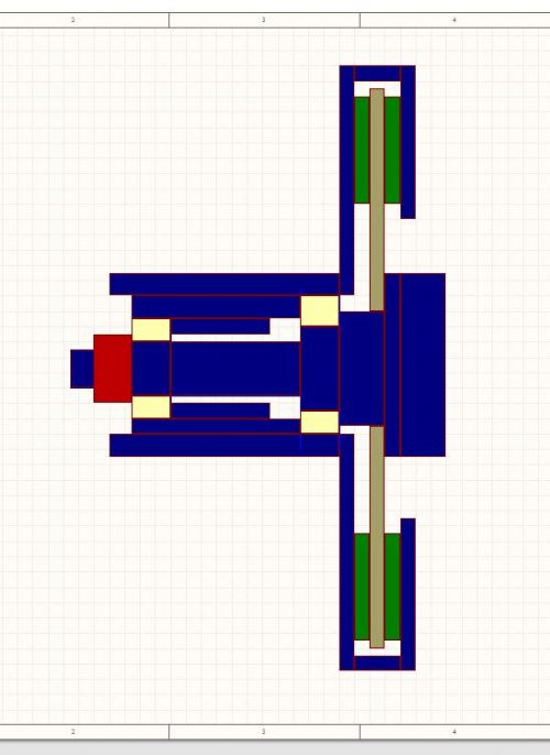

This is the proposed x-section view. very rough sizes, not to any scales. stub axle, supporting bearing housing with rotor attached. Stator connected to stub axle.

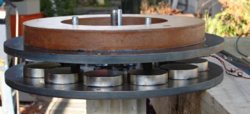

This is a photo of the coil testing rig. This is similar to the open style dual rotor AxFx alternator. The magnets are just temporarily fixed with a drop of cyano. This is with only 1 magnet ring at this stage. More magnets yet to arrive. A range of Fixed length spacers have been tested so far. I have tested an air gap of 10mm,14.5mm and 20.5mm. The 14.5mm is looking at being optimum so far. This will give approx 12mmx12mm coil sections, with a coil OD of 66mm and ID of 42mm. I still have some optimizing with the final coil and magnet positions. As large as possible final diameters to fit inside the perimeter ring.
The final engineering drawings, machining and fitting will be done by Zest engineering. I don't have the necessary equipment to build the alternator. If all goes well, this design will provide high efficiency and robustness.

I like the design, but hope the stator is "stubby" enough to remain stiff enough to resist harmonic vibration which may compromise the magnet faces under extreme load.
It may be that you can use some creative coil design that will spread the outside coil wire into a thicker profile while taking the outer perimeter of the coils closer to the center of the coil(squash it inwards and fatter a bit). This would thicken the fibreglass outside the magnet path, and allow you to perhaps move the mags further out towards the perimeter radius a little bit more.
This would in turn lower the leakage flux and and give a slightly higher magnet speed for the same rpm.
If you did this for the inner leg of the coils, it would allow for thicker fiberglass at the fixing point end of the stator, and make for a stronger, less uniform stator... less chance of harmonics forming, while still keeping the magnet area of the stator at 12mm thick.
This would probably require winding the coils in a winder where the two sides of the former were partly open, allowing the top and bottom of the coil wire to spread over the side whilst maintaining 12mm tolerance on the coil sides for the diam of the magnets. This of course would make the stator disk die more interesting..
Look forward to the updates
...........oztulesEdited by oztules 2009-02-21
GWatPE
Joined: 01/09/2006
Posts: 2127
Posted: 10:05pm 19 Feb 2009
Hi oztules,
the design is flexible enough to do all of the above. I intend to make a flat stator first. I have plenty of wire for testing. The relatively small number of coil turns makes it easier. Thickening in the centre is similar to my original design. This was much harder to mould. I may compromise and only thicken on one side. I have quite a bit of space to work with.
I also intend to wind the coils from the inside out, to overcome the wire crossing over thickness and make a more uniform coil. These are mechanical aspects and not electrical, so won't affect magnet components too much.
cheers, Gordon.

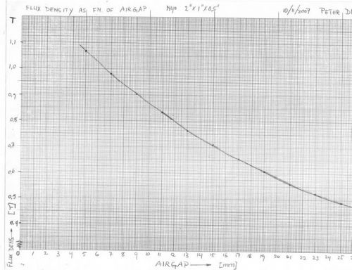

Gordon, here is a graph from Dinges.... something to ponder over a coffee perhaps. It plots the air-gap to testla.
I found it interesting when trying to develop the best airgap/winding ratio.

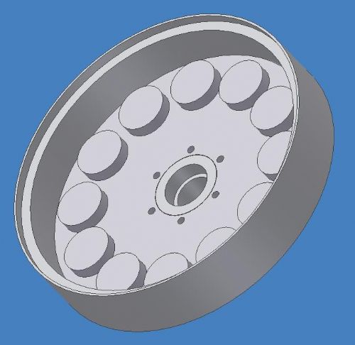

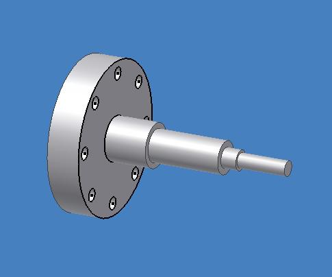

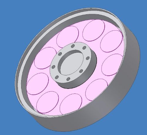

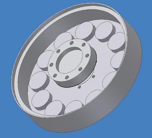

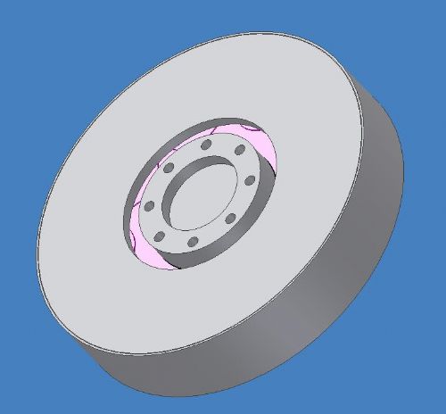

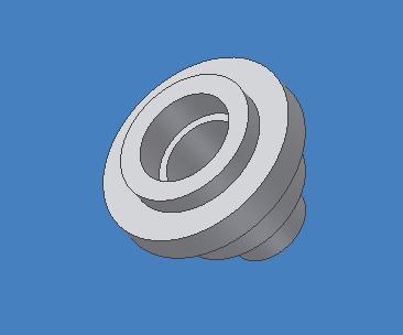

I have drawn up some CAD pics of expected shapes and assembly of my design. All parts bolt together. I am still working out the CAD program, so this is not exactly the final layout.
Here are some of the pics of expected stages of assembly.
This is the stub axle:
This is the bearing hub:
This is the front magnet plate/blade mount plate/joining ring:
This is the front magnet assembly with the axle inserted:
This is the rotor axle assembly with the stator attached:
This is the final assembled alternator looking from the back:
The assembly is designed so that the rotor is centred between the bearings, and all the torque from the blades is transferred directly to the magnet rotors. The stator is closely coupled to the yaw box with the short stub axle. The gap between the stator hub and the rotor is visible. The electrical wiring will exit the assembly through alignment holes in the coupling between the stator and the stub axle. The stator will be clamped between a metal ring and the axle flange mount and be aligned on a step on the flange, yet to be drawn on the pic.
The design makes a compact unit that is sealed from blown sand and rain and the internals are well protected from direct sun, while allowing ventilation for cooling.
I have not shown assembly bolt holes, or jacking bolt threads in the final back magnet plate, or bolt holes in the bearing hub.
The machining is progressing as is the winding of stator coils.
Gordon.

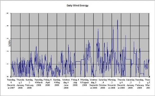

I am intending that my new AxFx mill spins whenever my Davis cup anemometer spins. < 1kph. I have noticed that ball bearings seem to offer more drag if they are stopped for long periods. My new wooden blades that I carved are thin in section [low form drag] and have high aspect.
A spinning windmill has more chance of harnessing the passing wind gusts than one that has to be started each time a small gust comes along and then stops again. The battery is spending more time at the float voltage. The small amount of power captured supplements the continuous small draw from the inverter laptop, and numerous controller systems connected.
Here is a graph of the last year or so wind energy harvest at my place.
Gordon.

This is the graph that went AWOL.
Gordon.
