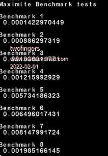

I
i just tested "mmbasic benchmark" on pa10.
Here the results :
1 : 5.18   e-07 = 0.000000518
2 : 4.11   e-06 = 0.00000411
3 : 6.599  e-06 = 0.000006599
4 : 6.149  e-06 = 0.000006149
5 : 2.2694 e-05 = 0.000022694
6 : 2.6841 e-05 = 0.000026841
7 : 3.4598 e-05 = 0.000034598
8 : 9.296  e-06 = 0.000009296
Ryzen 9 3950x 4.2ghz
Seems to be pretty fast ;)
twofingers
Joined: 02/06/2014
Posts: 1769
Posted: 11:24pm 31 Jan 2022
Amazing ...
My results:
Intel Q9400/~3GHz
Edited 2022-02-01 09:35 by twofingers

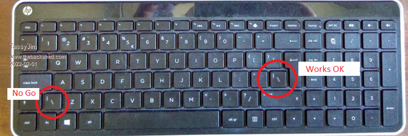

Posts: 6604
Posted: 02:47am 01 Feb 2022
'Normal' US format keyboards are OK
This one, the pipe/backslash key to the left has no response.
Re running bas file on commandline.
The program opens OK and runs for about 1-2 seconds before closing down.
