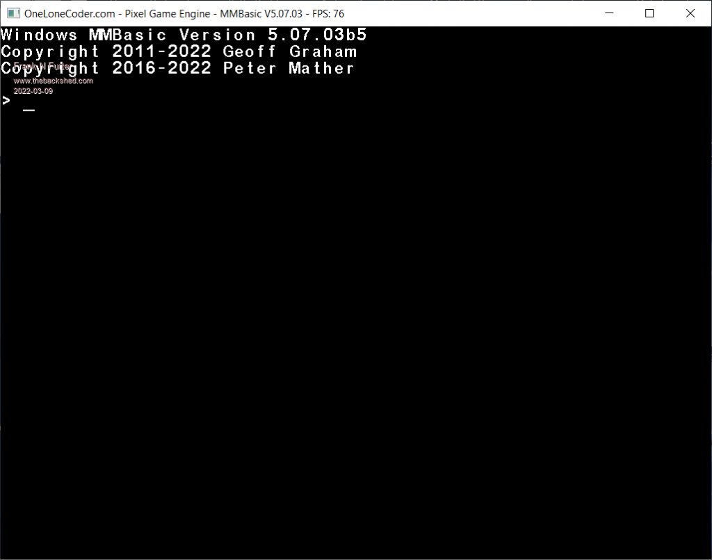

  Quote  Just got some time to play with this (03.b5), and it seems that there's something with fonts: in command line, as soon as I enter something invalid the font reverses to default:
This is intentional. There are lots of things you can do which mean the error message could be illegible (e.g. font of symbols). Therefore all errors default the font

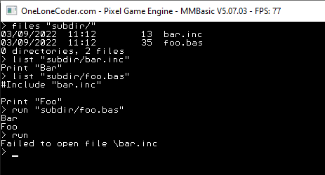

5. This one has been getting on my goat too and I've finally managed to reproduce it simply:
