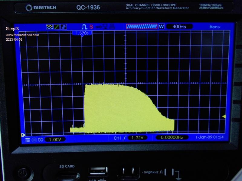

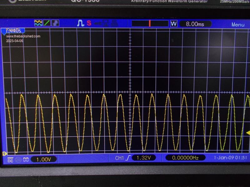

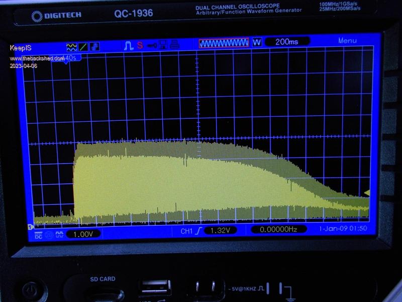

Need some help here getting my aging one brain cell working:
To start with I'm feeling a bit embarrassed as I realized that measuring the noise on the 0 Gauge DC cables feeding the inverter was incorrect, yes it did change with load but I never placed a big load over 3kW on the inverter and I was simply measuring across the supply lines with a DSO. This is where the cycling is coming from out of the Clamp Meter and not 200ms to 500mv as displayed on the DSO directly reading between the + - DC cables.
The DC current flow to the inverter is a reflection of the current consumed to produce the waveform that the inverter is driving into the Toriod and the Load.
It stands to reason that it will end up being something like an AC 50Hz waveform (is my assumption wrong) the 500A Current clamp output indicates that this is correct.
The Magnitude of the waveform is proportional to the Current drawn by the Load.
Now we all know trying to measure anything across a resistive Current Shunt on the DC input to an Inverter is never going to work without some serious active filtering, and considering that the voltage is only 50mv for 200A and filtering my distort the true fast rising current peaks, then a quality Isolated current Clamp is the way to go, and this unit has very little HF noise at the output and produces 125A per Volt, you can use unshielded leads to the DSO and it's still clean.
I thought my Code for reading the Clamp meter on my ARM H7 controller was wrong as it showed very high peak current and needed to be averaged at least 3 times to match the Commercial peak reading Current clamp meter.
My problem and question is this:
The clamp is unidirectional and only reads the positive going current, but obviously will still produce a sine wave if the current drawn is a high power sine wave current.
A: Is the positive "DC current" excursion flowing into the Inverter the Peak current?
B: Does it need to averaged because of the Wave shape.
C: What is the expected current waveform at the input to the inverter under load.
D: Is a P-P current that needs to halved and converted to RMS current?
Like I said, brain not working and the reason is the Magnitude of the current and measured on an 0 Gauge cable close to the Battery Bank.
I'm going to try an active 50 Hz notch filter or Hi Pass filter on the output of the Clamp and see if this gives a better result with respect to what I'm seeing.
These are the DSO captures from Powering up the 3HP Dust Extractor:
DSO 1V per division = 125A per division from the DC Current Clamp.
Below: The current at almost 500A and the startup duration of 2.2 seconds before the current drops below 375A. That's around 500A * 47V = 23.5kW which cannot be correct, 12kW I can believe.
Below: Compressed startup waveform to give a idea of the surge current duration and shape.
Below: The AC current flowing through the 0 gauge cable.

You know, thinking about only the peak current, the Current Clamp is showing a transition from around 7A load to 500A peaks through the cable.
If I were calculating average power and current input then I would be using standard AC calculations.
But to me it really does look like the peak current is reaching 500A DC from the batteries, considering the Voltage at the inverter input has dropped from 56V to 46.7V on those peaks. I capture the highest instantaneous current and lowest voltage for Transient peak readings. Even true short term 200A current draw only drops the voltage to 51V.
That's from 25kW of LiFePO4 batteries with a constant discharge current rating of over 300A and a short peak capacity of around 700A through 1M 0 Gauge + - cable.
EDIT:
Reversing the Clamp obviously results in absolutely no current flow detected in reverse direction in the cable. The AC waveform, as mentioned before, is a result of only a positive current flow cycle from the inverter, have I answered my own question?
FYI The Huge Compressor shows a 563A Peaks at 47V for 800ms - you do the math - what am I missing.  This clamp produces 500A at 4V, the Clamp output was 4.5v on the Comp.
BTW I have confirmed the clamps readings are accurate to 700A when compared to a high quality Resistive shunt on my Saturation tester.
Edited 2023-04-06 16:57 by KeepIS

Hi Aaron, the math isn't the problem, it's the power it comes out at which, BTW, is 26.5kW
I could understand if it was spikes causing it, but it's not, as shown by the waveforms, the first thing I went looking for.
The current Sensor is accurately tracking the current drawn by the inverter to enable the Toriod produce a sine wave.
Yes, a current sensor on the Toriod primary is going to show a lot of HF and digital crap from the inverter drive waveforms, but the Battery DC input has no crap, again as shown by the waveform, the DC input is more a reflection of the AC waveform current swing in the Toriod.
Of Course I could be totally wrong and missing the bleeding obvious, hence my plea for help from someone with a clear perspective.
But one thing I have proven, that the measured current has to flow through the cable for this Current Clamp to produce this output voltage. This Sensor is fast enough to display microsecond pulses with clarity. There are none.
BTW The efficiency of this inverter is over 92% at high power levels.
The last photo is worded incorrectly. It should read: Shows the Current waveform flowing through the 0 Gauge cable.
Edited 2023-04-06 18:51 by KeepIS

Mike, I have not really been following what you are doing and I might be confused but maybe I can try to add some clarity ? (or confusion)
The last picture shows a peak about every division and a bit. The time scale indicates 8mS per division (a strange number what happened to 5 or 10.....). So it appears that there is a positive peak ~ every 10mS. This is what I would expect as the current ramps from close to zero to maximum every 10mS. It starts from zero, drives to a positive peak over 10mS & returns to zero and then drives to a negative peak over the next 10mSecs and returns to zero.
The current ripple should be at a 100Hz or 10mS rate.  Now to work out the true power, if you draw a line at approximately half the peak amplitude and fold it down then we have filled in the power envelope considerably so it now looks like inverted 100Hz ripple, Now if you multiply that result by 0.7071 that is how to convert the ripple peak to RMS.
So if we are seeing 500A peaks I would average that at 250A and then multiply it by 0.7071 resulting in 176 amps RMS, lets multiply that by 48V and the result is ~ 8,500W.
What I dont get is that surely you know this and I'm missing something as you would need to know all this to calculate the inverter efficiency at ~ 92% ? I assume you have an RMS AC amp clamp meter that will confirm the secondary power and > 90% sounds like the right ball park figure else there would be a lot of heat generated somewhere.  I do agree that the power peaks are ~ 24kW but the RMS is still around the 8.5kW mark?
I dont know if this helps or maybe you can confirm what you are trying to work out ?

Hi Mike, thanks for popping in, yes I mentioned calculating the power a few posts back.
The thing I'm trying to confirm is only the instantaneous peak current that would flow into the Inverter.
To me the current peak during startup of some of these big induction motors appears to be very high at 500 to 563A, higher than I had originally thought, due to averaging and my early Current Clamp limitations.
I needed to put this in a post as it gives me some clarity of sorts to think it through.
If the brief instantaneous Peak current really is 563A, and I confirmed that the Current clamp is accurate, then it's truly mind boggling to me that the FETS can take that abuse. Especially as at a slightly lower current those peaks continue for 2.2 seconds before dropping down to the Machine running current.

From memory the mains power factor with the DE running is .96, our huge 25 year old Air Compressor draws more current than the Dust Extractor though, however for a much shorter duration.
BTW the question of Peak current was only for the DC supply current and not the AC output currents.

Are you sure the peak discharge current of over 1270A is correct?
If it is, then at 48v that's over 60kW peak discharge.

KeepIS
Joined: 13/10/2014
Posts: 2282
Posted: 03:47am 07 Apr 2023
The problem with high power resistive current shunts is the very low voltage produced for the Current through them, commonly anywhere from 10mv to 75mv per 200A, so trying to read that with a multimeter is virtually impossible due to the massive transient currents and inverter noise on the shunt and power cable, 100mv to 500mv or more will swamp anything you try to read. They can work with balanced filtering but take more effort then it's worth IMHO, especially since a good isolated Current clamp is under $30 and can read to over 700A depending on which one you choose.
A DSO of some type will still be needed with an isolated Current Clamp if you want to to catch peak transients, but a multimeter is fine for everything else, a unit like the one I posted a link to earlier, it's low cost and very low noise.
