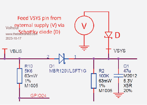

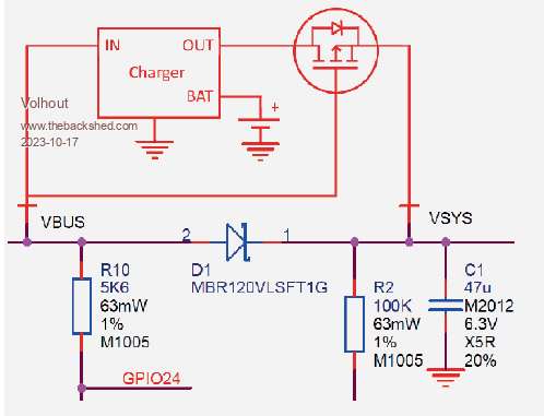

Posts: 5998
Posted: 07:13am 17 Oct 2023

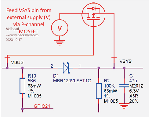

Gregor.
The Raspberry Pi Pico user manual is your best friend...
1. USB connector.
No drawing needed. Just plug in the micro USB cable
2. Battery 1.8V to 5.5V
Connect the + of the battery to the Vsys pin (pin 39) and the - of the battery to GND (pin 38). Use a diode to prevent pin swaps causing damage. Diode = 1N5817 or alike.
or
3. Battery 1.8V to 5.5V and charging module
There are many different charging modules.
4. 5V power supply (linear regulator)
I am not going into details on this, just google "LM7805" and connect the 5V output as in 2. above.
5. Noisy 5V power supply
Nothing you can do about that. The pico does not use 5V directly, only to make 3.3V

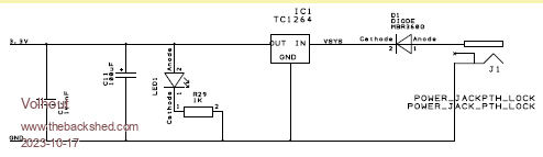

6. 3.3V power supply (linear regulator)
Best if you disable the on board 3.3V regulator by shorting 3.3V_EN (pin 37) to GND (pin 38)
7. Noisy 3.3V power supply
Use a linear regulator as in 6.
Hope this helps
P.S. typically your circuits work more reliable when you add a capacitor (10nF) from the RUN (pin 30) to ground. This prevents accidental RESET's in electrical noisy environments (industrial/welders/CF lights).
Edited 2023-10-17 17:21 by Volhout

aFox
Joined: 28/02/2023
Posts: 110
Posted: 06:19pm 17 Oct 2023
I agree with Lizby.
@Volhout
Two questions:
1. Which P-channel MOSFET do you suggest?
2. In case 6 we have to connect the output current (+) to VSYS, right?
Sketch 2 is build on sketch 1 and sektch 3 is build on sketch 2.
Step by step, very nice.
I think that can be summed.
Many thanks
Edit:
In sketch 2 and 3 is the Gain of the Mosfet connected to VBUS.
Is  5V power on the USB connector or VBUS, the battery will be switched to off.
Right?
Gregor
Edited 2023-10-18 04:49 by aFox

  Quote  2. In case 6 we have to connect the output current (+) to VSYS, right?
The output of the linear regulator in this case is 3.3V, which is what we want to use as supply. Connect to 3.3V pin on the RP2040 board and disable the on board switchmode regulator.
Fred
What happens if I want to transfer data via the USB port in this case?
Gregor
Posts: 8973
Posted: 07:55pm 17 Oct 2023
Raspberry Pi Pico documentation
The Raspberry Pi Pico Datasheet, sections 4.4 (Powerchain), 4.5 (Powering Pico) and 4.6 (Using a Battery Charger) is the definitive information on powering these devices. :)
The main thing is that you mustn't power the Pico via its VBUS pin unless you can guarantee that the USB won't be connected. If you don't follow this rule the computer's USB chip may get damaged.
Powering via VSYS is ok as it is fed from VBUS via a diode. This prevents the back-feed.
You can also power at 3V3 (into the 3V3 pin) from an external regulator. If you do this then you should connect 3V3EN to GND to disable the on-board switching supply.
Posts: 5998
Nothing happens, that works great.
All platforms Mick and Peter have developed use this configuration.

Posted: 12:52am 18 Oct 2023

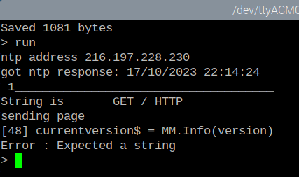

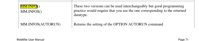

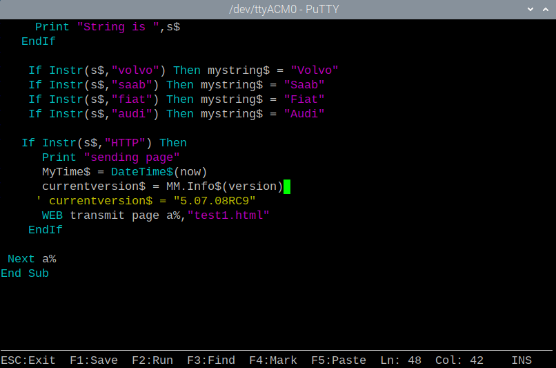

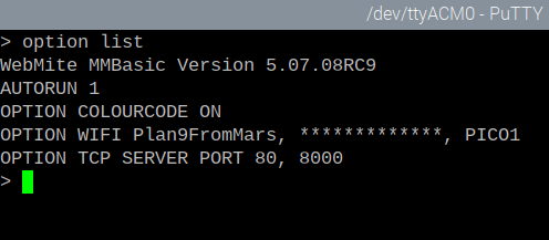

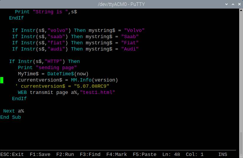

@matherp
Hi Peter;
I don't know if this is an error or my understanding of mm.info$(version) as used in a .bas web program. I 1st saw this in RC8, don't know if it goes further back.
I am using RC9 on webmite.
From 5.07.07 manual I saw this;
Tested on command line , no errors;
Used it in a web program as follows;
Saved and ran the web page and got the following error;
F4 into editor which takes me to the error and the $ is missing;
This is repeatable every time. Why is the $ disappearing on F1 and/or F2 in the editor?
Suggestions?
Thanks for all your hard work. If you need more info, no pun intended, let me know
Hans ...
PS: Tested on RC4 of Picomite same error in editor, $ disappears and throws error.
Edited 2023-10-18 13:03 by Hans
TheMonkeys
Joined: 15/12/2022
Posts: 59
Posted: 03:27am 18 Oct 2023
Hi Hans,
From the Documentation:
  Quote  MM.INFO(VERSION) Returns the version number as a floating point number.
This is regardless of whether you specify MM.INFO(VERSION) or MM.INFO$(VERSION).
Also, that "volvo","saab",... bit, I recall seeing that on Mozilla.org.
Cheers,
Chris
Posts: 6549
Posted: 04:06am 18 Oct 2023
Keywords are tokenised in the program.
When you EDIT, the tokens are converted back to their text representation.
Once it gets tokenised, MMBasic forgets what you originally used
Use ? in a program and it gets listed as "Print"
Use mm.info$() and it gets listed as mm.info()
and many more...
Edited 2023-10-18 14:07 by TassyJim

Posts: 8973
Posted: 07:35am 18 Oct 2023
  aFox said  Which P-channel MOSFET do you suggest?
What someone suggests isn't necessarily what you can get or what you can solder. There is an excellent one (DMG2305UX) suggested in the Datasheet, but it's surface mount so it's inconvenient to use unless you are also surface mounting the PicoMite.
P-Channel MOSFETs aren't all that easy to find in through-hole designs now. I suggest that you look through a catalogue of components that you *can* get and look for one that has a low threshold voltage (well below the incoming voltage that you want to use) and a low "on" resistance. It also needs to be able to carry at least 5V (that'll be easy) and something above 500mA.
It's not easy to sort out components like this when you are trying to find something that's available internationally.
If you would like to discuss this further please start a new thread.
