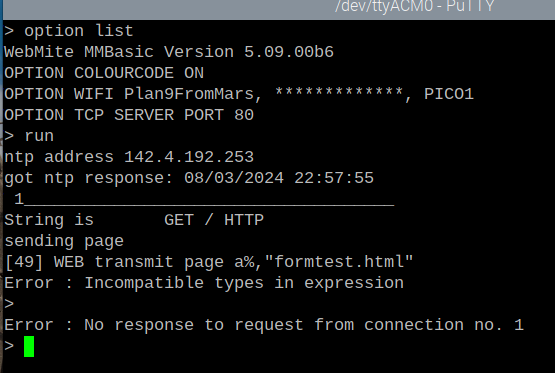

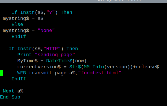

Hi All;
Just trying 5.09.00b6 and getting an error on web transmit page command.
The error happens as soon as you try to open the web site with the browser.
Worked in 5.08.00 did not try this with other betas
Here is the error line;
Got the same error with the example from the manual.
Suggestions or comments.
Thanks,
Hans ...
Posts: 6603
Posted: 05:02am 09 Mar 2024
Works for me.
There was a problem with beta6 when it was first uploaded so try downloading again.
Hans

  TassyJim said  Works for me.
Will do thanks.
