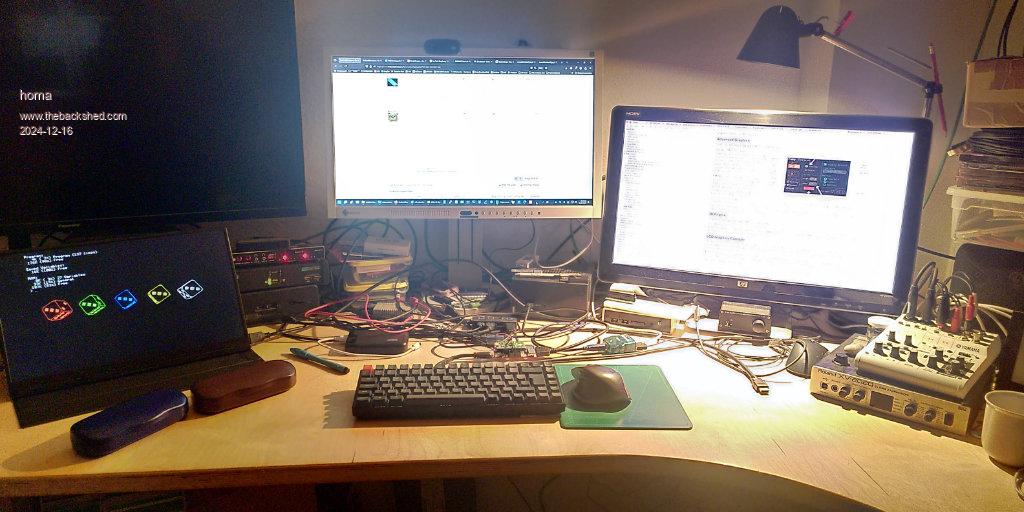

I hate reading PDFs and love an old-fashioned ring-bound dog-eared manual. :)  The PDF approach is also next to useless unless you have two screens. I need to look things up constantly as my short-term memory is terrible (medical reasons).
Printing the manual in two chunks is fine, but I would definitely prefer it if the chunk that I'm unlikely to ever use didn't need to be in the manual at all. ;)
The best manuals I've ever used have been those that you can leave open flat on a table while you make a brew. The worst are those that close themselves unless you prop them open with something weighty. Tablets and e-book readers that inconveniently shut themselves off to save battery power between accesses are somewhere in between.

Posted: 07:56pm 15 Dec 2024
Where is the problem ;-)

@Mathias
Ok, ok....  :)  That's about 8x the desk area that I have available. lol
