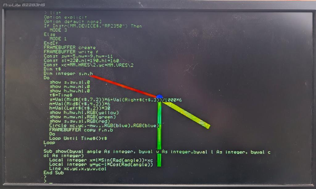

Posts: 12063
Posted: 04:36pm 21 Mar 2025
I've updated RC6 if you want to download. This includes a much better implementation of diagonal line drawing with a width > 1.
Prior to this release diagonal lines could only be 1 pixel wide. This version implements the ability to specify the line width. Previously horizontal and vertical lines could have a defined width and the x1 and y1 coordinate define the top-left pixel of the thick line. i.e. the line is to the right of the specified position or below it on the screen.
This makes no sense for thick diagonal lines where the line should be centered on the origin pixel. To maintain compatibility with existing code you specify this by setting the width as a negative number as in the example below.
This will display a clock in colour on the RP2350 but only in black and white on the RP2040.

Edited 2025-03-22 02:37 by matherp
