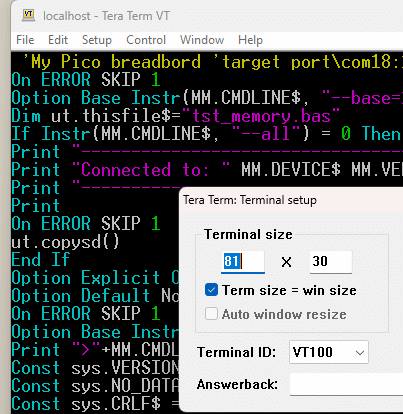

Terminal bug:
Using  the latest available ‘PicoMite RP2040 v6.00.03’ on a genuine RPi 2040 Pico.
Accessing it via USB in TeraTerm.
TeraTerm terminal set to 80x30.
OPTION DISPLAY 30,80 is set.
All works as expected until I enter the EDITor. TeraTerm then switches to 81x30.
This then leads to the issue I am seeing. If I edit the program code in any way, and then press ESC, the whole screen jumps one character to the left (I.e, I effectively loose the first column from the screen -but it is not lost forever from the code). If I acknowledge the ‘Exit and discard all changes (Y/N):’ with  N, then the screen redraws correctly (ie the first column reappears).
I believe the two issues above are linked.
Not tried on any other versions.
I have three other OPTIONs also set, possibly the first one ‘interfering’:
SERIAL CONSOLE COM1, GP0,GP1,BOTH
COLOURCODE ON
CPUSPEED 150000
Be interested if anyone else can replicate this….

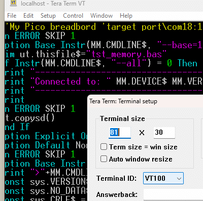

Posted: 01:18am 22 Jul 2025
@WhiteWizzard
It appears only to happen if the Term size=Win size option in Teraterm is not checked. I only unchecked this trying to replicate the issue so normally checked for me.
Unchecked.
Checked.
Edited 2025-07-22 11:20 by disco4now
F4 H7FotSF4xGT

Posts: 12060
Posted: 09:28am 22 Jul 2025
MMbasic always tells the terminal to be 1 character wider than the setting of OPTION DISPLAY. It does this so that auto linewrap in the terminal can't cause problems. Every version of MMbasic I've done does this.

Posts: 2994
Posted: 10:43pm 22 Jul 2025
  matherp said  MMbasic always tells the terminal to be 1 character wider than the setting of OPTION DISPLAY. It does this so that auto linewrap in the terminal can't cause problems. Every version of MMbasic I've done does this.
Fully appreciate your explanation but I am confused by what I am seeing.
With OPTION set to 80x30, and TeraTerm (TT) set to same, then TT will be 80x30 when at the command prompt, and when program-code is running, and when initially entering the Editor.
If I use the cursor keys to move TT’s cursor up/down/left/right then the screen is ‘drawn’ correctly and TT remains at 80x30.
If I use F3,F4,F5 the screen remains correctly drawn (and TT at 80x30).
If I edit code it remains all good.
ONLY when I press ESCape, AND having made at least one change to the program code (ie making the prompt appear at the bottom of the screen to effectively ask if you want to save the changes), does TT change to 81x30 and ‘shift’ the whole screen one space to the left.
Surely there is a small issue with the screen rendering when the prompt appears otherwise would it not always be an issue with rendering in the editor?
So, while I understand the quote above, it raises a question as to why it only does it for the ‘confirm prompt’. Note too that pressing N (ie to continue editing), the screen is once again drawn correctly (ie, it effectively jumps back one column to the right (and the first column reappears).
Hope this makes sense - and that maybe somewhere in the code it may be drawing the above screen starting incorrectly in column 0 as opposed to column 1.
