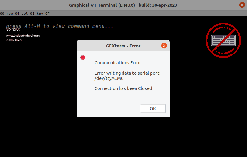

RC8 is dead on USB for 2040 VGA. Console opens, but does not accept any input.
Tested on Putty (never used anything else).
Edited 2025-10-26 21:50 by Volhout

Posts: 6197
Posted: 03:24pm 26 Oct 2025
Sorry Peter,
Tried everything. Flash Nuke, hard power cycle, but RC8 does not work with Putty.
Maybe something with timing ? No idea..
This is the 2040 VGA PS2 RC8 image on a genuine VGA reference design 2, without (at the moment) as PS2 keyboard. I try to use console to communicate.
Just to be clear: the startup message arrives at the PUTTY screen, including the prompt. But whatever I type, nothing is reflected on either VGA screen or terminal.

Posts: 6197
Posted: 03:52pm 26 Oct 2025
GFXterm64 (2023 build) gives some feedback when trying to use the console.
Posts: 12059
Posted: 03:53pm 26 Oct 2025
Try the one just posted - looks like crap Linux issue not handling increased USB buffer size
Edited 2025-10-27 01:54 by matherp
Posts: 6197
Posted: 03:57pm 26 Oct 2025
No change on both Putty and GFXterm64.
P.S. Don't put the blame on Linux, up to RC7 worked fine. You changed something that broke compatibility I guess. I checked RTS/CTS handshake is off, XON/XOFF handshake is off.
Edited 2025-10-27 02:02 by Volhout

Posts: 6197
Posted: 04:06pm 26 Oct 2025
Peter,
FWIW: Also tried MMCC, same behaviour. Noticed something that may be related. When trying to close the application (Putty/MMCC/GFXterm) linux refuses to close the application immediately (maybe because there is something in the USB TX buffer still) regardless if you typed a character or not.
When you don't type, the TX buffer should be empty right ? So maybe some character is send in Linux opening the serial connection, that is not sent in Win. And that character upsets the pico.
Posts: 6197
Posted: 04:12pm 26 Oct 2025
@Peter,
When I connect a PS2 keyboard, I can type text, and that text is reflected on the console terminal. So it is just the console->pico channel that is blocked. The other way works.
EDIT: My earlier remark was incorrect. When I type absolutely no key on the console keyboard, the terminal app closes immediate. when I type a character like <ENTER>, then it refuses to close until it times out.

Posts: 12059
Posted: 05:44pm 26 Oct 2025
Try this
I've slowed the echo response down because poor old Linux can't handle the echo fast enough.
You can also test the jpg dithering now
PicoMite.zip
Posts: 6197
Posted: 06:03pm 26 Oct 2025
Poor old Linux is happy again.
This last version works again. I will do some more testing, but so far it seems to work on 2040 VGA PS2
Posts: 12059
Posted: 06:19pm 26 Oct 2025
Here is the complete set.
PicoMiteV6.01.00RC8.zip
The change was as follows:
The non-working version used a character received callback at interrupt level which triggered the echo.
The old and now current version just polls for data being available every millisecond or so and then echoes it.
I know I denigrate Linux at every opportunity but it really is bad with USD CDC devices. First you have to stop it thinking any USB device is a f..ing modem (when did anyone last use one of those). Then the user has to be in the correct "dialup" group - I'm not dialing anything and finally when you can even talk to the port the choice of terminal programs is hardly impressive.
To test this fix I found an old box with ubuntu on it and once I'd finally got the port to talk could back out changes until I found the fix.
For reference I used picocom as the terminal which seems better than most for this sort of thing.
I couldn't use putty because when I installed it it wouldn't run and just gave a list of unitelligible errors - WTF

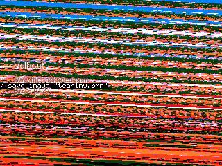

About JPG dithering. Something has changed when JPG size is larger than screen.
With RC7 you would just show top left part of the JPG that fit's the screen resolution.
With the change for dithering, when the JPG dimension is larger that screen (regardless the dither setting -1,0,1,2,3) you see a striped screen. As if the JPG decoding continues on the next pixel line after a screen wrap.
If you need a picture, I can provide.
When  the JPG is exactly 320x240 the dithering works fine.
P.S. picocom works nice for picomite...
