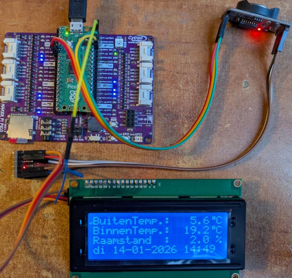

I'm using a MAKER PI PICO with the RP2350A module. On the right side, I've mounted a 4x20 LCD2004 screen on nylon bushings, and on the bottom of the LCD, I've installed a standard I2C to parallel module for these screens.
I solved the 5V bus problem by using 2x4k7 pullups from 5V to 3V3.
Underneath the MAKER PI PICO is a DS3231 module with EEPROM, all on the same bus. Because the 4k7 resistors are in parallel, the resistance is already lower.
Ten years ago, I created a greenhouse controller for a hobby greenhouse with various sensors using an Arduino nano and BascomAVR, which has always worked without any problems.
Last year, I had some problems with the 24V power supply, and now I've made everything 5V, and the rain sensor is showing signs of wear on the sensor surface.
I'm trying to get this controller, using the same sensors, to work with the PicoMite as well. The controls are operated using three keys: UP, DOWN, and ENT, and sensors include two DS18b20 sensors, a 10K window potentiometer, and a rain sensor. All 22 settings were then written to the EEPROM in the nano.

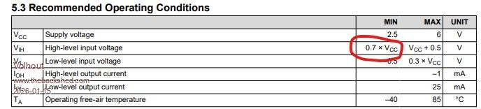

Posts: 6197
Posted: 03:41pm 14 Jan 2026
@Jan,
PCF8574(A) is 5V I2C (Vh minimum is 3.5V)
PCA8574 can work with both 5V and 3.3V levels at I2C
DS3231 is 3.3V I2C
Pico 2 in essence is 3.3V I2C, but can survive 5V under certain conditions.
I hope you are driving the chips at correct levels. I see in Peter's photo he uses a level shifter between pico and PCF8574. That is correct.
Edited 2026-01-15 01:46 by Volhout

Thanks for all your attention. I first measured the pullup resistor of the SDA and SCL on the connection pins, and it's 4K7.
Then I added a 4K7 pullup to the free SDA and SCL pins of the DS3231. (The value is now 2K4.)
The program started and now works flawlessly on the terminal with rrrrrrrrrr and on the LCD2004.
I still have a few 2-channel I2C level shifters (they have 8 pins), so that's the next step if this test fails.
It's been working flawlessly for over 2.5 hours now.

I'm using a level shifter between the RP2040 and LCD2004.
With I2CLCD: y, x 'y = Line number, x = Character number, C = Center.
PicoMite MMBasic RP2040 V6.02.00RC6
Copyright 2011-2025 Geoff Graham
Copyright 2016-2025 Peter Mather
> option list
OPTION SYSTEM I2C GP20,GP21
OPTION COLOR CODE ON
OPTION HEARTBEAT OFF
OPTION PICO OFF
OPTION CPU SPEED (KHz) 200000
OPTION DISPLAY 50, 100
OPTION SDCARD GP19
OPTION F1 FLASH RUN 1
OPTION PLATFORM PicoMite RP2040-SD:32G
> list
I2CLCD INIT &H20
I2CLCD 1, C20, "Hello world!"
I2CLCD 4, C20, "Love"
> run
Kind regards,
Jan.
Edited 2026-01-15 10:58 by JanVolk
