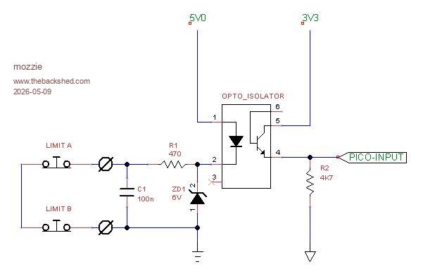

That PCB is coming along nicely, only thing I would suggest to add is opto-couplers on the limit switch inputs. I have spent many hours chasing obscure faults caused by voltage being induced into the limit wiring from the stepper drivers. This is my suggested circuit:
This could of course be on a separate PCB. Also the 22K resistor in the ENABLE circuit should go to 3V3 rather than ground, this DISABLES the drivers when the Stepper system shuts down and releases the pins.
I did ask Peter about the possibility of G54/G55 work offset but as he rightly replied, the inbuilt stepper system is not a full motion controller so some things we are going to have to do in our software. We do have G92 to use.
The surface grinder E-Stop system is going to be a bit of a problem. As you say, the Z-Axis really needs to raise and clear the job as the spindle winds down. A solution may be to wire the X + Y Axis enables through the E-Stop and when the E-Stop is hit the stepper system is shut down, then we pulse the Z-Axis step pin in our software to clear the table and then STOP.

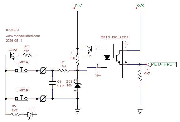

Yesterday I was thinking about the 2040 zero and what it could do apart from just monitoring the battery voltage well there is enough in/outs on the zero to do all 7 LED's so the 6 axis limits and the E_Stop.
Also I could put a 3V3 power module on the pcb to provide the 3V3 for the circuit.
I do have one zero setup on one of Mixtels boards so it is breadboard friendly so all the testing can be done.
Now the idea of toggling each axis out of the stepper system does seem like a good idea as one would input a distance in the number box which could be used as the distance $ then just pressing the toggle button can keep repeating the move.
Also yesterday made a start on the Z axis stepper so with a bit of luck I have have that going then the big job of machining the old X axis handle to fit the 56 tooth sprocket and the support for the X axis stepper motor.
Now as the program upload time is now 3 minutes and with every line of code that time is going to stretch and with the amount of errors that will come up it's going to be another very long day.
For the limits switch's I did look in the Altronics catalogue where for $7 each a leg with a roller on would suit nicely, still looking for cheaper one's so any suggestions will be appreciated.

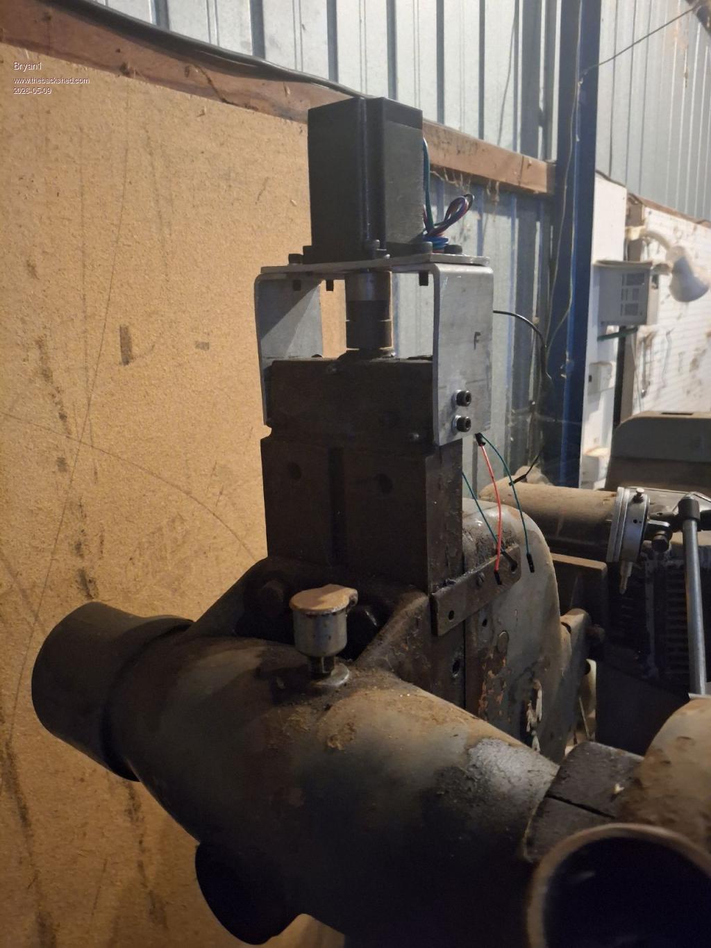

Bryan1
Joined: 22/02/2006
Posts: 2297
Posted: 06:50am 09 May 2026
Well finally got the Z axis stepper mount all finished
So now gotta put my thinking caps on as the X axis which is going to be a bit of work as I'm using chain sprockets a guard will have to be made.
Regards Bryan

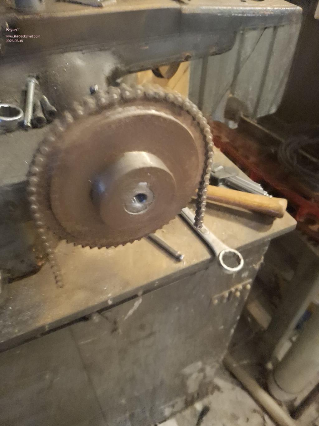

Joined: 22/02/2006
Posts: 2297
Posted: 05:02am 10 May 2026
Well another busy day machining and finally got the large sprocket mounted on the X axis
Still got to machine a thick washer so the sprocket can't move forward but I doubt it will as everything is tap in fit   Now trying to find that 1/4" chain I bought 20 years ago is still in it's hiding place so may just have to buy a new pack of chain.
The small sprocket will be mounted with the small sprocket as there won't be any end float to worry about and chain drives are pretty forgiven on motor bearings etc.
Also got to get some colour coded spools of wire for hooking up the steppers which I'll get when I get the chain.

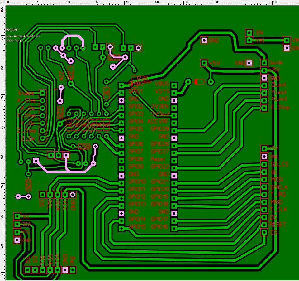

PhenixRising
Joined: 07/11/2023
Posts: 2100
Posted: 10:10am 10 May 2026
Hey Bryan.
Not at my PC so I haven't had a good look at the SL6 file but the last image that you posted has thermal pad issues.
The 22K resistor on the left has thermal pads on both ends.
The thermal pads on the Pico socket need to be 3 o'clock and 9 o'clock. The 6 and 12 need to go away.
I'll have a better scan at it when I get to my desk.

Phenix I did have a look at that SL6 file and noticed the dual thermal pads so fixed them but the lower central BC337 pads just won't connect to to the earth no matter what I tried so today I will get rid of the ground on plane on C1 and do do some tracks so it all connects.
One thing I did find when trying to do a thermal pad on C2 SL6 did the same to all of the pads which was quite frustrating. Not sure what you mean about this 3 o'clock 9 o'clock 6 and 12 o'clock actually means mate.

  Quote  Not sure what you mean about this 3 o'clock 9 o'clock 6 and 12 o'clock actually means mate.
Looking at the last image on the previous page the ground pads of the Pico appear to have bridges to the pads above (12 o'clock) and below (6 o'clock), which you don't want. The bridges to the left (9 o'clock) and right (3 o'clock) go to the ground plane as they should.
Same issue on the ground pads on both the connectors on the right side of the board.
And as Phenix pointed out, the resistor above the Pico has bridges to the ground plane at the left end that shouldn't be there.
Edited 2026-05-11 09:20 by phil99

Ah Ok looking at that last picture I see what you guy's mean, now as I got Vbus and VSYS pads wrong looks like my pico 2 macros is going to V4 as I made V3 when the ground plane was put in.
Anyway my intention is get all the steppers mounted and the DM556's mounted so the hardware side of the project is all done. Then the fun with the software can start once I change the breadboard over to the 2350A so all the pin assignments do match with the PCB.

Ok just redid the macros and solved the problem with the emitter pins by putting tracks on C1. As it will be a dual sided board may aswell use the top layer.
Took the screen shot in test mode and now everything should be right
pico 2 board.zip
Regards Bryan
Edit: when I posted this thread and looked at the picture I saw I didn't do the ground plane edit on the GND for the I2C connector so it's done now

Well very close to finishing the X axis mount and silly me hole sawed to big a hole for where the mount bolts on so decided well as my mig welder does work now used that on the 110 amp setting I tested it with  . After tacking plenty around the core so it would stay flat welded the first side with no problems now when I went to do a hot pass on the rear side got within 10mm of finishing the weld and the 16 amp circuit breaker in my inverter tripped.
So for powering the mig in future I think I need a higher rating pair of circuit breakers as the new 16 amp ones doesn't look to be enough when welding a long run.
Anyway for the chain alignment I found 3mm spacing out for the mount from the cast iron face does align both sprockets nicely   Now after tapping 4 off 6mm holes for the mount found only had 3 off 6mm cap screws left   so just after 5pm that was enough for the day.

G'day Bryan,
Looks like things are proceeding nicely   except being 1 bolt short
I found the version of the limit input circuit I will be using on my systems here, this is better than the one above:
LED 1 is on when the limits are closed (normal) and off when open (tripped)
LED 2/3 are high brightness across the limits and indicate a trip condition.
It will be interesting to see how a chain drive goes, I made the mistake of going gear reduction on the coil winder (its what I could find) and it sounds like a machine gun. Tooth belt will be the next try.

Hope to get back to working on my machines shortly.
