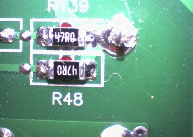

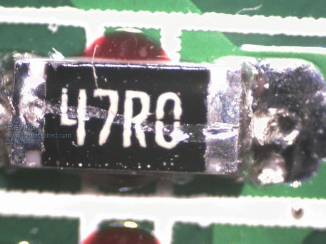

I have a duratech Ts-1610 10W from jaycar on special, should work for the little 8010 chip
Wish i had that other one, instead i have 5 different size irons.
I had a 60w weller and it blew up last month, so it was handy to something spare sitting around.
Some photo's with a usb microscope.
handy for finding suspect SMD joints and a shot resistors, There were 2 of them like this IGBT Gate drive resistors.
Could not see them with a magnifying glass

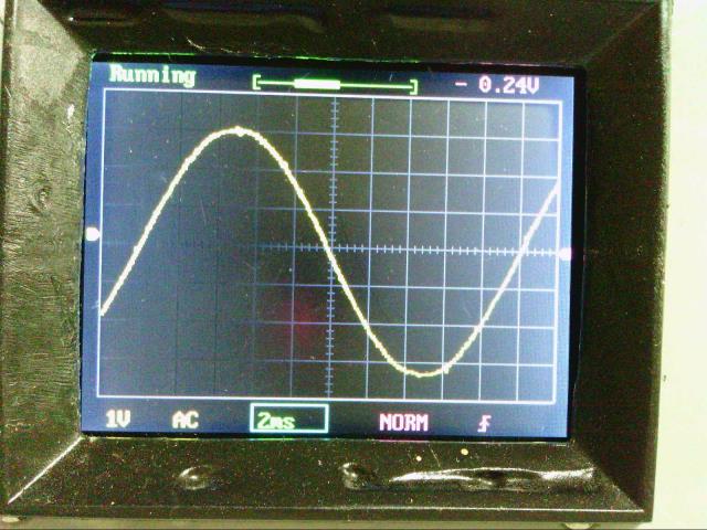

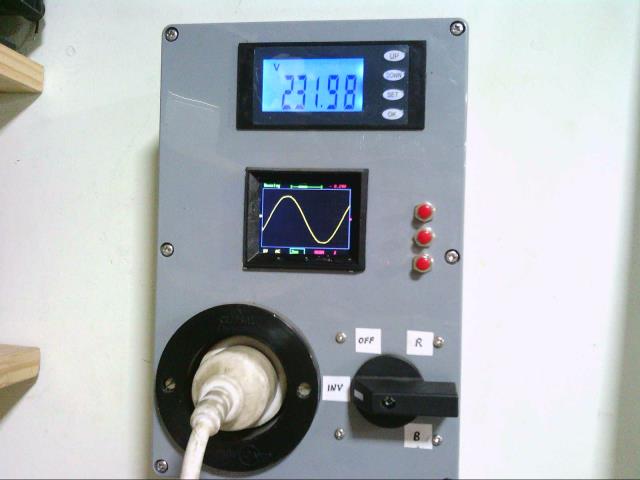

Well, mine arrived yesterday (cost only 15 dollars from aliexpress) and by today I had assembled the parts on the board.
It worked first try and I must say I'm mightily impressed with this little digital waveform monitor. It displays a pretty clear picture too of my inverter waveform, certainly sharper than that shown on the old CRO.
I will have to try to take a picture of that little screen next time I'm monitoring something interesting.
So, thanks for mentioning that kit warpspeed, it's about the best documented kit I ever saw coming out of China. And, as you say, a real bargain.
Anybody new to inverter building could do with that gadget as a cheap alternative to a full size CRO.

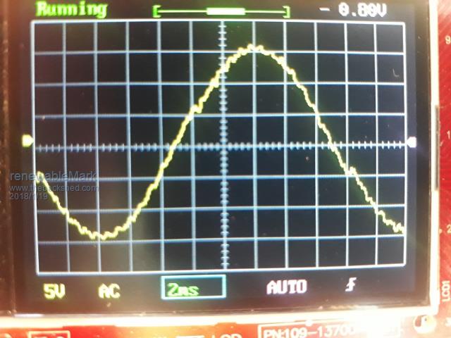

I got one of those cro assembled kits (CBF doing it myself) With the 10x probe The 240v sine doesn't fit on the screen, is there some setting I'm not adjusting right?

Posted: 12:18pm 18 Jan 2018
  renewableMark said   I got one of those cro assembled kits (CBF doing it myself) With the 10x probe The 240v sine doesn't fit on the screen, is there some setting I'm not adjusting right?
The switches on the right side:
Set SEN1 to 1V
Set SEN2 to x5
This should give you 5V/division with a x1 probe.
With a x10 probe that goes up to 50V/ division.
This should fit the 240V AC wave on your screen. You did set it to AC at the CPL switch?
What I also made is a little plastic box with a short 240V lead & plug coming out. On the other side is a BNC socket. Inside is a 10:1 resistor divider between those two.
Use the bigger 1W resistors if you make one, as the smaller resistors are not rated for a high voltage.
This little gadget lets me plug in the probe directly in the inverter's GPO without messing with life wires.
It also gives me another 10:1 reduction in addition to the oscilloscope 10:1 probe.
With this I can select a good screen fit wave form by also using the SEN2 switch.
I do hope I have not confused you .

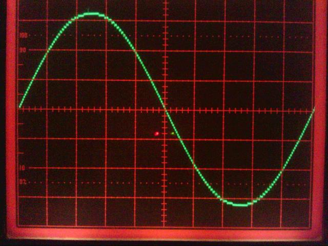

Posted: 09:08pm 18 Jan 2018
Here's mine.
What it looks like on a real oscilloscope with just a 100:1 probe poked into a power point and the ground coming through the earthing of the oscilloscope frame.
There are 81 steps peak to peak, and this is the direct unfiltered output from the inverter.
I can run the house either off the inverter, or off any of the three phases.

Thanks guys I worked it out.
Looks like the 2800w giandel PS inverter isn't so pure.
Would using this on household stuff root them?
Cheers Caveman Mark
Off grid eastern Melb
Madness
Joined: 08/10/2011
Posts: 2498
Posted: 04:55am 19 Jan 2018
My old Trace inverter looked like that, never caused any problem. I would be careful with the ride on dishwasher though.
