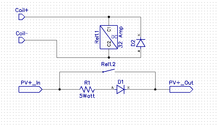

  shallowal said   what about back to back FET's. ie tie sources together and Gates together then drain of one connects to the panels and drain of the other connects to the battery.
Valid, but the issue with that topology is that a separate supply with a floating ground is needed. SolarMike and Warp put me wise on that in the thread MinimuMPPT.
I guess the way to go along the KISS philosophy for this machine, Schottky diodes maybe the best solution. Nick has already tested it. However it shall require reworking the board which can be minimized if these diodes are off-board and just have two thick wires going to their paralleled anodes and cathodes. High voltages may require an additional pair in series, but that aspect requires further examination.
Solution if you want to use reverse protection mosfet - just duplicate the TLP circuit already being used here and use it to bias the reverse protection mosfet. The ACS/LEM will tell the nano when to shut it down or switch it ON.

An external relay module would be the most reliable, something like this:
The contact rating being the determining factor, I have used these relays before and they seem reliable 80 amp , 60 amp .I would be a bit wary about the ratings of some relays on Aliexpress, but that manufacture seems to make quality stuff.
The resistor allows pre-charging of the electros to prevent the contacts burning up. CPU should turn off PWM so, so no current load prior to opening at night.
Mike your question about back feed current, not much... a 60 junction panel (24v) and 50v battery has say 3 series panels for mppt = approx 100v and 180 reverse PN junctions applied across the 50v battery, so their will be some 10's ma leakage, probably wont be noticeable on a large bank.

It's dark over here at this moment, so I went measuring.
I have 20 panels connected  (each 280W), they are with 2 in series and 10 groups in parallel, let's say 2p10s. They are consuming just not exactly 100mA @ 53V, I've measured with a clamp meter on the 2A setting.

Thanks Nicks and Mike, if I divide Nicks 100mA by the 10 parallel strings, I guess that's of the order of ~10+mA that Mike suggested.
This is a whole lot less than I was expecting, it appears that for an average say 3 strings in parallel ~ 1A is lost in ~3 days or ~ 50Wh for a 48V system.  It almost sounds like a non event to me. For a 1kWh storage 5% for 10kWh 0.5%. To put into perspective 0.5% is 1 hours use in 200 hours.
