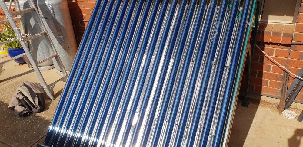

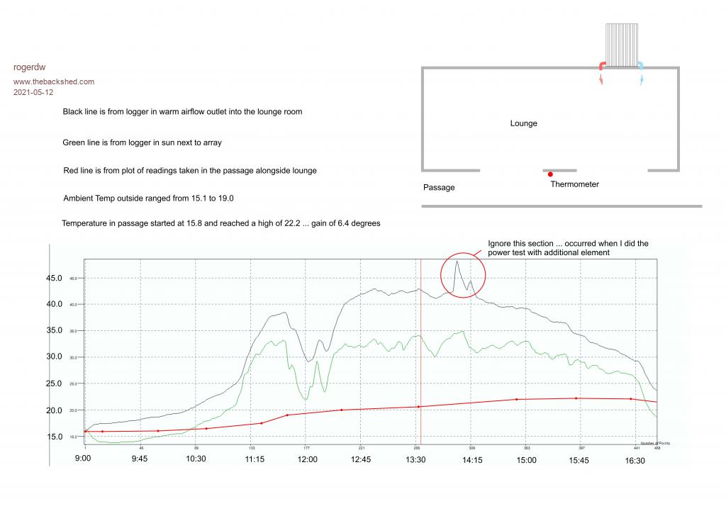

The results for today were also very encouraging.
Forecast was for a high of 18 and partly cloudy.
I swapped the fan to outside to reduce the noise and even re-used my 1970's duct tape.
I remembered to start both loggers together so the graphs match ... at 9:00am.
Was probably too early because the output wasn't that exciting, but worth doing to see what happens.
Looks like 4:30pm is the limit at the moment because by then the sun is behind the trees on the other side of the road and temperatures drop quickly.
I attempted a power test which I had to cut short  ...  but was exciting to see the result  ...  and I also did a comparative pv panel power test.
I'll detail that in the next post.
Here's a overview of the results.
Cheers,  Roger

That is quite a significant rise.

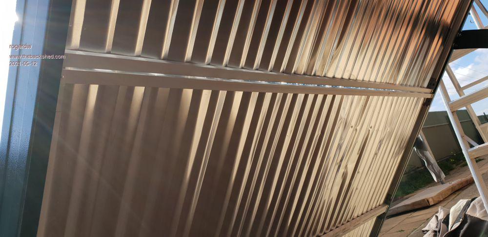

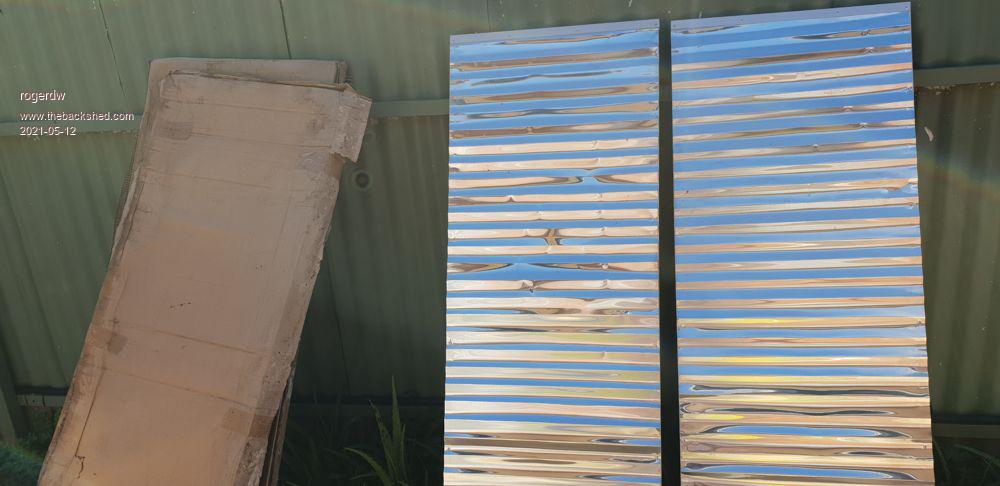

...  and I also forgot to mention that I dragged out the reflectors that came with the tubes and fitted them to my stand  ...  around 11:30 this morning.
Looks like they've had a bit of a rough life, but still reasonably shiny.
I'll have to wait for a clear unchanging period and remove them temporarily to see what happens to the figures. And also keep my eyes open for some large mirrors.
Tony, you asked about doing a comparative power test with a normal pv panel.
As mentioned previously, the evac tube array is 1,415mm wide and my 250 watt pv panels are close to a meter across  ...  so I need to allow for 2 pv panels as an equivalent.
Before and after the power test on the evac tube array, I checked the output of just one pv panel. I used a gutsy 5.62 ohm nichrome wire resistor across it and had a high of 28.51 volts.
That equates to 144.6 watts  ...  so for 2 panels equals 289.2 watts.

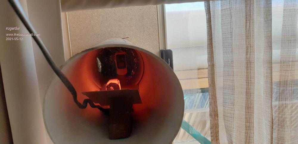

The other power test was a bit more exciting.
As before, I fitted an extension on the hot air outlet and slid my 1,200 watt hot air gun element up the spout.
The hot air outlet at that time was 40.7 degrees  ...  so I was aiming for 81.4
I wound up the variac and ended up at 240 volts  ...  and my temperature had just gone over 70 degrees  ...  but with the element glowing at full heat it was a bit too much for the plastic tube.
I shut it all down before it caught fire or worse  ..  then had to open up the doors for half an hour to get rid of the burning plastic smell. Luckily my wife saw the funny side of it.
I probably need to work out a better method of containing the heat from an element and combining with the air outlet if I want an exact power level  ...  but at this stage I am pretty confident to say that the system was putting out over 1,200 watts this afternoon.
If that is the case  ...  then this evac tube setup was outputting over four times the output of the pv setup.
Once again, it is looking really promising to build a double size system to mount on the roof. To potentially get 2,400+ watts for periods of time on a good day is very alluring. I do have plenty of tubes  ...  maybe it should be three sets wide  ...  54 tubes. Plenty of room up there.
I was starting to worry about my datalogger, so I didn't push it  ...  though the tube is a lot longer than it looks here.
Cheers,  Roger
I perceive there is still energy loss for the area with the reflector.  There is a highlight in the pic which is the sun bouncing back to the camera. If it's hitting the camera, it's not hitting the tubes. How much might be lost and if it's worth trying to recover is a different thing.
The other thing I wonder about is the mirror.  The reflector is angled so is always going to bounce the light to the side where it will ( mostly) hit a tube. A mirror  will tend to bounce back straight which at Midday and around, again reflect the light back out and not allow the tube to capture it.
I'm still of the mind that a 2 layer set up of tubes would be more efficient BUT, If you have the roof space ( Did you say you wanted that for PV or am I confused as usual? ) Then multiple single tubes would get more exposure and be more efficient still.
Can't help it but looking at the back of that reflector, I'm wondering how much heat could be gained from enclosing it and pumping air through?  You could paint one side black and compare the combined heat reflector output with the shiny reflector side when you turned it over.

  Quote  but with the element glowing at full heat it was a bit too much for the plastic tube.
Pretty sure they shouldn't be glowing that bright. I would suggest you consider turning the air up next time which will lower the temp you have to reach and cool the gun element as well.
  Quote  I probably need to work out a better method of containing the heat from an element and combining with the air outlet if I want an exact power level
Thinking about this, if you had a T piece in the output of the tubes, you could put an intact heat gun in there as long as it was relatively sealed so as not to induce cold air and measure the power that way.

  Warpspeed said  That is quite a significant rise.
Yeah thanks, I was really encouraged.

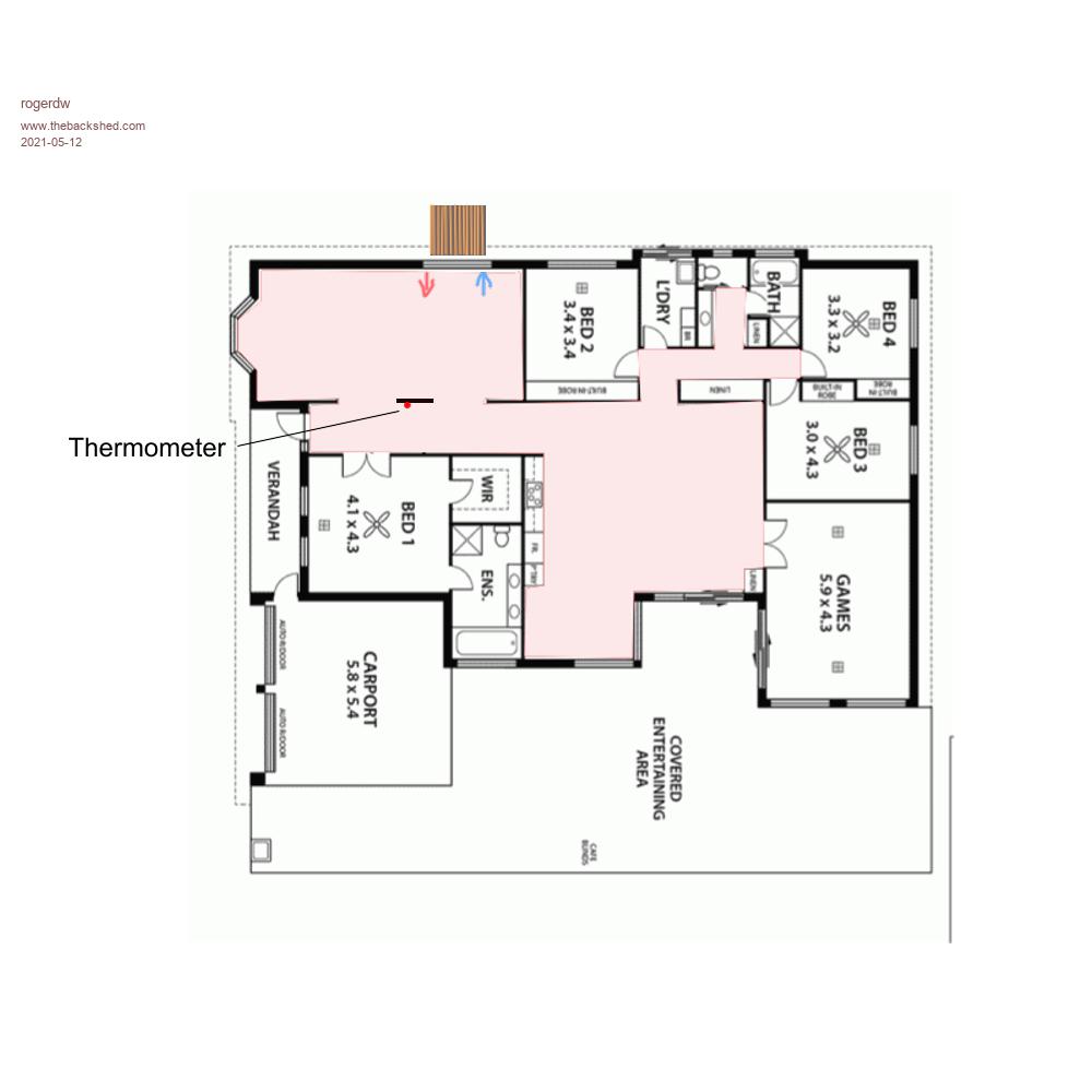

I think what makes it even more impressive is the full picture  ...
If you see the shaded section  ...  that is all open to the lounge room and we can't close it off. And today, even the main bedroom was open, so there was a lot of space soaking up all that heat.
  Warpspeed said  Whatever the actual final figures turn out to be, it certainly seems beat photovoltaic panels very easily. And if the blower was running all the time, those temperature rises are quite amazing.
Should be even more impressive in a clear blue sky, all very encouraging indeed.
If that style of blower turns out to be objectionably noisy, there may be some quieter alternatives.
Yes again, there is no doubt there's a big difference between the two. Admittedly today was a pretty nice day  ...  a lot better than the last week probably.
I purposely ran the fan all day because if it's off, the temperature builds up in the tubes and when you start the fan the temperature rise for the first 5 minutes can be really impressive  ...  but not sustainable.
This way I can see fairly smartly when the energy level is being depleted  ...  and I guess that would be the time to slow down the fan or stop it altogether if the output temperature gets too low.
With the fan outside, the noise level is quite okay  ...  though if we end up with a variable speed system, I can't see noise being a problem at all.
As Dave suggested, having the fan inline with the duct in the ceiling should be quieter again. Some careful mounting should keep it super quiet.

  Davo99 said  I perceive there is still energy loss for the area with the reflector.  There is a highlight in the pic which is the sun bouncing back to the camera. If it's hitting the camera, it's not hitting the tubes. How much might be lost and if it's worth trying to recover is a different thing.
I have to admit I hadn't given reflectors a lot of thought  ...  it was only the prompting from you guys that reminded me I had those reflectors  ...  and seeing the sun shining nicely for a change helped me decide to drag them out.
I've seen research papers on tubes with reflectors  ...  but all the stuff I've seen was only using one tube  ...  so their reflector was a great wide trough perhaps 12 inches wide or more. It didn't seem to fit when using 18 or 36 tubes.
I'm surprised that these reflectors seem shaped quite well really, being little troughs and not just like corrugated iron  ...  though a fair bit of them has been bent out of shape somewhat.
  Quote  The other thing I wonder about is the mirror.  The reflector is angled so is always going to bounce the light to the side where it will ( mostly) hit a tube. A mirror  will tend to bounce back straight which at Midday and around, again reflect the light back out and not allow the tube to capture it.
That had crossed my mind too  ...  but will be hard to prove. The only one constant I can't control needs to be constant to make a definitive comparison  ...  though I suppose I could set up a test with a couple of each perhaps.
Having said that, the sun seems to be overhead for such a short time, I wonder how much difference it will make.
  Quote  I'm still of the mind that a 2 layer set up of tubes would be more efficient BUT, If you have the roof space ( Did you say you wanted that for PV or am I confused as usual? ) Then multiple single tubes would get more exposure and be more efficient still.
I can fit about 12 meters of tubes up there  ...  3 sets would only take up 4 and a half meters.
Any pv I fit will go on the shed roof  ...  there's room for about 40 panels on the north facing roof  ...  with perhaps an additional 10 or so if I put them on landscape, so I wasn't especially worried about saving the house roof for pv.
  Quote  Can't help it but looking at the back of that reflector, I'm wondering how much heat could be gained from enclosing it and pumping air through?  You could paint one side black and compare the combined heat reflector output with the shiny reflector side when you turned it over.
Not sure about that, hadn't given it any thought really. The only thing I can comment about was that while it was sunny this afternoon and they'd been out there for hours  ...  I was actually shocked that the shiny stuff felt cold. I thought they'd be warm. Even the front side was cold. How does that work.
I even gunned them to see and they measured 25 in some spots  ...  but they didn't feel anywhere near that warm. I must have more of a look (and feel) tomorrow.
  Quote  Not that it matters, the margin is too wide anyway but you are more looking at something around 200W because you allowed 2M of PV and under 1.5 of tubes. Even with a 25% advantage, the PV lost badly!
I was feeling pretty confident so I gave it a head start.
  Quote  Pretty sure they shouldn't be glowing that bright. I would suggest you consider turning the air up next time which will lower the temp you have to reach and cool the gun element as well.
Yes, definitely needed more air. I need to find a fan heater one that is physically bigger  ...  and funnel the air through it well. Like tony suggested at the start.
  Quote  No doubt though, this is an excellent outcome. The only reservation I can see will come in about 5 weeks or so when we hit winter solstice.  Shortest day of the year so although the input power may not change a lot, the time available will.
Yes, understood. That's why I keep thinking more tubes  ...  just like you and pv I suppose.
I had been encouraged by results even on miserable days, and todays results may be as good as I'm ever going to get  ...  but still confident it's worth pursuing.
  Quote  Well done in any case. The world needs more people to get off their arses and try this stuff. We have all learned a lot though your efforts and I thank you for the knowledge I have gained with these things already through your time and hard work.
Thanks Dave, that means a lot ot me. And I appreciate your support and questions and input. Helps me to think through why I believe what I do and what things to try to prove the results one way or the other.
And thanks to you too Tony. Always lots of good questions when you can see I don't know what I'm talking about or haven't thought something through.

  Quote   I was actually shocked that the shiny stuff felt cold. I thought they'd be warm. Even the front side was cold. How does that work.
Very well it seems!
If it's sitting at 25 I would not think there was anything worthwhile to be gained there.  I was wondering if you were going to enclose the tubes but have my doubts on whether that would be worth while either. Do they leave them bare normally or enclose them for protection?
  Quote   Yes, understood. That's why I keep thinking more tubes  ...  just like you and pv I suppose.
Aw geez mate, Don't loose your mind like I have! You will end up with a yard full of Tubes like I have panels.  I'm actually getting sick of the sight of the things myself.  They sneak up on you.
First you are after all you can get for your own use. Then you get to learning where to get them and when you are all set up, the things keep appearing so you grab them to sell. Then you find better ones so get them to replace what you have and sell the old ones. Then as time passes the newer and better ones keep coming along so you grab them and before you know it, the things are piled up everywhere!!
No, one more final Re do then that's it. Spent more time on the roof than any sane person should with these things.
  Quote   I had been encouraged by results even on miserable days, and today's results may be as good as I'm ever going to get  ...  but still confident it's worth pursuing.
I think if you do the tubes and the panels you will be significantly energy self sufficient and lower your power bill a lot.  That's always worth pursuing!
  Quote   I think when this is all finished and I've got my Warpinverter going  ...  I might open a kebab shop.

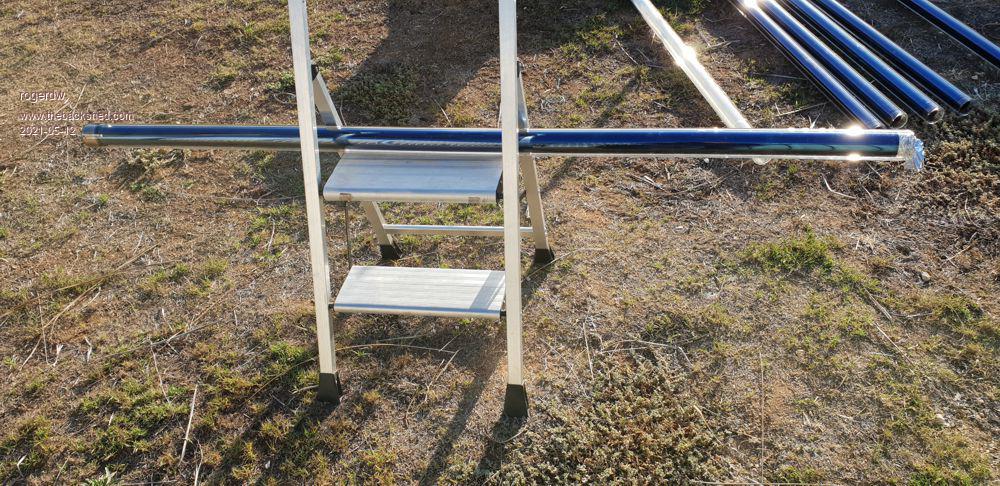

  Quote   Do they leave them bare normally or enclose them for protection?
Yes, totally out in the open. The bottom of the tubes have the nipple where they are evacuated and then welded closed  ...  and they sit in a plastic or rubber cup to protect from breaking that and letting the air in. The other end plugs into a manifold of some kind but the rest of the tube is out in the elements.
You'd think that hailstones would be a problem, but some of the testing claims are pretty remarkable. The glass must be stong!

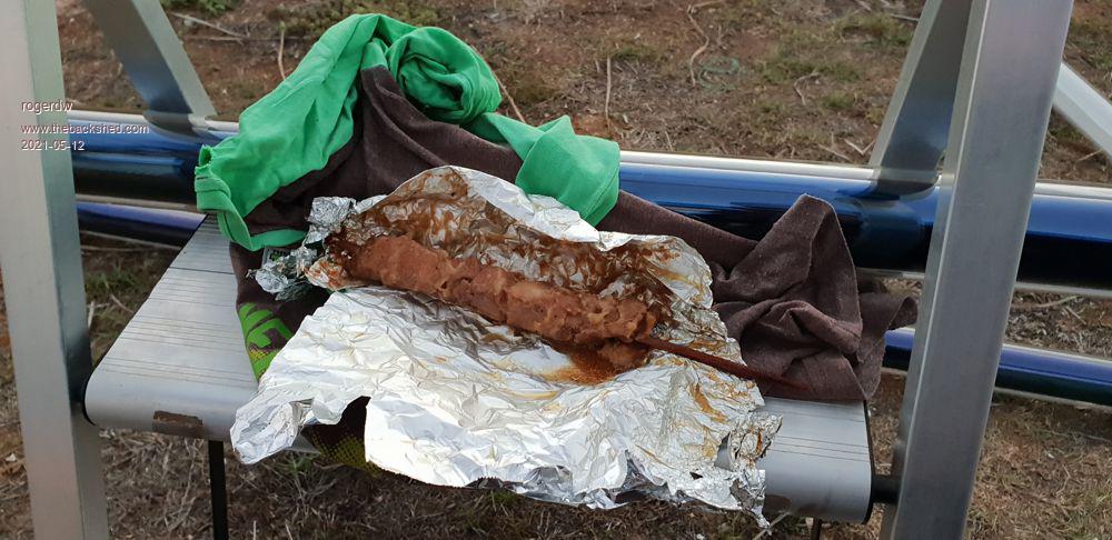

  Quote  That's a pretty cool party Trick! I'd get some tubes just for that.
Be exactly the sort of thing family and friends would expect from me.  :0(
Haha, I've been thinking of doing it for ages. I can see a string of sausages being slid down in there  ...  put a bung in the end to retain the heat  ...  and occasionally rotate the tube to roll them around.
Bit hard to wash out the tubes, so maybe just wrap the food in alfoil and job done.
