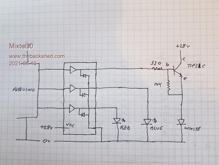

I can understand Bob's desire to use up the stock on hand but I am fashioned enough to reach for a TIP127 PNP Darlington.
Current price around $1AU and add 50c for the NPN driver transistor and a couple of resistors...
Posts: 8981
Posted: 08:08am 10 Aug 2021
Plenty of drive current (>50mA even with 3x 100mA leds lit) available from a UDN chip, Jim.
You only need a gain of 18 at most so a darlington is probably overkill. There may not even be 3 LEDs, only 2 (red/blue). A TIP32C should do it easily at less than half the cost. No driver transistor, just the UDN chip, 2 resistors and a TIP32C. That's all that's needed for a 900mA white and up to 3 100mA colours. All logic inputs into the UDN. All continuously rated. Will probably work with PWM too, if the frequency is kept down to something sensible.

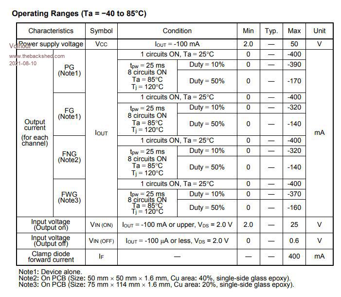

It appears that the UDN chip is no longer manufactured and is no longer listed by RS and Farnell. However, Toshiba have released the TBD62783A which is an excellent DMOS replacement with lower power dissipation. RS sell the through-hole DIP (PG) version for 8.65 UKP +vat for a pack of 10. You can get the TIP32C for 49p each. Ignoring postage, that's less than 2 quid +pcb for a complete driver package.

Posts: 5999
Posted: 09:11am 10 Aug 2021
Nice chip:  TBD62783A
At 50% duty cycle it can handle 170mA per channel (PG package, through hole).
So a single chip solution seems possible.
Use 1 channel for each of the 100mA colors
Use the remaining channels parallel for the white channel (you can parallel mosfets).
Bob, this is it....
Posts: 8981
Posted: 09:31am 10 Aug 2021
OOPS! My idea of driving a PNP from that chip doesn't work as I'd originally intended, sorry. It should be an NPN as an emitter follower. I'd forgotten that it's a high-side driver. I failed...  :(
The turn-off resistor should be to the emitter of course (top end of load should be ok. Output leakage is very low and won't light the LED). Base resistor could be about 330R.  It just gives some protection to the chip output. Turn-off resistor, say, 10k. Luckily a TIP32C (NPN) is about the same price. :)
You still have  maximum total input current into the supply pin. You can't get 500mA from all 8 outputs at the same time, even if you could stay within the package power rating. They don't state that maximum current, but 500mA total would make sense for a single pin on a DIP package. Note that they show 400mA max output with one circuit ON.
I don't think you can get 900mA *continuous* through the pin under any circumstances (not without sub-zero chilling anyway :) ). You may be able to get 900mA *short pulses*, but that's not what's wanted.
Inputs are dead easy. Direct connection to the arduino pins. :)

I guess that this is down to interpretation and I can't find where I once read that it's recommended to push no more than 2A @24v total at any time. This was when I was looking for something to allow me to PWM solenoid coils but I ended up going with the LMD18200 instead.
Posts: 8981
Posted: 01:24pm 10 Aug 2021
The trouble is, "limited only by package power dissipation" is *very* vague. It's also only correct for a narrow range of "correct". A 100A surge current will prove that, even if it's only for a ns. The chip bonding wire on the positive supply pin is an excellent fuse. :)
Assuming a single driver drop of 2v (within spec at anything over 100mA) a 500mA continuous load would already be 1W dissipation. Most through hole DIP packages aren't at all happy beyond about 1.5W.
That Micrel MIC2981 is the worst so far for giving useful info. It doesn't even give the maximum package dissipation, never mind the maximum current into the Vs pin. :(
EDIT:
If the white LED incorporates its own current limiting, which I assume it does if it is supposed t work from a constant voltage, then any attempt to dim it is likely to fail.
EDIT EDIT:
I went back to the original UDN2981 data sheet. The package seems to be rated at 2.25W maximum. Any pushing of that will definitely require a heatsink on the chip. Vce is a nominal 2v for each channel. Maximum current through a single output is 500mA. Splitting the 900mA load across 3 outputs would give 1.8W total dissipation. With a further 0.2W dissipation for two other channels driving 100mA LEDs that's a total of 2.2W with all the LEDs on. In theory it *may* be possible to drive all the LEDs from a single chip, but the DMOS version will run cooler. The supply current would be 1.1A though and I can't find any data sheet confirmation that the source pin would be capable of this. These dissipation figures are based on Vce being 2v. It's likely to be slightly less (1.8v at 350mA and 1.6v at 100mA typ).
