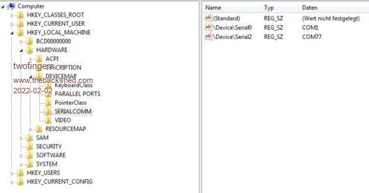

Now I use the registry.
   count = Registry::CountSubValues(#HKEY_LOCAL_MACHINE, "HARDWARE\DEVICEMAP\SERIALCOMM")
   For n = 0 To count - 1
     pName = Registry::ListSubValue(#HKEY_LOCAL_MACHINE, "HARDWARE\DEVICEMAP\SERIALCOMM", n)
     Port =Registry::ReadValue(#HKEY_LOCAL_MACHINE, "HARDWARE\DEVICEMAP\SERIALCOMM", pName)
     ;Debug pName+" ,  "+Port
     AddElement(myPorts())
     myPorts() = Port
     found = found + 1
   Next n
I can provide the registry details in more detail (in PureBasic) if required.

Joined: 02/06/2014
Posts: 1769
Posted: 10:38pm 01 Feb 2022
  Chopperp said  ... Yes please Peter. That should be enough
Why?

Posts: 6604
Posted: 11:09pm 01 Feb 2022
Brian
As Twofingers has shown, the com port number can grow (especially when you have devices with serial numbers).
I started with checking a maximum of 32 to save time but users complained.
The registry method has no such limitations, but it can get antivirus crapware to get alarmed.
