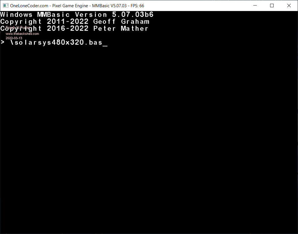

When I try to start a program with the name "solarsys480x320.bas" with
MMBASIC 0 "solarsys480x320.bas"
, only follwing happens:
That's all - nothing else happens...
This program is in the same folder as MMBasic.exe "\Documents\MMBASIC"
Frank
Posts: 3417
Posted: 03:36am 13 Mar 2022
The output screen shows that MMBasic is looking in the root directory for the program and not finding it. To test this put a copy of it in "\" or include the path in the command.
MMBASIC 0 "\Documents\MMBASIC\solarsys480x320.bas"

Frank N. Furter
Joined: 28/05/2012
Posts: 1156
Posted: 07:35pm 13 Mar 2022
@Phill99:
THANKS! This helps a little bit...
This is my business PC and there is a problem with the username - it is created there with a space in between.     This has the consequence that the paths are often not recognized correctly...
Let's see if I can't bend the path completely...
Frank

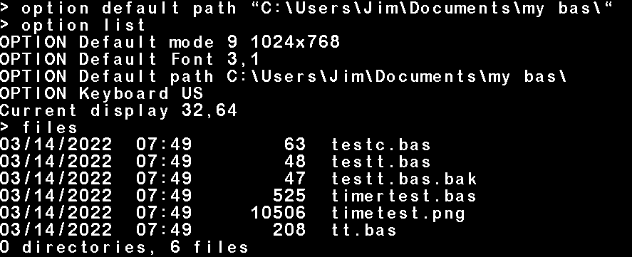

Posts: 6629
Posted: 08:49pm 13 Mar 2022
A space in the default path is not a problem.
Just start from "C:\" and enclose it in quotes when specifying.
Seems to work for me...
Edit:  If you have any Unicode characters in the path there could be problems.
Edited 2022-03-14 07:02 by TassyJim

Frank N. Furter
Joined: 28/05/2012
Posts: 1156
Posted: 07:58am 15 Mar 2022
@TassyJim:
It seems to be something different when the space is in the username...
Anyway - I moved everything to D: and adjusted path - now it works!
Frank
