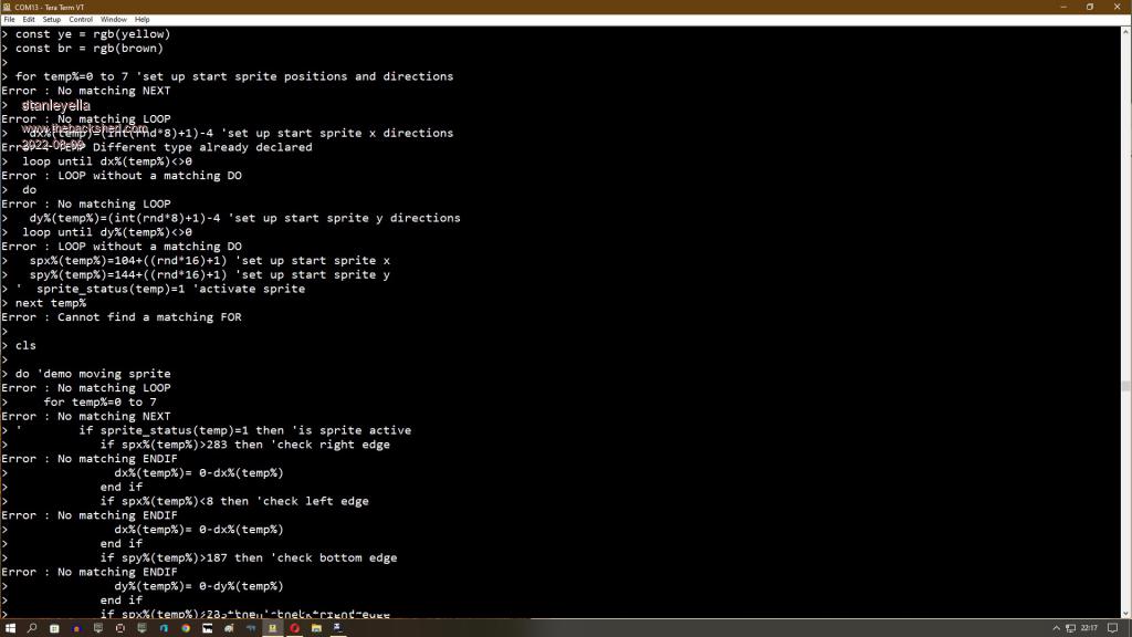

  stanleyella said  ... I read teraterm only copies 256 characters which is why files I've copied are corrupted with lines missing maybe.
Where "read"?
I can easily insert >256 characters in Teraterm (v 4.85). Shift-Insert.

  stanleyella said   I read teraterm only copies 256 characters which is why files I've copied are corrupted with lines missing maybe.
Teraterm can copy/paste large amounts of text. Maybe you are trying to paste directly into the MMBasic editor--that's where the restriction is.
For the third time (from me--also from others). In your PC editor, Ctrl-A, Ctrl-C (to copy all); switch to teraterm connected to your Picomite; press F10 (AUTOSAVE); right-click or Alt-V (to paste); when pasting is done, Ctrl-Z to save and return to the ">" prompt. Takes longer to write it out or read it than it does to do it.

teraterm copy/paste 256 characters only

  stanleyella said  teraterm copy/paste 256 characters only
sure?
This is what I just copied and pasted into Teraterm:

  twofingers said  This is what I just copied and pasted into Teraterm:
'a=&b0010111100101111001011110010111100101111001011110010111100101111
'a=&b0000000000000000000000000000000000000000000000000000000000101111
I tried pasting this and got about 12 lines worth before it went off the rails. I seem to recall that this issue came up before and there was a matter of setting some TeraTerm timing parameter. Do you, or does anyone, recall what this might have been?
That's amazing!
My transmit delay setup:
10msec/char and 500msec/line
Scroll buffer 50000 lines
The lone and ...
Posts: 3879
Posted: 05:13pm 08 Aug 2022
Thanks. 5 msec/char and 100 msec/line resulted in all 64 lines being pasted in.
(Now, how do I remember that the next time I paste on a laptop when those numbers haven't been set?)

  lizby said  Thanks. 5 msec/char and 100 msec/line resulted in all 64 lines being pasted in.
2 msec/char and 50 msec/line works for me too (230400 Baud).
I think the slow setup is from the old days of Micromites at 38400 Baud.
  lizby said  (Now, how do I remember that the next time I paste on a laptop when those numbers haven't been set?)
Put a "Post It" on your laptop?
The line delay is needed to give the 'mite time to process and save the line.
The size of the delay needed depends on the device. I found 100mS covers most devices. The baud rate also has some influence.
I have found that 0mS character delay and 100 mS line delay suits my collection of devices.

If I got 100 lines of code. please how to copy paste it,select all copy. then paste to teraterm and save run assuming teraterm is same com port as rpipico ie com 13.
copying to teraterm gives image
