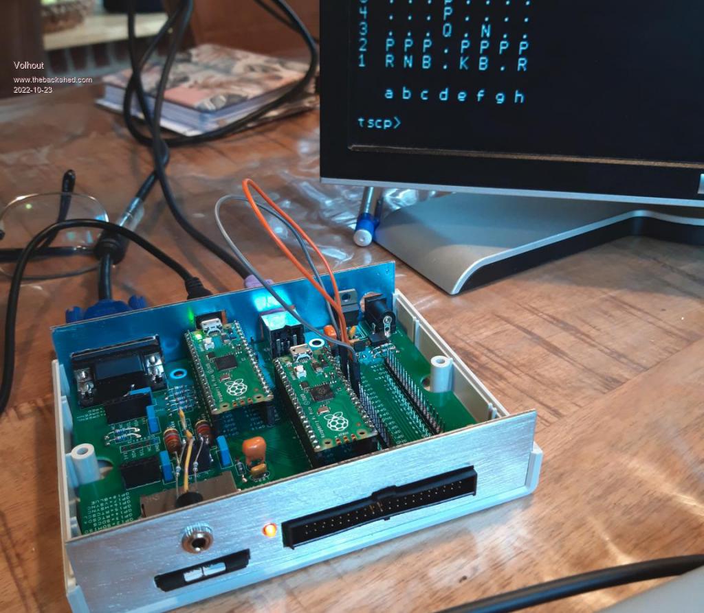

Hi Matthias,
I use a pico reference design from Peter that has 3 pico sockets.
pico
In essence you connect 5V (or Vsys), GND on both pico's. Then establish a UART link. Kevin uses GP0/GP1 on the mmbasic pico, I use GP4/GP5. The TSCP chess pico uses GP0/GP1 (and also console on USB).
Make sure you cross-wire... TX ro RX and RX to TX.
Success,

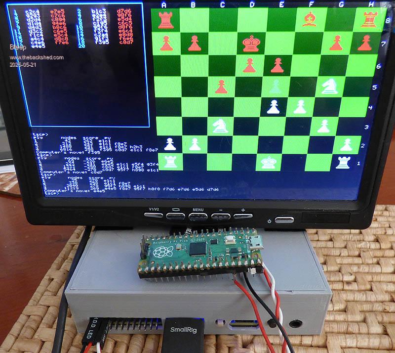

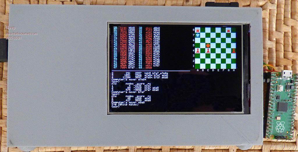

Posted: 03:45pm 20 May 2025
Hi Harm,
Ammendments as suggested by you in new zip below.
ChessClient.zip
Picutures for everyone else.
640x480 VGA on a HDMI screen.
480x320LCD.
Regards, Kevin.

Very nice but I wouldn't mix red and green because many have a problem with differentiating

Hi dddns,
These colors have always been this way, but I understand that colorblind people exactly have this problem. In stead of trying all different colors, some don't play well together,maybe a simple Black/white mode could be made through a command "color off". The sprites used are in essence black and white, only the tiles under them change them into colors.

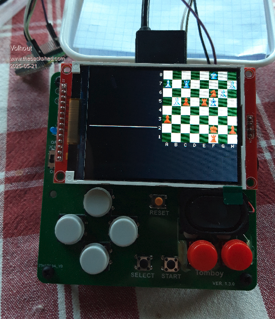

@kevin
The 320 LCD version does not show any moves, and prompt.
There is a board, it runs chess (auto) using the PC console.
When playing yourself, you also get no prompt on screen, now moves in the table.
When I read the code correctly it seems you are running the game completely in framebuffer, and you are copying to LCD. Maybe there is one too many FRAMEBUFFER COPY F,N..???
I guess for gameboy we need to talk to Tom to get the on screen keyboard implemented also.
P.S. the gameboy is running 5.09.00rc5. Should I change to 6.00.02 for any reason ?
I guess there is no change in BLIT as far as I know.
