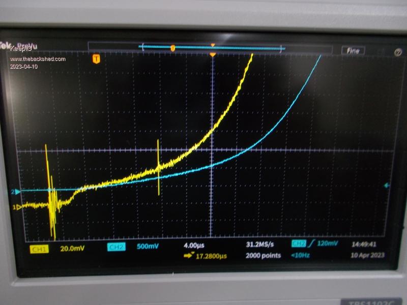

Posted: 06:36am 10 Apr 2023

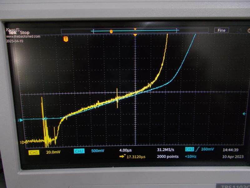

After learning more about the nature of the input currents of the inverter, I found an hour to finish a Modification I wanted to try, and it's getting back to the boring subject of Chokes.
I have a 2 Ferrite E-cores joined together and wanted to build a high current version with lower inductance and heavy cable. The idea was to run it series with a 3 core Toriod ring choke, Why?
As noticed by others builders, the saturation curve of the E-Core is quite wide and reasonably flat until the saturation point. The Toriod chokes have much higher Saturation but the curve is little steeper, further, the Ferrite E-Core seems to be better at choking some very sharp HF transients around the FETs.
I wanted to have the best of both worlds and have nice wide flattish saturation slope up to the Saturation point, which should be a little less abrupt. I think it was Poida who noticed less spikes around the FETs and a better looking drive signal with the E-Core compared to the same inductance value of Iron-Core choke.
The result of a gaped E-Core crammed with 5 turns of heavy cable was a 16uH choke that has a flat and gentle slope to around 220A. The smaller Toriod Core choke also starts to climb at around 200A. NOTE: The smaller 3 ring Toriod choke is 37uH.
The Combined inductance of both was 53uH, I would have liked the 37uH choke to be a bit less inductance but I will test it as is. The combined Saturation point is now around 400A and it's a nice curve.
This combined Choke is placed in the HI Freq side of the Inverter drive. A 600A choke is in the LO side to help the FETs when starting those really big 500A+ DC current peak loads .
The Mod really made no noticeable difference to the Inverter, all heavy loads start as normal, but at least I have that nice wide slope at higher saturation to boot, and maybe happier FETs.

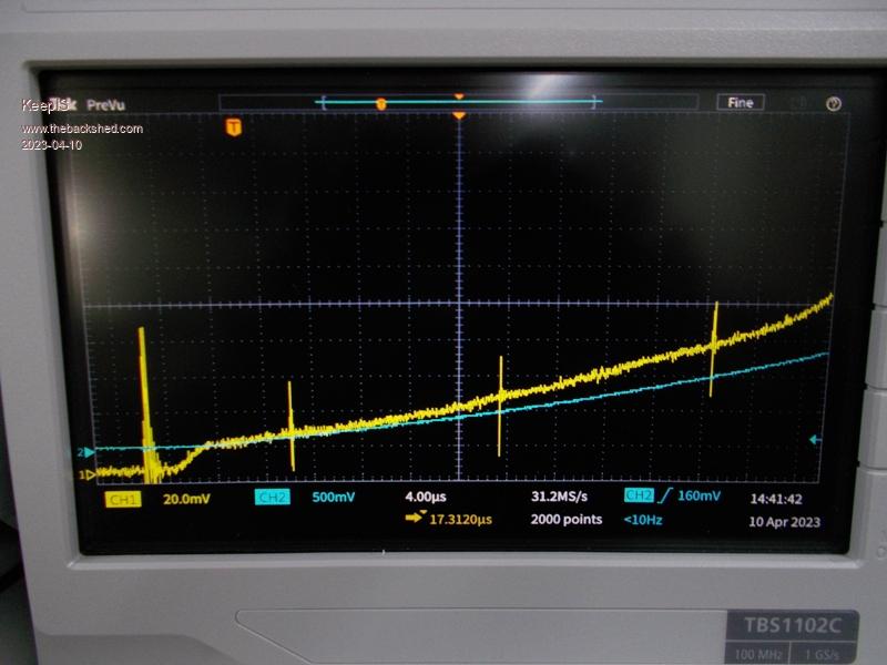

The Yellow Trace is voltage across the Resistive current Shunt: 20mV = 80A
The Blue is a Current Clamp: 500mV = 62.5A, so scales are slightly different.
This is the Smaller Toriod China Choke around 180A.
This is the Ferrite Choke @ around 210A:
Combined: The Blue trace continues climbing off screen and curves at the same value as the yellow, I wanted to keep the 3 photos at the same settings.
The voltage is over 110mv just off the edge of the screen before the it starts to really climb, that's over 400A, but keeping in the linear part @ 80mv it's 330A.
Edited 2023-04-10 16:41 by KeepIS

Hi, did you measure those spikes @no load? How high are they?
Capacitance of the inductor and transformer can also play a role.
Which "probing technique" do you use, it might effect the measurements.
I 'm finding this interesting, never thought those spikes were that high.
KeepIS
Joined: 13/10/2014
Posts: 2282
Posted: 08:26am 10 Apr 2023
Hi, the measurements were described a few posts back, and the reason for the High DC pulses every 10ms. I'm not sure what spikes you are referring to? If you mean the 500A+ Pulses (100Hz DC Sine wave pulses into the inverter) that is covered a few posts back. Obviously the Current changes with Load. Like all DC switching circuitry there is some noise spikes on the DC input, but these are in the 50 to a few hundred millivolt range depending on the Load. The AC supply is very clean.
There is no probe, just a DSO and various isolated low noise current clamps, the main one rated at 500A with good accuracy to 700A and usable to over 1000A.
I was also surprised at the peak currents, and questioned them when I found out my previous measurements at 390A were low and compromised by DC Clamp limitations, including a 400A commercial unit. I'm across building Toriod transformer, Chokes and the design and experimentation has fully tested all variations in this test inverter  along the way.

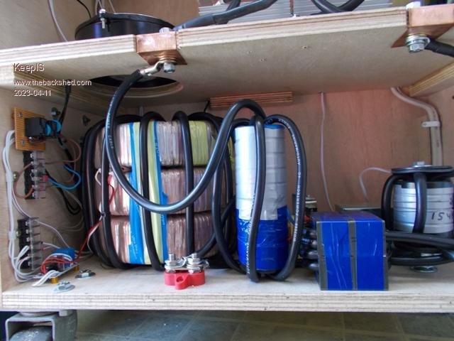

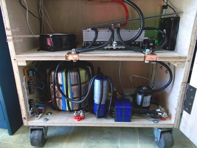

I changed the 37uH Chinese choke out for a 4 turn 3 Core toriod at 15uH. The combined Ferrite and 15uH Toriod choke is now 30uH which is much better from past testing, they have the same combined current rating and maintain that slower transition to saturation that I was after by virtue of the Ferrite E-Core in the HI side.

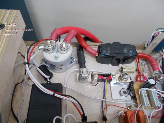

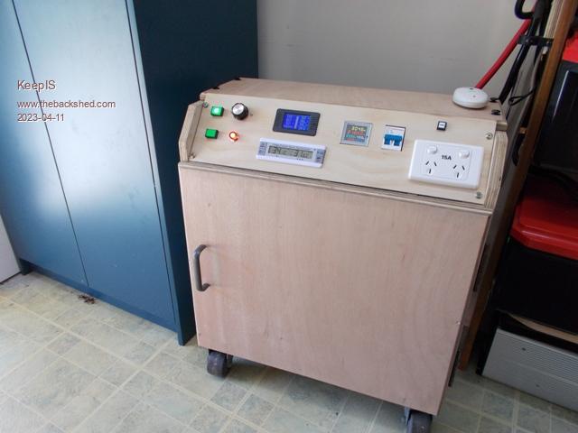

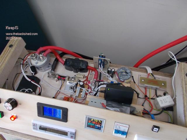

The Inverter:
The Cabinet door opened showing 15uH 3 stack toriod on the right in the lower part of the cabinet (I made this one nicely as I knew I would be keeping it. It's in series with the Ferrite E-Core on the HI side of the inverter drive.
The 4 turn 10 stack toriod on the left is 37uH with an almost linear saturation curve past 800A, but I still downgrade that to the straight part at 600A. It's in the LO side, it's there to help the FETs switching 525A peak currents from seeing a piece of wire caused by a saturated choke, instead, the FETs see an inductive resistance provided by this Choke. (I know it's not the correct term, but it might make the intention clearer to someone new reading it)
The Choke is not pretty, but I threw it together for a test and it worked perfectly so I left it there. I'm going to rewind it tightly like the 3 stack on the right and cover and mount the 10 cores correctly when the new inverter driver is built. A lot of tiding up of the Toriods and wiring to do also.
The Top lifts of the Cabinet for access to all interface connections.
On the Left rear is the High Current High Voltage Contactor for automatic cap charge and DC isolation when the inverter is in the off position, there is a 250A fuse, it takes time to open at continuous RMS currents, peak 500A pulses will not blow it.
There is no back on the interface connection shelf, it's left open, and when fished the AC section on the right will be enclosed. This makes it so easy to test things and check the unit during the build and long run in and testing process.
As it is now there is just one 3 position knob, Off (and DC isolated as well), ON (Standby) and RUN (Inverter AC Running). Never have to worry about switching the battery banks off or reconnecting. Absolutely fool proof, sounds like it's made for me (I'm getting old)
Edited 2023-04-11 18:08 by KeepIS
Great looking system.  That's a lot of chokes.  The term you are looking for is "reactance".
KeepIS
Joined: 13/10/2014
Posts: 2282
Posted: 02:17am 12 Apr 2023
Thanks, I know the correct term, but someone new to electronic may not understand reactance in this context, which is why I went to the trouble of pointing that out and use the (technically incorrect) term inductive resistance, to differentiate from a saturated choke with only the resistance of the winding wire left in circuit.
It's actually only two chokes. One a 31uH hybrid of Ferrite and Silicon iron, and the other a big non saturating 37uH choke in the low side, my extensive testing proved this made a big difference to this "Toriod" in the inverter under difficult complex loads. This inverter is for all intentional purposes, Silent, even when running at 5kW for an hour. The only thing that gets a very slight Hum from it is the Half cycle load from the Heat Gun on LO setting (diode in series with the AC element on LO).
The simple idea of using a Toriod Ring choke in series with a Ferrite E-Core had never dawned on me before. I really liked the Ferrite E-Core choke in the early testing phase but the low saturation point was a disappointment, now I have the best features of both in this hybrid design.
BTW the Toriod transformer is around 190mm high X 190mm wide, 210 X 210 if you include the primary winding. Looks smaller because of depth of field.
Edited 2023-04-12 13:56 by KeepIS
