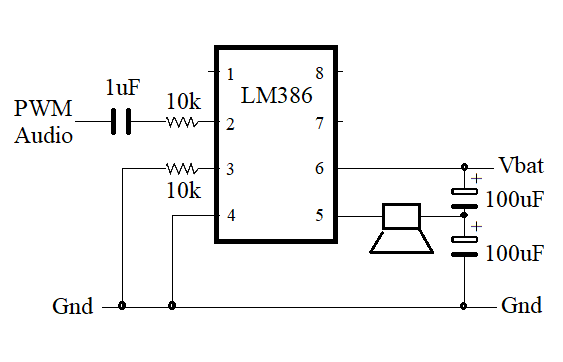

As I only have one chip the speaker is going to ground via a 220uF cap. and is moderately loud. A baffle really makes a difference.
Edit. Further testing.
A capacitor in series with the input reduces distortion.
With a single chip noise is reduced a little if the speaker goes to the junction of two capacitors connected between V+ and Gnd. Might help with other amplifiers too.
Component values not critical.
Pins 2 & 3 are inverting and non-inverting inputs so for bridged output the POKE trick isn't needed, just swap pins 2 & 3 on the second chip. As the PWM phase of L & R are the same both inputs could go to the same pico pin.
chip 1
PWM L to 1uF to 10k to pin 3
Gnd to 10k to pin 2
Vbat to pin 6
Gnd to pin 4
Speaker+ to pin 5
chip 2
PWM R to 1uF to 10k to pin 2
Gnd to 10k to pin 3
Vbat to pin 6
Gnd to pin 4
Speaker- to pin 5

@phil99
You are aware you are immensly overdriving the LM386 input ?
Maybe this is allowed (the input transistor may act as a diode clamp) but it feels dangerous.
Posts: 3325
Posted: 08:21am 03 Apr 2023
Yes, deliberately overdriving it to prevent linear operation.
The idea is to clip the input to remove much of the noise and ensure maximum p-p PWM output.
Previously I was overdriving it too much but now the LM386 chip I have sounds good with a small speaker.

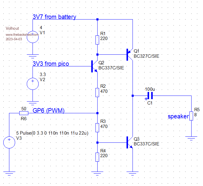

In case you are looking for a half-bridge with discrete components, my simulation say this would work.
The speaker might need a low pass filter (an inductor, maybe capacitor) and a volume potmeter. But this power stage will give you rail-to-rail output with a 3.7V...4.2V battery voltage, and because isolates the 3.3V switchmode ripple, will give you a clean output (as long as the battery voltage is clean). Q1 and Q3 need to be medium power transistors with relatively high gain, such as the BC327/BC337. Q2 can be a standard BC547/BC548 or alike.
Resistor values must be as indicated (R3/R2 = 2 x R4/R1) to minimize crossover (current peaks from battery).

@Volhout: I like the discrete parts only "transistor circuit", what's the "5 Pulse" malarkey on the V3/signal-source ? I'm guessing it is the input to some sort of circuit simulator package ?
@Volhout: In your "diode clipper circuit"
   - Do I still want a 2.2uF cap between the volume/pot and the PAM8403 input, I noticed I have one "left over" on my breadboard from a previous iteration ?
   - Likewise the 2.2R in series on the PAM8403 VDD ? What is/was that for by the way, to my ignorant mind 2.2R is just a bad piece of wire ;-)
Posts: 3325
Posted: 01:09pm 03 Apr 2023
" What inductor are you recommending for the "LM386 circuit" ?"
For testing purposes just leave it out. The voice coil inductance of mine was enough with the PWM frequency at 132.3kHz - beta 33 CPU speed 378MHz.
If the no signal PWM AC current through the speaker is less than say 50mA then that will do.
If you do add one its DC resistance needs to be much lower than the speaker resistance as it will be reducing the volume. 100uH to 470uH should be enough.

Posted: 01:58pm 03 Apr 2023
1/
The circles at the left side of the schematics are simulator models of battery(4V), switchmode power supply(3V3) and PWM output (44kHz). These are just wires you connect to the succesive circuits.
2/ My PAM8403 module has a potmeter and capacitor between potmeter and PAM8403 chip. This makes me believe you need a capacitor between potmeter and PAM8403 chip.
3/ In my bench test I did not have a 2.2R resitor between PAM8403 board and battery. Thus I cannot decide if improves. My circuit has a capacitor between Vdd and GND on the PAM, and I hard wired it to the battery (no resistor, not filter, not extra electrolytic capacitors, just wires to supply power).

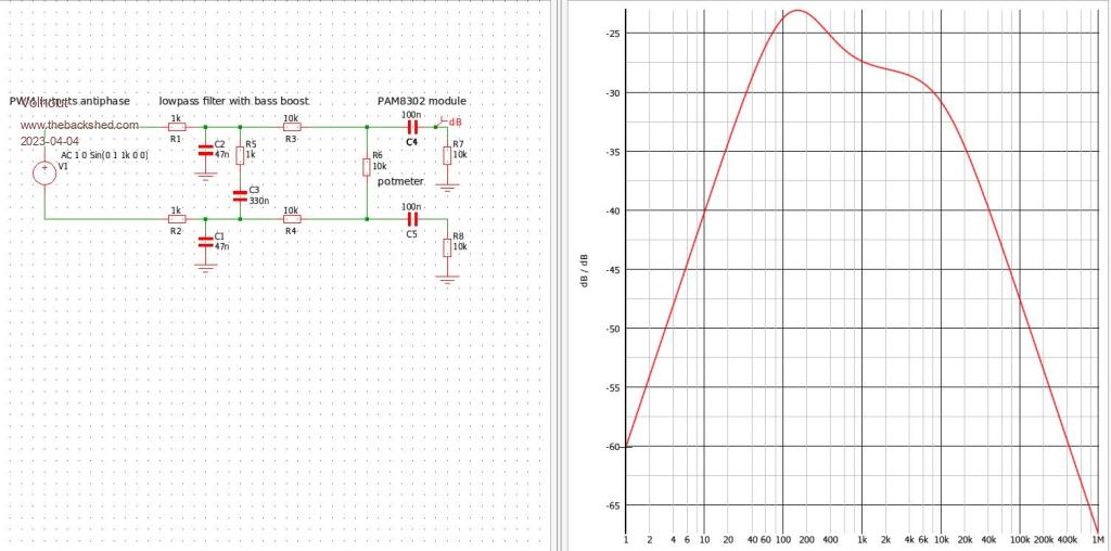

@mozzie,

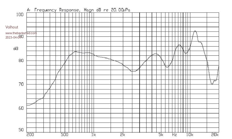

The small speakers Tom has, have terrible low frequency behaviour.
But since the PAM8302 can drive enough power, we could boost the rolloff a bit. Below is an example how this can be done. This is by no means perfect, but the 2 components (R5,C3) boost some 5 db.
The maximum is -23dB (@100Hz), with 24dB gain, the PAM8302 will bring this back to 0dB (2.8V accross the 8 ohm speaker = 0.6 watt).
