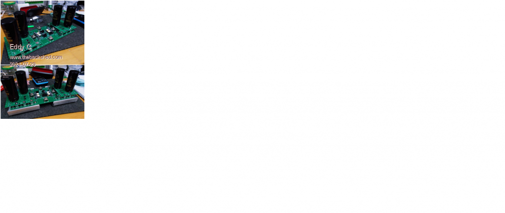

I actually wanted to ask a Question:-
1. With multiple power supplies incorporated into driving the Nano controller and inverter FET PCB, has anyone simulated individual voltage module failures in full flight for impact?
(note to self before forgetting; ordering next PCB’s from JLCPCB.com include/combine the parts order, HY5608W FET’s and wiseguy BOM list bits from LCSC.  PCB Bds + Parts Combined was free shipping in Feb24.)
2. The FET PCB  = 260mm x 108mm. The 2 x Capacitor boards appear to extend, overhang. What is the clearance length required for the FET PCB with Capacitor PCB's mounted?
My Oztules 5kw FET PCB is now ready to test with 4 x FET’s fitted. It's only 180mm long x 171mm wide + fans. I’m preparing a Ply sheet to screw a complete set of PCB’s on for testing. Ensuring leaving sufficient room for the wiseguy FET PCB with Caps mounted.

  Eddy C said  2. The FET PCB  = 260mm x 108mm. The 2 x Capacitor boards appear to extend, overhang. What is the clearance length required for the FET PCB with Capacitor PCB's mounted?
The capacitor boards do not overhang the Power PCB.  However if they are mounted with any screw slackness bias maybe ~0.25mm overhang might be possible. The delivered Capacitor PCBs would have an overhang if the excess area was not cut off.  The overhang part is meant to be removed (cut along the line) and then further cut down along the silk screen lines to form 20 little predrilled square insulators which can be used on top of the TO220 insulating bushes to further protect any screw/nut/spring washer damage to the bushes whilst also providing extra clearance.  If the largest diameter capacitors are used ~35mm then they overhand the edge of the CAP board to the outside by about 2mm.

Ensuring leaving room for your FET board noticed images KeepIS had posted would exceed the 260mm x 108mm.
I had read the insulator spaces were removable and would be using. (Well done, good foresight planning ahead)

KeepIS had special capacitor boards made for his build as he was using large screw mount capacitors. I was referring to the boards that would be supplied through me as part of the inverter project build that I presented here.

  Eddy C said   Ensuring leaving room for your FET board noticed images KeepIS had posted would exceed the 260mm x 108mm.
Hi, those pictures show capacitor test boards that have not had the insulator section cut off, and as Mike pointed out, these special Cap boards are a few mm wider and do overhang slightly even with the fiberglass insulator pads cut off.
On reflection, I should not have used 10,000uf caps, I think 4,700uf caps with 2 or 4 per board would be plenty of capacitance and cost a lot less.
But that's just my opinion after a lot of testing in my inverters.
