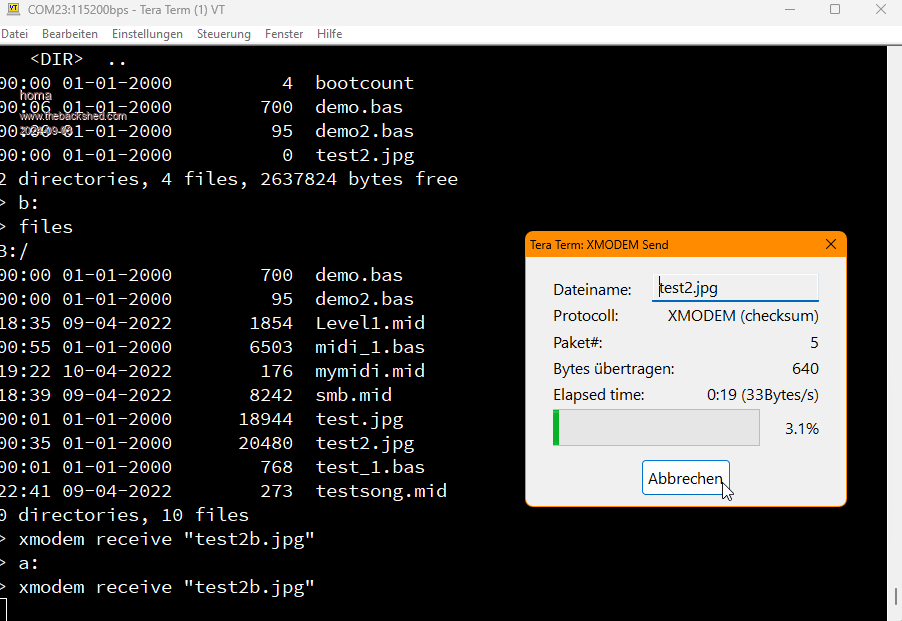

Personally, I would be in favor of the compromise, as I always expect the editor to have the right colors. But I can also live with the current state after the explanation (perhaps this should then be explained in the new manual).

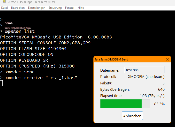

Can you say something about the XMODEM problem?

You don't say which version. Just transferred a 74Kbyte file on HDMI with no issues

  matherp said  You don't say which version. Just transferred a 74Kbyte file on HDMI with no issues
> option list
PicoMiteVGA MMBasic USB Edition  6.00.00b3
OPTION FLASH SIZE 4194304
OPTION COLOURCODE ON
OPTION KEYBOARD GR
OPTION CPUSPEED (KHz) 315000
> xmodem send
> xmodem receive "test_1.bas"
Error : Cancelled by remote

Please test it receiving to an sdcard rather than flash and also to memory - both should work. I think I know the problem but it may be non-soluble

you are right. sdcard works:
0 directories, 5 files
> option list
OPTION KEYBOARD GR
OPTION SDCARD GP5, GP6, GP7, GP4
> files
B:/
18:35 09-04-2022       1854  Level1.mid
00:55 01-01-2000       6503  midi_1.bas
19:22 10-04-2022        176  mymidi.mid
18:39 09-04-2022       8242  smb.mid
00:01 01-01-2000        768  test_1.bas
22:41 09-04-2022        273  testsong.mid
0 directories, 6 files
and memory too!
but i wanted to transfer an image, hence the flash.

Unfortunately no improvement, rather a deterioration, as the abort is not recognized by the Pico2. This was the case before, see above.

Posts: 11654
Posted: 09:55pm 02 Sep 2024
Definitely now works for me W11/Teraterm and didn't before
I've re-coded XMODEM so is polls the UART rather than using interrupts.
Still b3.
Please ensure you are updating to the below which I have just loaded and verified
PicoMiteHDMIUSB.zip

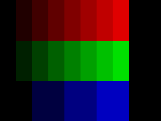

This is curious.  When I run this small program in mode 5, I see a brownish bar in the 4th Red Position, and no Dark green bar in the second Green position.  But when I save the image, It looks like the image is correct in Memory.  At first I thought it might be my monitor settings, but it looks the same on multiple monitors.
The saved image below looks like the correct mapping to RGB(332), but doesn't match the image on any of my HMDI monitors.  Could this be a bug in the translation from memory to the HSTX peripheral?
It's also interesting to run this program in the other modes to see how the RGB colors are mapped in each mode.

For X = 0 To 255
 For Y = 0 To 80
   Pixel X,Y,RGB(X,0,0)
 Next Y
Next X
For X = 0 To 255
 For Y = 81 To 160
   Pixel X,Y,RGB(0,X,0)
 Next Y
Next X
For X = 0 To 255
 For Y = 161 To 240
   Pixel X,Y,RGB(0,0,X)
 Next Y
Next X
Save Image "ColorBars.bmp"
