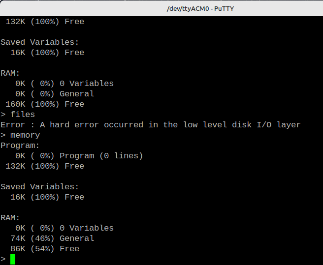

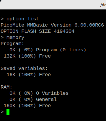

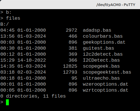

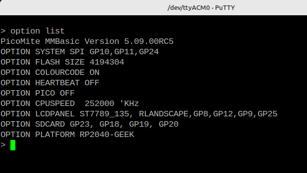

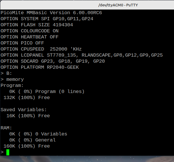

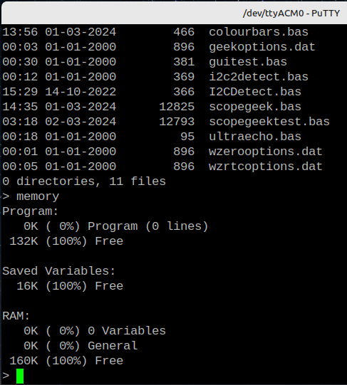

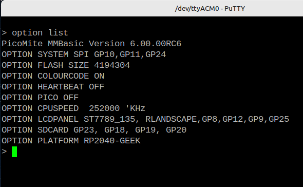

Hi All;
I have tried 6.0RC6 on a number of my PICO builds and have not had any problems except when I tried it out on the RP2040-Geek.
It worked properly on 5.9.0RC5 as in the screen shorts below;
Cleared with clear_flash.uf2, Loaded 6.0RC6 shown with memory command, this shows normal at first.
Executed Option Reset RP2040-Geek
Executed B:[ENTER], note memory still looks normal
After executing the FILES command I got a drive error and the memory usage changed.
It would not read any sd cards that could be read on other PICO's.
Reading the A: was not a problem.
After I reloaded 5.9.0RC5 I was able to read the same SDCard again.
I have done this exercise twice now with the same results.
If you need more information please ask.
Thanks,
Hans ...

This is the way MMBasic works. In all versions (just tested a MM2) the loop terminates with the loop counter at 1 greater than the test value.
  Quote  I have tried 6.0RC6 on a number of my PICO builds and have not had any problems except when I tried it out on the RP2040-Geek.
I have made a change that should have already been in there ( I thought it was). The SD card is bitbanged to initialise it as the SPI baudrate needed is less than that possible with H/W SPI. Once initialised you can up the baudrate. All cards are supposed to support 12Mbit SPI. Previously, by error, the firmware continued to use bitbanging after the rate change. The firmware now switches to SPI at 12Mbit. I've tested this on multiple boards and with different cards and it gives no problems. The fact that the RP2040-Geek doesn't work suggests they have something odd about their SDcard implementation or their wiring of the sdcard relative to the display. Sorry but I don't intend to revert unless there are other reports of issues.
Posts: 5995
Posted: 08:31am 11 Oct 2024
Hi Peter,
On the GEEK the SD card is SPI1 (GPIO18,19,20).
And SPI2 to the display is on GPIO10,11 is MOSI only (MISO is routed to GP24, that is NC).
So they are different SPI busses (unlike most ILI9341 alike systems).
Maybe that is part of the problem.
There is nothing odd in the GEEK circuit. See attached. Just pin-pin connections.
RP2040-GEEK-Schematic.zip
Hans: if this can't be fixed then stay at 5.09.00. At this moment there are no changes in 6.0.0 that are important for GEEK applications. This may be different in the future, but main focus at the moment is 2350 features, and GEEK is 2040.
But even if it is fixed, when SPI1 is in use for SD card now, you cannot use it anymore for GP2/GP3/GP4. For me(personally) that is what I use to experiment on with GEEK.
Edited 2024-10-11 18:57 by Volhout
Posts: 11653
Posted: 08:54am 11 Oct 2024
  Quote  On the GEEK the SD card is SPI1 (GPIO18,19,20).
Oh, I'd forgotten all about that - another special case needed
Try the attached
PicoMite (2).zip
Edited 2024-10-11 18:59 by matherp

  Quote  I assume, Peter, that when a SD card is used with an assortment of pins rather than on a hardware SPI port it will continue to be bitbanged at the lower speed as before? That would make sense.
Yes, of course. The issue was the stupid design of the geek which uses a different set of SPI pins for the display than for the sdcard

V6.00.00RC7
Restores correct audio buffer size
Should fix an issue when the SDcard is not on the same SPI channel as the system spi
PicoMiteRP2040V6.00.00RC7.zip

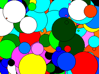

Martin: please run the following and stop it with ctrl-C. I see the normal command prompt and any subsequent typing with no issues
MODE 2
FRAMEBUFFER layer
FRAMEBUFFER layer top
FRAMEBUFFER write T
'Box i,MM.VRes\6*2,MM.HRes\4,MM.VRes\3,10,RGB(red),RGB(green)
FRAMEBUFFER write l
'Circle MM.HRes\2,MM.VRes\2,MM.HRes\4,10,1,RGB(blue),RGB(yellow)
'Text MM.HRes\2,MM.VRes\2,"MIDDLE",CM,,3,RGB(CYAN),-1
d=1
i=0
rr=0
x=Sin(Rad(0))*40
y=Cos(Rad(0))*40
FRAMEBUFFER write n
r = Rnd * 255
g = Rnd * 255
b = Rnd * 255
Circle Rnd * MM.HRes, Rnd * MM.VRes, Rnd * MM.HRes/7,,, 0, RGB(r,g,b)
Inc rr,3
xl=x
yl=y
x=Sin(Rad(rr))*40
y=-Cos(Rad(rr))*40
FRAMEBUFFER wait
FRAMEBUFFER write l
Circle MM.HRes\2+xl,MM.VRes\2+yl,MM.HRes\6,0,1,0,0
Circle MM.HRes\2+x,MM.VRes\2+y,MM.HRes\6,10,1,RGB(blue),RGB(yellow)
Text MM.HRes\2+x,MM.VRes\2+y,"MIDDLE",CM,,2,RGB(CYAN),-1
FRAMEBUFFER write t
Box i,MM.VRes\6*2,MM.HRes\4,MM.VRes\3,0,0,0
Inc i,d
Text i+MM.HRes/8,MM.VRes\2,"TOP",CM,,3,RGB(magenta),RGB(green)
If i>=MM.HRes/4*3 Then d=-1
If i=0 Then d=1
Edited 2024-10-12 03:41 by matherp

Thank you both!
Both the fix and RC7 work just fine on the Geek.
Hans ...
