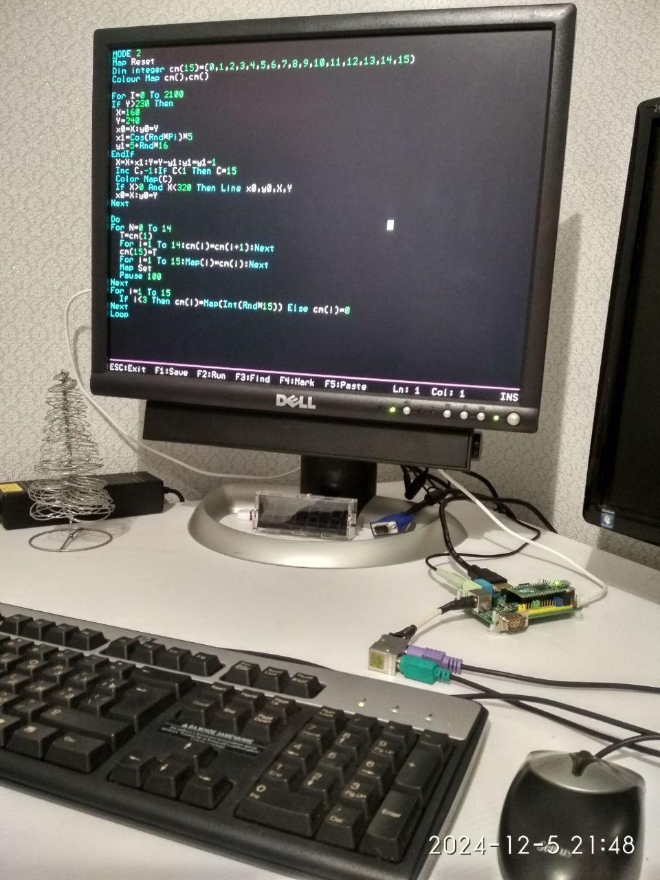

javavi
Joined: 01/10/2023
Location: Ukraine
Posts: 603
Posted: 07:58pm 05 Dec 2024
  matherp said  V6.00.01RC5 revisited
Fixes use of GP0 for PS2 mouse clock
Thank you for supporting PS/2 Mouse, now I have a full-fledged workstation on MMBASIC powered by the monitor. And when there is no electricity, and for us this happens every day on schedule, the monitor is powered by a battery inverter.
Edited 2024-12-06 06:01 by javavi
