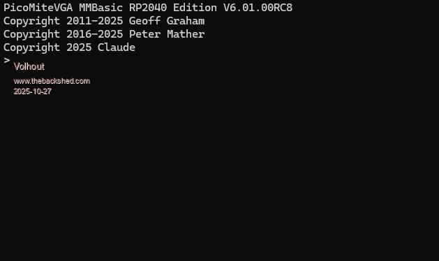

Posts: 6197
Posted: 03:30pm 27 Oct 2025
@Peter,
Above RC9, found the method to reproduce. Uses RP2040 VGA with PS2 keyboard attached.
- Install MMedit535 (geoff's website)
2025-10-21_195308_minifm_RC2.zip
Upload a program (I used this miniFM version) from MMedit to the pico (uses MMCC in AUTOSAVE N mode).
After the program has started on pico, close MMCC on the PC.
On the PS2 keyboard, press <CTRL>C, the F2 (start the miniFM again). You see part of screen build up, but it is halted...waiting...
In case you start any terminal program on the PC (i.e. putty/picocom) the miniFM continues. And it is fully functional from both PS2 and console.
P.S. I am not sure if this relates to MMedit 535, but it is the only one you can download now from Geoff's website. I first noticed it with MMedit 533. But it is essential that the program is uploaded. Until you repower the pico, this can be reproduced over and over. After a power cycle the relation between USB console and restarting is with control C and F2 disappears.
P.P.S. you need a program that outputs something to console. And miniFM outputs lots of data to console.

Posts: 6197
Posted: 03:52pm 27 Oct 2025
@Peter,
It is something MMCC related. I tried AUTOSAVE and AUTOSAVE N using Putty, and then the problem does not show. Only when using MMCC this happens. Maybe MMCC closes the screen, but not the underlaying USB endpoint. So pico keeps sending until the endpoint buffer in the PC is full. And then stops.
Once any client opens the endpoint again, data can flow.
We have to talk to Jim about this. Maybe this is "good old Linux"..?
Edited 2025-10-28 01:54 by Volhout
Posts: 12059
Posted: 03:54pm 27 Oct 2025
You can try this. If it doesn't work at all then MMCC isn't setting DTR
PicoMite.zip
Posts: 6197
Posted: 04:00pm 27 Oct 2025
3:54 version behaves the same. I can upload through MMCC, run the program.
After MMCC close, control-C and F2 begin, but halt until I open any terminal program on PC on USB com port..
