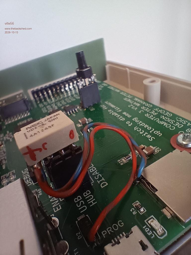

ville56
Joined: 08/06/2022
Location: Austria
Posts: 653
Posted: 07:53am 15 Oct 2026
I have implemented Micks idea of switching the USB HUB ENABLE/DISABLE with a relay. Works like a charm.
In the background my BOOT switch mod is also visible. It extends the boot switch through a hole in the top cover so ot can be easily reached. Both mods are on connectors, so they can be removed.
Flashing new firmware releases should now be possible with the case closed ....
73 de OE1HGA, Gerald
dddns
Joined: 20/09/2024
Posts: 924
Posted: 09:08am 15 Oct 2026
A nice and practical mod!
Picocalc uses an electronic component instead of a relay. A part made in China that I couldn't find in Europe. I think JLC had it, though. Maybe someone knows of an equivalent from a European manufacturer.
Posts: 9273
Posted: 10:03am 15 Oct 2026
I love "boot switch tower"! :)
I now have a few "genuine Omrom" G6K-2F SMD relays that I intend to use for this on Elemento 2. They are *tiny* for DPDT relays (6.5mm wide x 10mm long) and very easy to find on AE. Very cute little things. :)

Posts: 9273
Posted: 11:37am 15 Oct 2026
G6K:
Ron = 50mΩ
Propagation delay = 0
Coil-contact dielectric strength = 2500V AC (impulse)
Will switch up to 60V DC resistive or 110V AC resistive
More importantly, I can actually pick it up and solder it to the PCB myself. I can barely see 1.4mm x 1.8mm never mind solder it. ;)

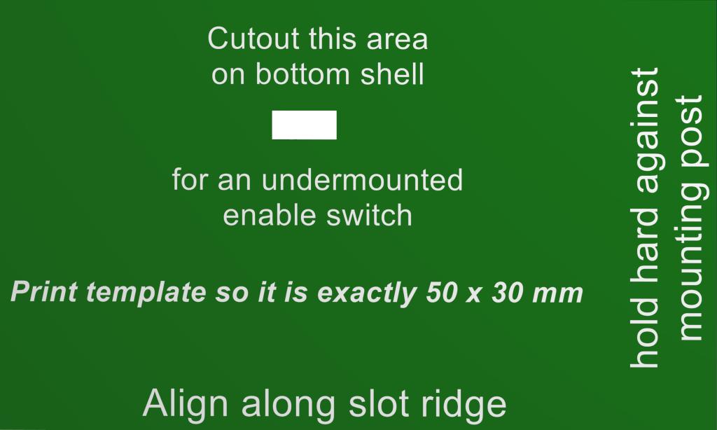

Posts: 2983
Posted: 12:53am 16 Oct 2026
GDay People,
If you are so inclined, remove the DPDT switch and mount it on the underside of the PCB and cut a hole out of the bottom case shell to easilly switch from underneath.
I have created a template to do the job. mark on the inside of the bottom shell where to cut the hole.
Template.zip
I have zipped it up so that sizing shouldn't alter.
Use what ever photo editor you have to resize it if it doesn't print to the exact size of 50mm x 30mm.
Mick (The Big one)
Edited 2026-10-16 10:53 by bigmik
mozzie
Joined: 15/06/2020
Posts: 481
Posted: 06:02am 16 Oct 2026
G'day Mick,
The simplest solution is often the best, reckon you might have nailed it
Time to fire up the solder sucker / soldering iron.
Cheers, Lyle.
