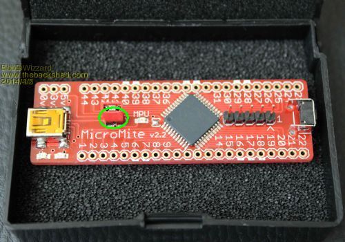

I received a couple of Phil's 44 pin modules a couple of days back. Can someone tell me what the header on the board, circled in green in the image, is used for.
Posts: 10048
Posted: 04:00pm 04 Apr 2014
It's the MCU power jumper.
Remove this jumper, if you are powering the board from an external 5v supply, using the headers above the USB socket. Basically, it connects the USB 5v supply, to the module, so you can run it from the USB cable.
If the module is embedded in something, more then likely you will be feeding it an external power supply, so remove the red jumper in that case.
WW does need to include a single sheet of basic info such as what that jumper is for etc, to avoid this kind of confusion... Edited by Grogster 2014-04-06

In the meantime, please note that the board can be used in three different configurations:
1> Basic mode (PIC & caps only - requires 3v3 supply)
This is ideal when you want to embed the MicroMite into your own design/PCB
2> Advanced mode (As above but with LDO & reset circuitry)
This is for when you have your own usb-to-uart module - requires 5v supply
3> Plug-n-Play mode (as above and includes USB-to-Uart onboard)
This is a 'standalone unit' requiring no external power. Ideal for testing a design and experimentation
The module in BobD's photo is configured as a 'plug-n-play' module requiring just a USB connection (Note that no headers are soldered as requested by Bob!). With this configuration, the red jumper simply acts as an on/off switch to save the user from having to disconnect the USB lead all the time.
Like Grogster says, the jumper can also be used to disconnect USB power so that an external power supply can power the Module.
I will make this clear on the website!!
Bob - Other than the lack of basic instructions, I do hope your MicroMite Modules are to you liking . . . .
Phil

  WhiteWizzard said
The module in BobD's photo is configured as a 'plug-n-play' module requiring just a USB connection (Note that no headers are soldered as requested by Bob!).[/quote]
Phil, it's not my photo. I copied it from page 9 of this thread.
