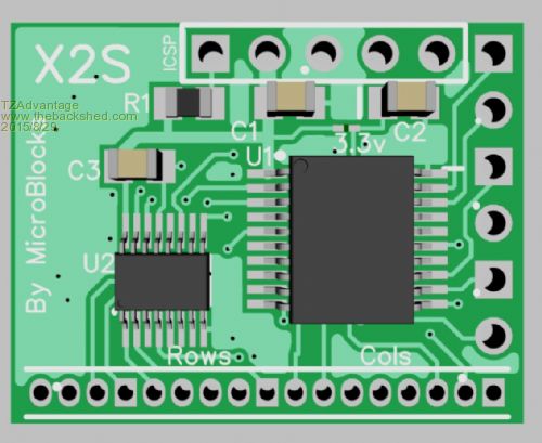

Yes, i like small. It is 23x18mm.
All the pins are still on a 0.1" grid. I considered 0.05" to allow flat cable, but then it gets really fiddly. Maybe i just try it to see how it pans out.

Greg,
I changed the 0.1" grid to 0.05" for the column and row pins. Now all connections to a keypad/keyboard are on a single edge and are easy to connect with standard flat cable. Flat cable should be spaced 0.05" so it will line up.
3d:
There is even space for a micro usb connector on the left.
That would allow making a custom usb keypad. Just what i need!
Getting better al the time. Thanks for the feedback.

Posted: 01:08am 29 Aug 2015
That will be good for ribbon cable but the FPC on Grogs' 'blue' keyboard has 1mm spacing, not 0.05" i.e. 1.25 mm. If a keyboard has FPC it will probably be 1mm (not expert on this at all) so making it easy to attach to that would be good. If it's better to come direct from the keys without the FPC, or if ribbon at 0.05" is the cable used in the keyboard, then ribbon at 0.05" spacing would be good.
Ideally both is best - how about 1mm pads to match Grogs' connector (see p3 of thread) and 0.05" header as you've done for ribbon - just have to fit it.
If a micro USB will fit that's a plus but it will still need header access to the USB lines and ideally some way (a couple of close holes for a cable tie?) to securely attach a hard wired external cable.

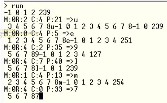

Grogster,
Can you do the same kind of screen copy of the following keys for me?
Tab, CapsLock, LeftShift, Fn, Control, Option, Command,
LeftArrow, DownArrow, RightArrow, UpArrow,
RightShift, Enter and Delete.
I can then have a go to write some code to handle the special keys and figure out the rest of the Lookup table.

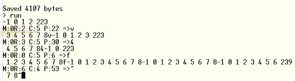

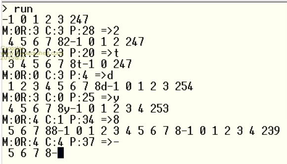

Posts: 10044
Posted: 12:06am 31 Aug 2015
UPDATE:
TAB,CAPS,L-SHIFT,Fn,CONTROL,OPTION,COMMAND:
LEFT,DOWN,RIGHT,UP,R-SHIFT,ENTER,DELETE(backspace):
Looks like gobble-de-gook to me, but I guess you can make sense of it?

Posted: 12:17am 31 Aug 2015
Yes the R:, C: give the row and column. And P: gives the location in the lookup string.
Helps me to check critical points (modifier keys) in the matrix.
Thanks!

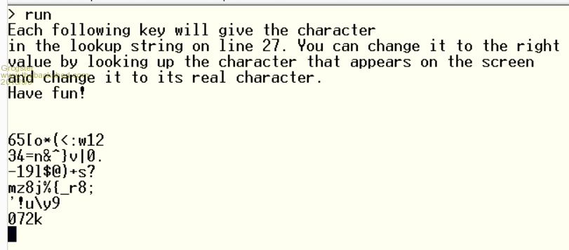

Grogster,
Here is a totally rewritten matrix scanner.
It works with a timer interrupt and has a better structure to allow for all the special keys.
Code for the special keys have to be added, but i need from you the complete translation of all the keys.
When the program starts it asks for the ENTER key. Press that and you are instructed to change the code.
After you change the code run it again and then press all the keys
in order from left to right, top to bottom. After each row press an enter.
This will allow for an easier screendump with all the key values on it.
At the end use the arrows left, up, down, right in that order.

Posts: 10044
Posted: 07:46pm 02 Sep 2015
UPDATE:
Here are the results of running your code TZA:

Posted: 01:37am 03 Sep 2015
Thanks Grog. That makes it a lot easier to get that lookup table right.
Edit: The number of characters on your screendump are not all of the keys.
I guess the scan routine drops some keys. The top row should have 13 keys and i see only 11. All other rows are missing 1-3 keys also. Did you use TeraTerm because MMEdit VT100 sometimes misses a character.

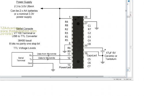

I have made a pinout of what is used and no more pins available. Why does the chip have 3 GND connections. I guess because it is long and skinny.

Posts: 10044
Posted: 02:44am 03 Sep 2015
Hey TZA.
I will run the test again - perhaps I was pressing the keys too fast.
Yes, used TT, hence the black-on-yellow text from the TT window.
You can get the 44-pin chip in QFN, which is only 8x8 mm, but being QFN, I am not sure how difficult that would be to solder - probably harder then chips with legs.
The standard 44-pin QFP does fit on the board, and would give us lots more pins to play with, but to get all the tracking in, the board would PROBABLY have to go to 4-layer. That is not a problem, really, it just makes the board more expensive to get made - but C'est La Vie.........
Thw 44's would have the extra pins to allow for the matrix, up to four replacement LED's, and the serial port or ports. It could even be pin-mapped such that you could have serial, I2C and SPI output formats - that might be getting too close to your idea though.
I will do another run of that test now, and post the screen grab shortly.
