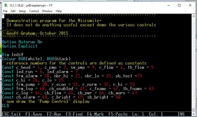

AND it includes the Micromite full screen editor
Use OPTION COLOURCODE ON to enable colour editing
and then use the EDIT command as in the Micromite
If required you can still use nano using the command NANO
NB: the editing works well using putty over SSH. There is a problem with Delete /backspace in Teraterm. This can be fixed using OPTION TERATERM ON.
I haven't tested using a console window on a directly connected monitor/keyboard. Feedback appreciated.

cdeagle
Joined: 22/06/2014
Posts: 269
Posted: 12:12am 06 May 2017
The back space and delete are now working.

cdeagle
Joined: 22/06/2014
Posts: 269
Posted: 03:54am 06 May 2017
Version 5.3.a20 seems to work fine on an HDMI display and the 7" LCD display.
