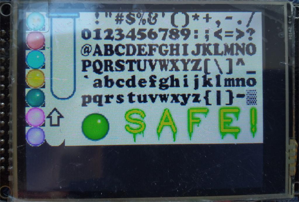

I thought it might be fun to try to port vegipete's excellent ChemiChaos to the Armmite F4 (which, to my mind, remains the best and least expensive of the all-in-one ports of MMBasic (though lacking in the graphics capabilities of the CMM2)).
For those not familiar, the F4 is based on a STM32F407VET6 board , includes USB programming, an RTC, a micro SD socket, a winbond flash chip, and a high-speed, 16-bit LCD interface. Board and LCD can be had for around $25US. Larger LCDs up to 7 or even 9 inches are possible.
I've never written a game, and prior to CMM2 had not played one since arcade Pac-Man and Space Invaders on a Xerox Alto/Bravo in the early 80s. So it would be a learning experience.
I downsized Pete's "ChemiChaosSprites.png" file to a 320 pixel width, keeping the aspect ratio, and turned it into a bmp file. Downloaded with XMODEM RECEIVE and then LOAD IMAGE "ChemiChaosSprites320b.bmp". So far, so good.
(Note: the LCD is crisp compared to this photo.)
I cleared some space on that image and did some BLITs:
box 180,0,140,240,0,rgb(black),rgb(black)
blit 27,0,250,0,46,120
blit 0,0,259,10,26,26: blit 0,26,259,36,26,26: blit 0,104,259,62,26,26: blit 0,156,259,88,26,26
Again excellant.
There is no F4 manual, so documentation of the commands chain back to the Armmite H7 manual, the Micromite Plus, and the original Micromite manual. The H7 says "The BLIT and SPRITE commands can be used interchangeably. All Micromite Plus functionality is preserved with minor functional changes."
However, for the F4, SPRITE 27,0,250,0,46,120 yields "Error: Unknown command", so BLIT it is, and as far as I can tell, only the Micromite Plus commands.
BLIT READ #1,0,0,26,26: BLIT READ #2,0,26,26,26: BLIT READ #3,0,52,26,26: BLIT READ #4,0,78,26,26
The above works to save 26x26-pixel bit areas into 4 numbered buffers (sprites?!). It turns out because of the resizing, some of the balls are 26 pixels high and some are 25.
After fiddling, I am able to make 9 BLIT buffers (7 balls, one arrow, one test tube. Then I can produce this:
Here's the code.

The images aren't perfect, but should be good enough so that I can try to start in on Pete's game code. I still need to produce a down arrow (probably on the PC), since I can't see that there is a way to rotate the BLIT buffer.

Success. ChemiChaos on youtube.
My porting method was brute force. After setting up the 12 sprites (blit buffers) and changing the text to be output with the TEXT command, I simply ran the program on the F4 until it crashed, usually at a BLIT command with invalid parameters or a SPRITE command. I then fixed that and ran until the next "Invalid syntax".
I made most changes on the PC and did "XMODEM R "ccf4.bas", but if the change was simple (a value or a statement or two) I used the MMBasic editor (and also made the change on the PC). I probably used XMODEM R 50 times or more.
I tried to make it so it would run on either the CMM2 or Armmite F4. I set up a variable, cputype%, initialized it to 0 for CMM2, and checked for mm.device$="ARMmite F407" to set it to 4. Then at each necessary point, I checked cputype% and executed either CMM2 or F4 code. I have not yet gone back to see if the code works on the CMM2.
As I expected, except for the graphics parts, vegipete's game code just worked. They may be some exceptions I haven't tested yet. The bottoms of the balls (black) are transparent on the CMM2. I saw some suggestion that transparency might work on some LCDs, but didn't investigate when it didn't on this 320x240 model.
I didn't make allowance for the 480x272 or 800x600 LCDs which can be fitted (with an adaptor) to the F4--I just plugged in magic numbers for the 320x240. I may fix that later.
Code is attached, along with the ChemiChaos320b.bmp file.

Playing through to the end revealed a few more bugs.
I shifted the vials left, but the 7th one shows up distorted. The balls appear correctly, though. For the games which have an 8th and 9th vial, they are off the edge of the screen, but the program handles them properly and you can complete the round.
Among the non-graphics things I had to change because the CMM2 commands are not supported by the F4 were MATH SCALE and MOD$ on the left of the "=" sign.

       movecount(5) = movecount(5) + 1  ' another mouse click this level
       movecount(6) = movecount(6) + 1  ' another mouse click this attempt
       movecount(8) = movecount(8) + 1
       k = 32    ' simulate space bar to grab/release ball
     endif
   end sub
   sub AnotherKeyPress
     local c$
     movecount(1) = movecount(1) + 1  ' another keypress this level
     movecount(2) = movecount(2) + 1  ' another keypress this level
     movecount(3) = movecount(3) + 1  ' another keypress this attempt
     movecount(7) = movecount(7) + 1
     ShowCounts
   end sub
   sub ShowCounts
     if countvisible then
       text 165,572," "+str$(movecount(1))+" ","CT",7,1,0,&hFFFFFF
       text 165,562," "+str$(movecount(2))+" ","CT",7,1,0,&hFFFFFF
       text 165,552," "+str$(movecount(3))+" ","CT",7,1,0,&hFFFFFF
       text 165,582," "+str$(movecount(7))+" ","CT",7,1,0,&hFFFFFF
       text 235,572," "+str$(movecount(4))+" ","CT",7,1,0,&hFFFFFF
       text 235,562," "+str$(movecount(5))+" ","CT",7,1,0,&hFFFFFF
       text 235,552," "+str$(movecount(6))+" ","CT",7,1,0,&hFFFFFF
       text 235,582," "+str$(movecount(8))+" ","CT",7,1,0,&hFFFFFF
     end if
   end sub
   sub ToggleCounts
       countvisible = 0
       box 50,530,225,62,1,&hFFFFFF,&hFFFFFF
     else
       countvisible = 1
       text 165,530,"Key","CT",7,1,0,&hFFFFFF
       text 165,540,"Strokes","CT",7,1,0,&hFFFFFF
       text 235,530,"Mouse","CT",7,1,0,&hFFFFFF
       text 235,540,"Clicks","CT",7,1,0,&hFFFFFF
       text 125,550,"This attempt","RT",7,1,0,&hFFFFFF
       text 125,560,"This level","RT",7,1,0,&hFFFFFF
       text 125,570,"This game","RT",7,1,0,&hFFFFFF
       text 125,580,"Total","RT",7,1,0,&hFFFFFF
       box 130,550,141,41,1,0
       line 130,560,270,560,1,0
       line 130,570,270,570,1,0
       line 130,580,270,580,1,0
       line 200,550,200,589,1,0
       ShowCounts
     end if
   end sub
   sub PutChar(c$)
     local cn = asc(c$) - 32
     if cn < 0 then exit sub
     if cn > 95 then exit sub
     blit 102+(cn mod 16)*21,int(cn/16)*30,charx,chary,21,30,sp
     charx = charx + 21
     if charx > MM.HRES then
       charx = 0
       chary = chary + 30
     endif
   end sub
   sub PutString(s$)
     local i
     if cputype%=cmm2% then
       for i = 1 to len(s$)
         PutChar(mid$(s$,i,1))
       next i
     else ' Armmite F4
       if chary = 10 then ' first line
         if ipsFlag% then: font 4: else: font 2: endif
         i=mm.hres/2 - len(s$)/2*mm.fontwidth
         text i,0,s$,,,,rgb(black),rgb(white)
         if ipsFlag% then: ly%=mm.fontheight+42: else: ly%=mm.fontheight+14: endif
       else
         if ipsFlag% then: font 3: else: font 1: endif
         text 0,ly%,s$,,,,rgb(black),rgb(white)
         ly%=ly%+mm.fontheight
       endif
     endif
   end sub
   sub ShowSafe
     if cputype%=CMM2% then
       rbox MM.HRES/2-220, 95,360,100,50,&h00FF21,&h00FF21   ' greenish frame
       rbox MM.HRES/2-210,105,340, 80,40,rgb(white),rgb(white)
       blit 180,180,MM.HRES/2-170,110,260,70,sp
     else
       if not ipsFlag% then
         box 0,44,320,54,,rgb(white),rgb(white)
         blit write #11,130,44,190,48 ' draw SAFE!
       else
         DrawBlank(xpos) ' blank the last arrow
         text mm.hres/2,ballRad*3,"S A F E !",C,5,,rgb(yellow),rgb(green)
       endif
     endif
   end sub
   ' Read another level from the data
   function MixVials()
     local i,j,mix
     local c$
       math set 0,vials()    ' start with empty vials
     else
       for li%=0 to 9 ' vials(9,4)
         for lj%=0 to 4
           vials(li%,lj%)=0
         next lj%
       next li%
     endif
     read nballs
     if nballs = 0 then
       MixVials = 0
       exit function
     endif
     if cputype%=CMM2% then page write 2    ' don't want to see prints on screen
     print levels,   ' will appear on console if attached
     if nballs = levelball then
       levelnum = levelnum + 1
     else
       levelnum = 1
       levelball = nballs
     endif
     m$ = ""
     read nvials
     if nvials = -1 then
       nvials = nballs + 2
       for i = 1 to nballs
         m$ = m$ + string$(4,str$(i))
       next i
       for i = 1 to len(m$)  ' scramble m$
         c$ = mid$(m$,i,1)
         j = int(rnd * len(m$)) + 1
   ' LB      mid$(m$,i,1) = mid$(m$,j,1)
   ' LB      mid$(m$,j,1) = c$
             ls$ = mid$(m$,j,1)
             m$=mid$(m$,1,i-1)+ls$+mid$(m$,i+1)
             m$=mid$(m$,1,j-1)+c$+mid$(m$,j+1)
       next i
       print "random   ";
       for i = len(m$) to 1 step -1
         print mid$(m$,i,1);
       next i
       print
       for i = 1 to nvials   ' fill with data from m$
         for j = 1 to 4
           vials(i,j) = val(left$(m$,1))
           m$ = mid$(m$,2)
         next j
       next i
     else
         read mix
         m$ = m$ + str$(mix)
         for j = 1 to 4
           vials(i,j) = mix mod 10
           mix = mix \ 10
         next j
       next i
       print "built in "; m$
     endif
       math scale vials(),1,vialsbak()  ' save starting configuration
       page write 0
     else
         for lj%=0 to 4
           vialsbak(li%,lj%)=vials(li%,lj%)
         next lj%
       next li%
     endif
     MixVials = 1
   end function
   sub F4_setup
   static integer h=69,w=65
   local x,y
   '  print "F4_setup"
   backlight 50
   if MM.INFO$(LCDPANEL)<>"IPS_4_16" then
     Load IMAGE "ChemiChaosSprites800.bmp"
     for li%=1 to 12:  On error skip: Blit CLOSE li%: next li%
     Blit READ #1,0,0,26,26: Blit READ #2,0,25,26,26: Blit READ #3,0,51,26,26
     Blit READ #4,0,76,26,26: Blit READ #5,0,102,26,26
     Blit READ #6,0,127,26,26: Blit READ #7,0,152,26,26
     Blit READ #8,26,126,26,26 ' up arrow
     Blit READ #9,27,0,46,120 ' test tube
     Blit read #11,130,130,190,48 ' "SAFE!"
     Load IMAGE "DownArrow.bmp"
     Blit Read #10,0,0,26,26 ' down arrow
     CLS RGB(white)
     Blit read #12,0,0,26,26 ' blank sprite
     CLS RGB(white)
   else
     ipsFlag%=1
   ' NEW: but insufficient memory with IPS 800x480 LCD--must draw circles, etc.
   '  Blit READ #1,0,0,65,69: y=y+h: Blit READ #2,0,y,65,69: y=y+h: Blit READ #3,0,y,65,69
   '  y=y+h: Blit READ #4,0,y,65,69: y=y+h: Blit READ #5,0,y,65,69
   '  y=y+h: Blit READ #6,0,y,65,69: y=y+h: Blit READ #7,0,y,65,69
   '  y=y-h: Blit READ #8,w+1,165,69,26 ' up arrow
   '  Blit READ #9,66,0,118,320 ' test tube
   '  Blit read #11,326,347,460,130 ' "SAFE!"
   '  Load IMAGE "DownArrow_IPS.bmp"
   '  Blit Read #10,0,0,w,h ' down arrow
   '  CLS RGB(white)
   '  Blit read #12,0,0,w,h ' blank sprite
   '  CLS RGB(white)
   end sub
   sub DrawArrow(slot,updownFlag) ' updownFlag: 0=down,1=up
     local integer x,x2,y2,y3
         x=90*(slot-1)
         x2=x+14+ballRad*2: y2=ballRad*5: y3=ballRad*4
   '      ? "x,y3,Blank box; <CR> ";x;" ";y3;: do:a$=inkey$:loop while a$="":?
         blit write #13,x,y3,85,66
   '      box x,y3,85,radball*2,,clr(cW),clr(cW) ' blank the space
   '      print "x,x2,y2 <Enter>";x;" ";x2;" ";y2;" ";:
   '        do: a$=inkey$: loop while a$="": ?
         if updownFlag then ' up arrow
           triangle x+14+ballRad,y3,x2,y2,x+14,ballRad*5,clr(cBK),clr(cBK)
           box x+7+ballRad,ballRad*5,14,ballRad*.8,,clr(cBK),clr(cBK)
         else
          ' draw down arrow
   '        box x+1,y3,85,radball*2,,clr(cW),clr(cW) ' blank the space
   '        blit write #13,x,y3,85,66
           triangle x+14+ballRad,ballRad*6-1,x2,y2,x+14,ballRad*5,BLK,BLK
           box x+7+ballRad,ballRad*4.1,14,ballRad,,BLK,BLK
         endif
   '      print "<Enter>";: do: a$=inkey$: loop while a$="": ?
   end sub
   sub DrawBlank(slot)
         x=90*(slot-1)
   '      box x,y2-radball,85,radball*4,,clr(cW),clr(cW) ' blank the space
   end sub
   ' data format:
   ' #balls, #vials, ball pattern for each vial
   ' if #vials = -1 then fill (#balls + 2) vials ly
   gamelevels:
   data 1,2,11,11    ' trivial one to get started
   data 2,3,1221,2112,0
   data 2,3,1212,2121,0
   data 2,5,1121,1211,2111,1112,0
   data 3,5,1231,3321,2231,0,0   ' this one can't be done in only 4 vials
   data 3,-1
   data 3,-1
   data 3,-1
   data 3,4,1213,2231,3213,0
   data 3,4,2313,2123,2311,0
   data 3,4,2313,2232,1113,0
   data 3,4,1211,3323,1232,0
   data 3,4,2132,3221,3311,0
   data 3,4,2221,2133,1133,0
   'data 3,4,1233,1212,2133,0
   'data 3,4,1232,3121,1323,0
   data 4,-1
   data 4,-1
   data 4,-1
   data 4,-1
   data 4,5,2321,1412,4412,4333,0
   data 4,5,4232,1231,2443,3114,0
   data 4,5,3124,2121,2444,3331,0
   data 4,5,1224,4232,4311,4133,0
   data 4,5,2141,4333,3242,4121,0
   data 5,-1
   data 5,-1
   data 5,-1
   data 5,-1
   data 5,-1
   data 5,-1
   data 5,6,5154,3321,4222,3415,1534,0
   data 5,6,4131,2422,5412,5313,4553,0
   data 5,6,2154,2543,5414,2251,1333,0
   data 5,6,3214,2453,2431,2135,5541,0
   data 6,-1
   data 6,-1
   data 6,-1
   data 6,-1
   data 6,-1
   data 6,7,1642,5624,4161,3623,5432,5315,0
   data 6,7,6413,5124,3531,4265,6153,6224,0
   data 6,7,6342,5265,2341,4534,6152,6131,0
   data 6,7,2151,5634,6436,6514,3431,2225,0
   data 6,7,1324,4636,5413,6132,5562,5241,0
   data 7,-1
   data 7,-1
   data 7,-1
   data 7,-1
   data 7,-1
   data 7,-1
   data 7,-1
   data 7,8,2127,4665,4231,3776,4335,6151,4572,0
   data 7,8,4311,5562,2346,7773,6245,6124,3751,0
   data 7,8,2715,2136,2761,7634,5744,6552,3431,0
   data 0,0  ' indicate end of data
Edited 2021-04-24 05:34 by lizby
PicoMite, Armmite F4, SensorKits, MMBasic Hardware, Games, etc. on fruitoftheshed
© JAQ Software 2025
