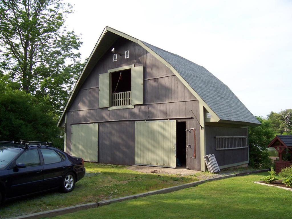

Posts: 3885
Posted: 03:57pm 03 Mar 2021
  thwill said  ... in a "barn"
Barn enough for you?
Right-side interior changed a bit in 2004:
Shots below construction views are "after" views. Wooden table in upper right now turned to come out from the wall and completely covered with electronics stuff, including VGA monitor.
My view: live webcam
Eagles regularly come to that big snag on the right.
And the whole thing is just a tad more crowded than those shots show.
