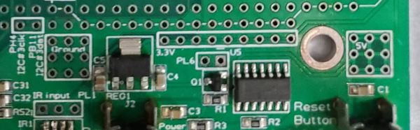

However one thing I don't like about it, is that unlike computers like the Commodore, ZX Spectrum, etc, etc that it was inspired by it does not have a keyboard built-in. So I figured I will make my own custom case with a keyboard "built-in" and I'll make it out of wood as well, to make it look truly DIY.
I also decided that I will include speakers built into the case as well.
Making the case itself should be simple enough, a rectangular box out of wood is child's play, I have also already found a solution for the keyboard, and that is simply to remove the guts from a cheap mechanical keyboard, and screw it onto the top of the case, and drill a small hole for the USB cable to route through.
I think I am going to go with the assembled RetroMax board from Circut Gizmos, because 1) it has a spot for a 3pin audio header which will come handy for the built-in speakers and 2) a bare board without a case is more suited to my needs.
Speaker wise, I know I will need a 3pin audio header to solder onto the board, a 3pin audio cable, a small amp circuit which will take a 3pin audio cable, a power source for the amp, and lastly small speaker drivers, probably between 2.5 and 3 inch.
This all seems fairly straight forward and doable, it's just a matter of finding the correct parts.
It seems like this little amplifier board has all I need and it's cheap too: https://www.ebay.ca/itm/193858194747?_trkparms=aid%3D111001%26algo%3DREC.SEED%26ao%3D1%26asc%3D20160908105057%26meid%3Dba66d98f0f7a4c3b9fdb6a5ae3147dcd%26pid%3D100675%26rk%3D2%26rkt%3D15%26sd%3D144148125094%26itm%3D193858194747%26pmt%3D1%26noa%3D1%26pg%3D2380057%26brand%3DUnbranded&_trksid=p2380057.c100675.m4236&_trkparms=pageci%3A20c51c3b-0968-11ec-bc01-825d6f91073a%7Cparentrq%3A96118ad017b0ab9667b35d34ffef7728%7Ciid%3A1
For power I think I'll use an 18650 battery since I have a few of those lying around, I'll just need to get an 18650 battery terminal so that I can easily remove, recharge, and replace the battery when it dies.
I will also get a switch to integrate into the amplifier/speaker circuit, so that my battery won't be being drained when the speakers are not in use.
I think theoretically, all should work. However I have never done anything like this before, and I don't have much experience at all working with wires and circuits and such. So, if anyone has any comments, or recommendations they would be welcomed.

That is a neat little amplifier but why do you need a battery?  You could power it from the 5V used to power the CMM2.
If you want to power the whole CMM2 + amplifier from a battery you would be better using a power bank of the type used to charge mobile/cell phones.  They have a good capacity, include the charger, deliver 5V and are cheap.
However powering the CMM2 from a battery does not make much sense as the monitor would need mains power.

  Geoffg said  That is a neat little amplifier but why do you need a battery?  You could power it from the 5V used to power the CMM2.
Geoff
From what I understand there is only one USB port on the CG board, and that will of course be used by the keyboard.
Perhaps you mean to power it from the board itself? If so, how would I do that?
This is where my lack of experience with pcbs, soldering, and circuits comes in. I'm more used to replacing drives, cards, ram, etc, in PCs and Macs, even though some of them can get very old, like 286 and even 8088 based machines.

  Twiggy said  Perhaps you mean to power it from the board itself?
Easy.  The Retromax has a standard 40 pin I/O connector (see the CMM2 manual for the
details) which supplies Ground and +5V.  Run two wires from these pins to your
amplifier.  You can solder the wires to the underside of the Retromax or use jumpers
like these which will push onto the Retromax's I/O pins.
Geoff

Ah thanks for the information, I didn't know that was possible. I will use jumpers then.

Below the sea-of-holes on the RetroMax are unpopulated connections to Gnd, 5V, and 3.3V.
