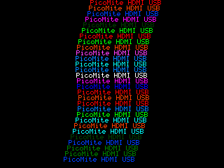

javavi
SinePrint
MODE 2
T$="PicoMite HDMI USB"
LT=Len(T$)*MM.FONTWIDTH
YB=MM.VRES-MM.FONTHEIGHT
XRL=MM.HRES-LT-MM.FONTWIDTH
XLL=MM.FONTWIDTH
XS=YLL
DIR=0
P=0
 X=XS+Sin(P)*MM.FONTWIDTH
 Color Map(1+Int(Rnd*15))
 Print @(X,YB)T$
 If XS<=XLL Then DIR=1
 If XS>=XRL Then DIR=-1
 Inc XS,DIR
 Inc P,.3
 Pause 60
Loop While Inkey$=""

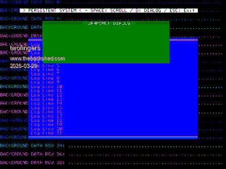

twofingers
Windows for Picomites
' MMBasic Window or Popup Demo - Virtual Screen Buffer (80x40)
' For VGA/HDMI MMBasic v6.01, Mode 3
' Originally developed for FM
Option Console Screen
Option default integer
MODE 3:CLS
Dim c_max=MM.WIDTH-1,r_max=MM.HEIGHT -1
Dim FW=MM.FONTWIDTH,FH=MM.FONTHEIGHT
' ONE GLOBAL ARRAY (Full Screen 80x40) Memory: ~6.4 KB
Dim sc$(c_max,r_max,1) Length 1
Dim q(15) = (0,1,2,3,4,5,6,7,8,9,10,11,12,13,14,15)
Colour Map q(), q()
Array Set Chr$(32), sc$()'clear Array (Not entirely clean!)
For j = 0 To r_max Step 2
 PrAt 0,j,"Line "+Str$(j)+": "+String$(70, "."),(j Mod 14)+1,0
Next
PrAt 10,2," > POPUP (SINGLE ARRAY) DEMO < - PRESS any KEY to START",0,15
Do :Loop Until Inkey$ <>""
 OpenWin(10,10,40,8,"Dialog 1",15,1)
 Text 12*FW, 14*FH,"Only sc$() array is active.", "L", 1,1,q(15),q(1)
 Do :Loop Until Inkey$ <> ""
 CloseWin(10,10,40,8)
 OpenWin(10+10,10+10,40,8,"Dialog 2",15,3)
 Text (12+10)*FW,(14+10)*FH,"Only sc$() array is active.","L",1,1,q(15),q(3)
 CloseWin(10+10,10+10,40,8)
 OpenWin(10+15,10+15,40,8,"Dialog 3",15,2)
 Text (12+15)*FW,(14+15)*FH,"Only sc$() array is active.","L",1,1,q(15),q(2)
 CloseWin(10+15,10+15,40,8)
Loop While LCase$(DlgBox$(1,1,40,8," Continue? ",15,1))="y"
PrAt 10,2,"                >  DEMO COMPLETED ! <                  ",0,15
End
'********************** Subroutines: ***********************
'All screen outputs are written synchronously into an array
'For popups, use the text command!
Sub PrAt(c,r,t$,f,b)
 Local i,p,idx=c-1
 p=(f<<4) Or (b And &H0F)
 Text c*FW,r*FH,t$,"L",1,1,q(f),q(b)
 For i=1 To Len(t$)
   Inc idx
   sc$(idx,r,0)=Mid$(t$,i,1):sc$(idx,r,1)=Chr$(p)
 Next
End Sub
Sub OpenWin(x,y,w,h,titl$,f,b)
 Local j
 For j=0 To h -1
   Text x*FW,(y+j)*FH,Space$(w),"L",1,1,q(f),q(b)
 Next
 Text x*FW, y*FH,String$(w,Chr$(205)),"L",1,1,q(f),q(b)
 Text (x+2)*FW,y*FH," " + titl$ + " ","L",1,1,q(f),q(b)
End Sub
Sub CloseWin(x,y,w,h)
 Local i,j,p,f,b,ch$,curX,curY=y-1
 For j=0 To h
   Inc curY
   curX=x-1
   For i=0 To w
     Inc curX
     ch$=sc$(curX,curY,0)
     p=Asc(sc$(curX,curY,1))
     f=(p>>4):b=p And &H0F
     Text curX*FW,curY*FH,ch$,"L",1,1,q(f),q(b)
   Next
 Next
End Sub
Function DlgBox$(x,y,w,h,Titel$, fc, bc)'DialogBox
OpenWin(x,y, w, h, Titel$, fc, bc)
Text (x+2)*FW,(y+4)*FH,"Would you like to continue? (y/n)", "L", 1, 1, q(fc), q(bc)
Do :DlgBox$=Inkey$:Loop Until Instr("ynYN"+Chr$(27),DlgBox$)
CloseWin(x,y,w,h)
End Function
I uploaded this demo code, originally intended for FM, to Gemini and requested that it add a scroll function. This is the result it produced:
Win for Picomites01.zip
Perhaps it will be useful to others?
I think adapting the code for the console (VT100) should be easy. It's similar to the "FRAME" code Peter offered about a year ago. Of course, everything would be much simpler if the code were hardcoded into the firmware.
Michael
Edit:
This is the VT100 (Console)-Version (made by Gemini):
scrollVT0012w.zip
Edited 2026-03-29 23:11 by twofingers
