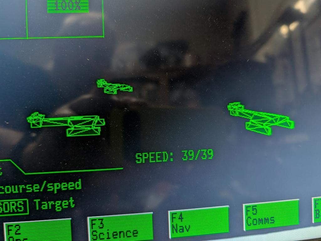

Aha - I spoke too soon - now I have some weird rectangles on my graphics pages. I've highlighted some in the screenshot below with arrows.
I have guests arriving in a couple of minutes, so can't investigate further tonight - but will try and provide more data tomorrow. This was with the second firmware you posted, but I'll test tomorrow with the first one.

  matherp said  Please try this version.
CMM2V1.5.zip
I've just finished my testing. I verified these results on two separate Gen 2 CMM2's (with separate SD cards) - and they did the same things.
I also tried doing a "full chip erase" before writing from STM32Cube and that didn't help.
I have the "Verify after programming" option checked.
With the original firmware 5.07.01.bin the corrupted video effect does not happen.
With the first firmware you posted on this thread, the video corruption effect does not occur.
With the second firmware you posted on this thread, the video corruption does occur.
I have toggled back and forth between original firmware and latest a few times on the two machines and the results are consistent.
The test program I am using is below, and the issue appears to occur when I load an image. I tried both JPEG and PNG and both exhibit the same problem.

And this is an example of what it looks like when loaded by the new firmware
To be clear, the old firmware still works 100% fine, so I am very very happy to carry on using that. I just thought this info might help.
Edited 2025-03-30 04:11 by PeteCotton
Posted: 06:56pm
29 Mar 2025
Thanks to your info I think I know the issue. The codebase has grown so I have had to
use a different compiler optimisation to keep the size of the binary down. Looks like something is not always completing in time. So I need to track down what and look to recode or re-optimise that bit.
