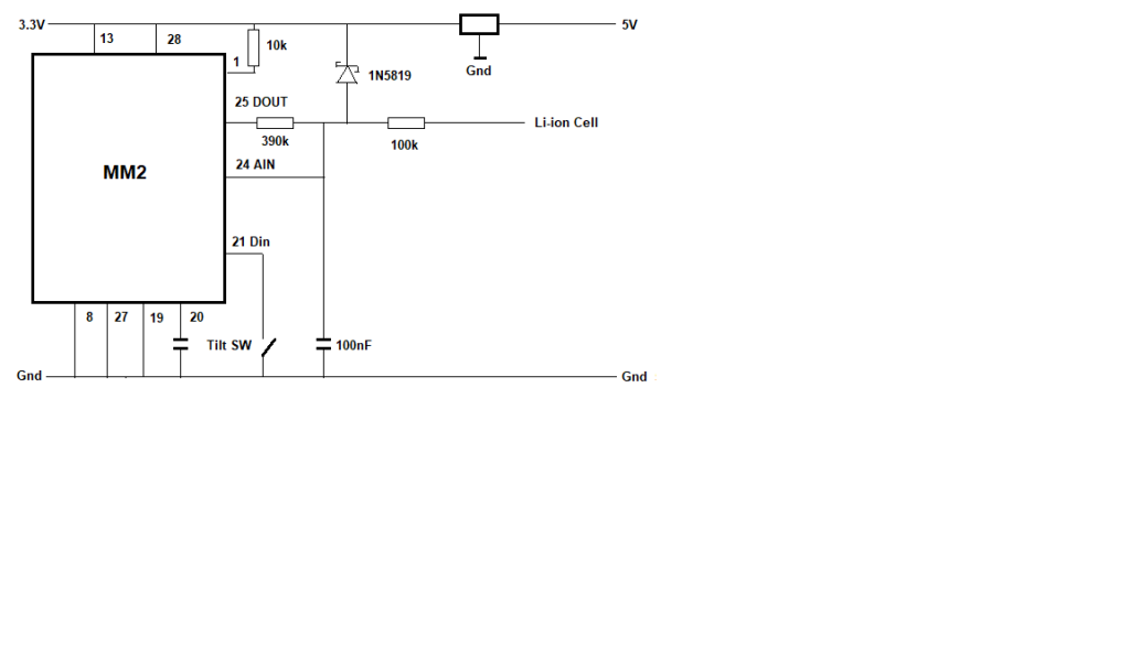

Here is a MM2 tested program for monitoring the tilt switch and Li-ion cell.
It can read the cell volts up to 4.1V with the divider values shown in the diagram. If you only need up to 3.3V the lower leg can be removed.
The current through the upper leg of the divider doesn't get wasted while the MM2 is sleeping. The lower leg of the divider gets switched off and the diode diverts the current to the 3.3V rail, helping power the MM2. When the cell volts are less than 3.4V no current will flow through it anyway.

In the circuit above the 5V to 3.3V regulator is a switch-mode type which is why I added the capacitor on the AIN pin (and Pause in the program). I assumed that noise would be an issue (similar to the cell-to-5V converter in Grogster's setup), however removing the capacitor and Pause make little difference.  The noise is fairly low at about 20mV.

That will be an added drain on the cell, which Grogster wants to avoid.
In the circuit above (tested and working) the cell is read directly via a voltage divider (BigMik's suggestion) so timing issues don't occur. It doesn't draw any extra current while the MM2 sleeps.
As it monitors the cell directly Grogster can set whatever low battery alarm he wants, while the flashing led levels are not specified in the data sheet.
They could be too high or low to ensure the maximum time between recharges without risk of going flat.
