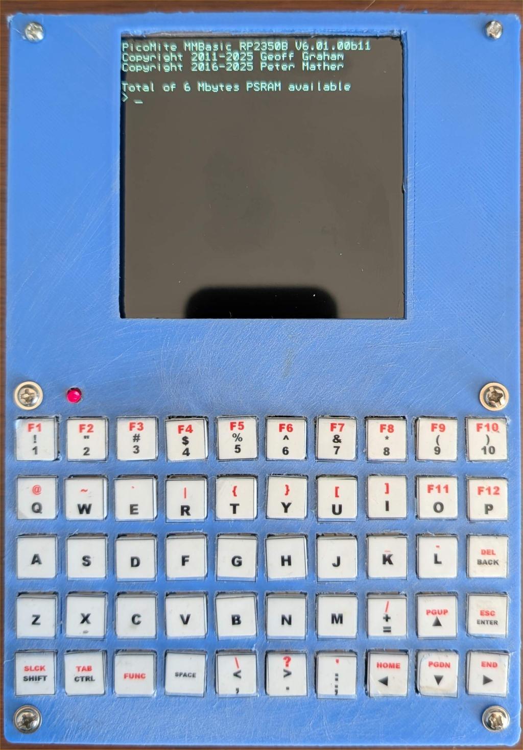

I'm going round in circles on the keyboard for this. The intention is that the device is properly open source, can be built be anyone, buying in bits from JLC and putting it together yourself with a case that you can 3D print yourself of get JLC to print one for you.
The keyboard is the difficult area. For my prototype I've used a keyboard overlay from a commercial mini  bluetooth keyboard but this is expensive and quite small to use.
My latest concept is to use 12x12mm Tactile switches (as used in the Game*Mite but with a square 12x12 keytop) in a 10x5 matrix. This should be easier to use and it should be easy to get vinyl stickers made for the keys. My proposed layout is
The limited number of keys does mean some fairly important characters will be need the FUNC key held but going more than 10x5 starts to be too big for a handheld device.
As always - thoughts appreciated

  matherp said  I'm going round in circles on the keyboard for this. The intention is that the device is properly open source, can be built be anyone, buying in bits from JLC and putting it together yourself with a case that you can 3D print yourself of get JLC to print one for you.
Thoughts on the layout, somewhat subjective so I'm not sure which bits will be helpful:
It's good if it can support thumb-typing - holding the device while pressing keys with the thumbs. This does make it hard to press function or shift on one side of the keyboard, while pressing another key on the same side - e.g. Shift-A, Shift-2, FUNC-1 in the layout given. Solving this for everything might take a second FUNC and a second SHIFT key. Not sure that's a good idea, but if you don't do that, I think you've done a good job of keeping a lot of the FUNC-requiring keys in the middle or right, where it's easier to reach them with the second thumb. If you can press shift-lock instead of holding down shift that helps, but shift-lock itself needs two left thumb presses. Might not be too bad reaching FUNC with the right thumb though, since it's not all the way on the left.
But if you replace the semicolon key with a second "FUNC" it would be easier having more FUNC combinations with left-hand keys (including the ones that used to be on the semicolon key, but also the ones already on the left-hand side).
I'm really used to ENTER being to the right of L - I might prefer to have ENTER and BACK swapped? Whereever BACK goes will feel unfamiliar though. Bottom right corner would be okay if it was free, but it's not.
It's good having backspace as its own key - using a ZX Spectrum or ZX81 where it's a two key combination is a pain. Same for arrows, good they have their own keys.
I've got to note - you can also do finger typing with the device on a table, not just thumb typing holding the device, and that's more amenable to using multiple keys on the same side of the keyboard. You can also hold it in one hand and finger type with the other. That might be how I'd type an capital A on the layout you showed. Thumb typing feels like it would be most convenient to me but it's maybe not vital for all key combinations.
Other thoughts:
It's a long time since I've used a tiny keyboard I like, but I think I like space between keys for your fingers to catch on and feel as they move across. e.g. if the key centres are 12mm apart, have them less than 12mm wide. This also means there's more space for your fingers - if there's an 8mm key and 4mm space on each side, that gives your finger 16mm it can occupy without pressing a neighbouring key, instead of just 12mm.
That's one thing I liked about the look of the picocalc (and many actual calculators). It seems to work okay in TV remotes too - that's probably the closest thing I've used recently.
On the other hand, as the keys get really small they're more uncomfortable to press - I'm not sure where the limit is there.
I've been trying to guess why a lot of modern tiny keyboards look smooth like the overlay you're using  in the prototype, it seems like there must be a reason. I suspect it's to slip into pockets without catching, and to avoid catching on things in general and getting damaged, but to me it makes them bad to type on.

The Palm Pico unit is looking good, the keyboard is always a PITA.
Whilst there will be no "perfect" layout, I have found the Rii X1 keyboard to be surprisingly good, even though it is tiny.
It looks like, similar to the keyboard you have used, the keys are a raised "bump"and this makes a huge difference, I have similar units with flat keys that are practically useless with normal fingers, and larger keyboards that are not as good as this one.
If you can find something with a similar profile, it may be possible to add an extra row at the top for an improved layout using rectangular keys.
Considering JLCPCB will more than likely be making the pcb's, would it be worth considering using 6mm tactile switches and have them plastic print keycaps as part of the job? They could be printed as a single grid and pulled apart to be fitted. They may also be able to print them in a flexible material as one piece.
This is the X1 used in my Pico Terminal, the keys are 7.8mm / 8.5mm pitch Horizontal and 7.3mm / 8mm pitch vertical, the keyboard itself is 102mm x 51mm
One more option, I previously built a device that used a resistive touch screen panel over a piece of paper as a keyboard, its not perfect but it works and they are easy to find.
Hope this is more help than hinderance...
Lyle.

Could the Up/Down arrow pair be swapped with the =/left pair so the arrow key layout matches convention?
Posted: 07:19am
22 Aug 2025
  Quote  Could the Up/Down arrow pair be swapped with the =/left pair so the arrow key layout matches convention?
It could but wouldn't it be harder to use in a game?
As currently laid out you can have two fingers from the left hand on up/down and two from the right hand on left/right.
I don't have a strong view and it is trivial to change - thoughts?

Put Up/down at the far left and left/right at the far right. If they were both horizontal or vertical pairs then lefties could simply swap keycaps and change a program option.  :)  I'm sure muscle memory would take care of the rest.

I've designed and draft printed a box - needs edges rounding etc. and I forgot to include a grill for the stereo speakers but I'm thinking about a major redesign.
I'm really pleased with the keyboard and holding the box in the hands the "two thumb" approach to typing works well. The keys are nicely separated and have a good feel so that will stay.
The display measures 73mm in width. It is IPS, very bright and clear and access to the display is lightening fast using the buffered ST7796S driver. See this demo However, the 320x320 4" diagonal display is somewhat dwarfed by the keyboard which is 124mm wide.
My thoughts are to swap the display with a 5" IPS SSD1963 800x480 display  - this one
This has a width of 110mm so will match the keyboard much better. I would intend to run it by default in 400x240 pixel doubled mode so that it is S/W compatible with the Game*Mite again using a RGB332 buffered driver. This will give 50x24 characters using a 8x10 font as the default. Of course 800x480 would be available to the user by changing the display driver using standard options.
Although the display is USD15 more expensive than the original it will reduce the cost of the motherboard as it includes the boost circuitry for the backlight.
It will also let me reduce the space between the screen and the keyboard.
The second big change is to use the Pimoroni PGA2350 rather than my DIL board. This will also reduce the cost and the PGA2350 is now stable at 360MHz which is my target frequency for the Palm Pico.
Thoughts?
