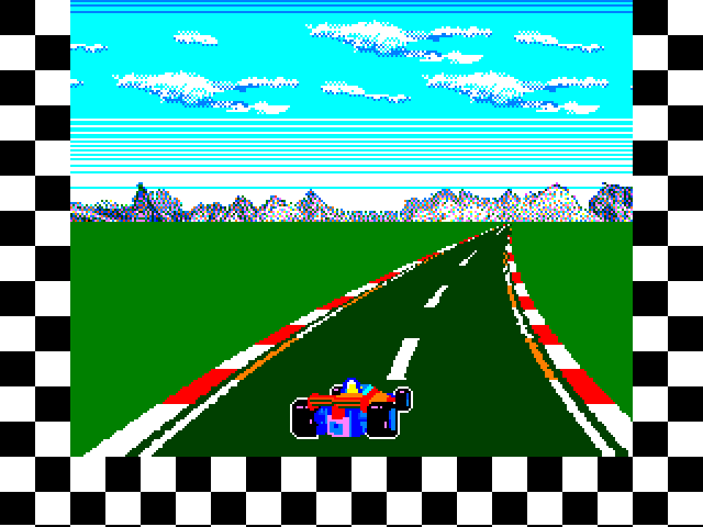

Posted: 10:46am
22 Mar 2026
Martin H.
Since it's Sunday,
I dug up some old code and sped things up using the new BLIT RESIZE command
On the PICO2 HDMI @252MHz, this gives me 47 FPS, so there's now room to include enemie cars, trees, and signs
Road.zip
Have Fun
Martin
