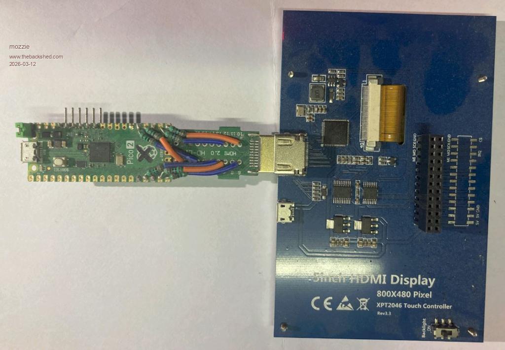

G'day,
This was knocked together during early testing with HDMI, rather crude but it does the trick.
Plugs straight into just about anything, the HDMI plug breakout is widely available.
Apologies for the crap photo, cropped from an old image.

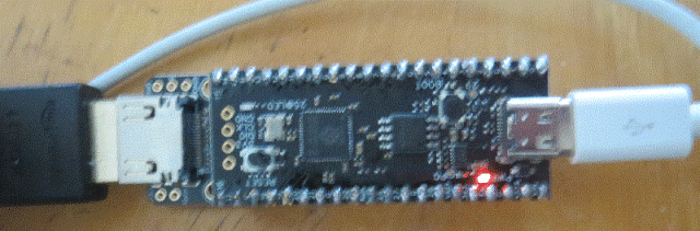

DVI sock working with the WeAct RP2350A module with 15MB on drive a:
(Looks like it might not be too hard to solder a PSRAM chip on this module.)

This is perfect

  lizby said  DVI sock working with the WeAct RP2350A module with 15MB on drive a:
The flash chip is a wide-body, 208 mil, and I can't find a PSRAM chip that size. I'm not going to be soldering a bunch of wires--the soldering would have been hard enough for me anyway--so I'll wait. It can't be too long before the Chinese cloners do their work on the Pimoroni model.

Well, @mozzie showed a real stick. But HDMI/VGA doesn't have +5V so you need the USB cable anyway and thus a stick isn't that necessary. The PGA/Waveshare is 4,4mm larger, not that much ;)
The HDMI breakout board directly soldered is IMHO in any way a nice solution.
