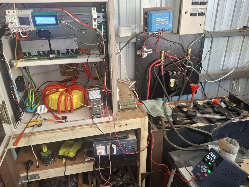

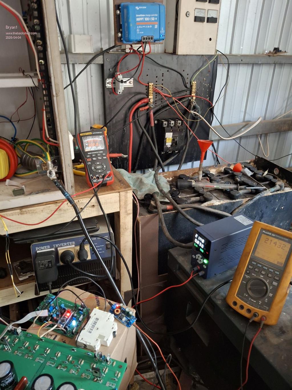

  Bryan1 said  Ok this time I put the clamp meter close to the negative battery terminal, turned on the toaster oven and one element.
Now 23.51 x 101.2 = 2379.2
The energy meter 2372.3 so that a lot better, now the AC voltage was 235 volts and I did notice turning on a 2nd element caused the voltage to drop to 215 volts.
Efficiency = 100 X (2372.3 / 2379.2) = 99.7% WOW!!
This is an inverter manufacturer's and DIY'ers dream!!

With Phill's suggest of switching noise causing a higher amperage moving the clamp meter to close to the Vbat ground was the best move so a true reading could be taken.
Once again a huge Thank You to all the members that have helped me with this project and I am just glad it's finished and working.
Regards Bryan

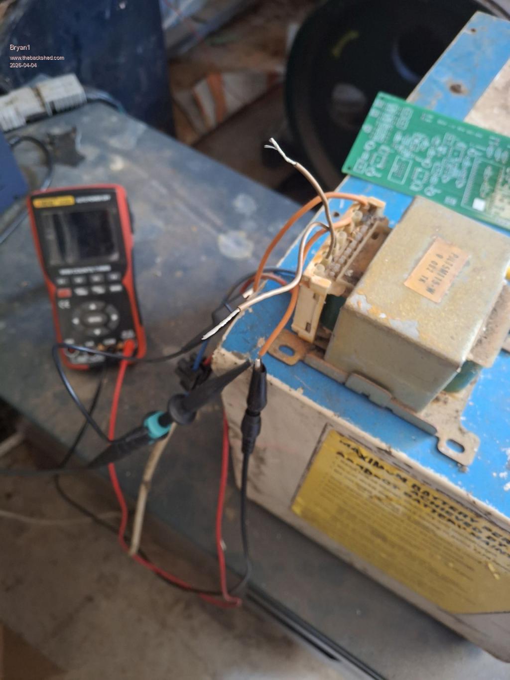

Ok this Ali board is here
On the left is the blue one I'm going to use as it is the upgraded board.
Now as all the outputs are in Chinese could a member please tell me what each connection is as we do need to know what each one is.
Regards Bryan

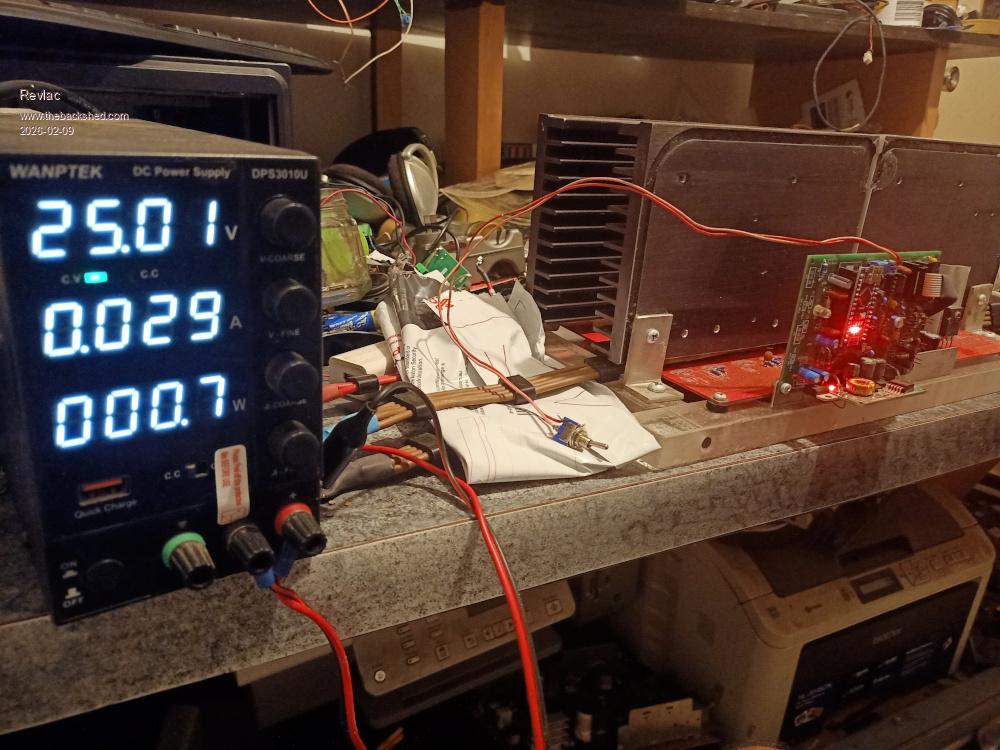

Now I do have that first small inverter to use for this inverter for testing
The choke uses the big choke from the AeroSharp Grid Tie with 10 turns of 6.5x3.5 enameled wire then varnished in. It would be good to set this choke with a scope to see what it can make as dual choke.
I got this design off Tony many years ago now when I tested this inverter it did run both vacuums
There is no pre start setup for this small inverter and it didn't blowup but now I know more a pre start setup will be done.

Hi Bryan, the connections can take a while to work out.
Near the transformer one of the sockets is for feedback, so if you have a look at which socket goes straight to the transformer that should be the feedback one.
Another one is for the LED to show the inverters state, either On or Standby.
The next set of sockets to the left will have one for the fan.
I will take some photos of my board and see if it is the same as yours.
Unfortunately they are a few different boards with different arrangements for the sockets.
If you can contact the seller of the board they can usually supply a diagram to show how the connections are made.
I will post a picture of my inverter later
Pete

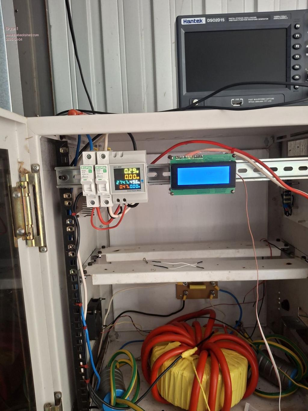

Well decided to give my chainsaws a good clean so when I decided to turn on my air compressor thought I have a look at the surge current on the energy meter.
20Kw   was the draw and the inverter just handled it now it's just clicked over 82Kwh and still going strong.
Regards Bryan

Perhaps your energy meter is unable to correct for power factor during a surge.
20kVA looks about right for a compressor motor starting, but it's P.F. during starting is probably around 0.3 so that would be 20 x .3 = 6kW. Still quite respectable.

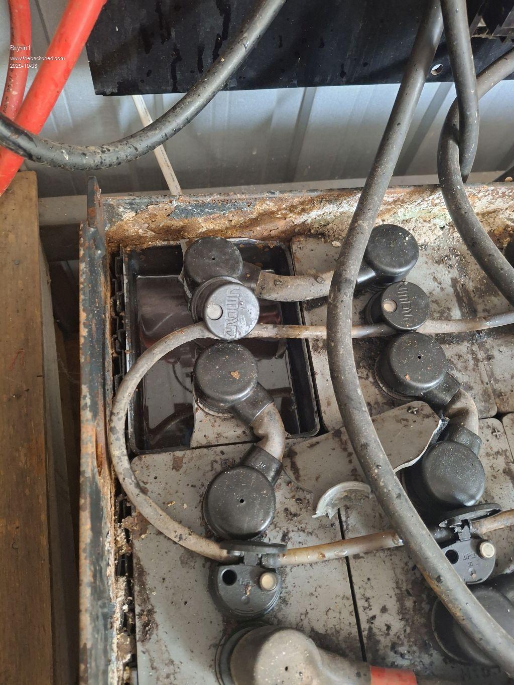

Well Guy's with me going back to Menz as their nightshift Fitter decided the first thing I need for the shearing shed is a forklift battery so in a couple of weeks I will get onto Ceil and buy a new forklift battery which should last a long time.
So as I now have build my first inverter it is time to get on and build a new inverter for the shearing shed. Now I do have a control and power board from my first build and a heap of components left from the last build so it does make sense to build the next one the same.
I did have a look on the forum for the link to the inductor coils then remembered as I bought them before just got on to Ali and bought the same ones so thats sorted.
Got that second Aero-sharp toroid so got to take the outer layer off like the last then workout the amount of turns needed like last time.
So let the fun begin once again.....
Regards Bryan
