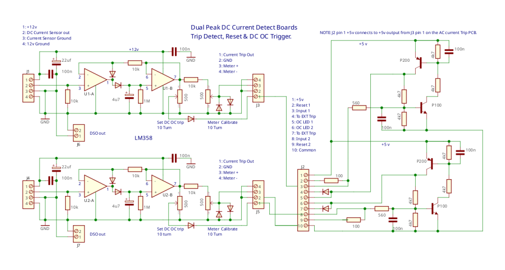

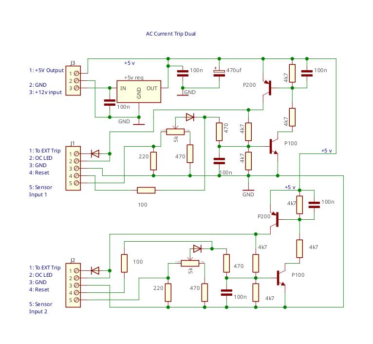

Interesting Problem.
A: I've been chasing an Over-Current trip event that can happen randomly once or twice a year.
B: This is a Dual Inverter using my O/C Supervisor board to trip the Nano Controller O/C Latch circuit from four O/C source events.
We are running off grid 24/7, the last time this happened was around 6 months ago, before that one year ago, both times it had tripped 3 times over 12 hours, and then no other incidents until two days ago, when it again tripped randomly 4 times in 48 hours.
Up until now I had been way to busy to look deeper.
I knew it was not caused by a real O/C event, and suspected a noise glitch or noisy component in the Controller Board master O/C Latch circuit or board leakage.
The advantage of using the O/C supervisor board is that the O/C board is able to indicate and latch the circuit(s) that tripped the Inverter. I.E. AC O/C or DC O/C and in a Dual Inverter, which Toroid / power board tripped first. See 3: below.
1: It’s NOT a code or Nano problem, the code and Nano are perfect.
2: The Controller O/C LED latches ON, and SPWM is initially Hardware Inhibited by the Latch circuit before the Nano Code disables the KiloVac port and disables the SPWM Port itself, the O/C latch is only tripped by Hardware, not the Nano or code.
3: The O/C supervisor Board did NOT Latch/Indicate any O/C trip event !!!!!
4: Real time graphing history showed NO O/C current spike, or ANY spike for that matter, and it would O/C trip at less than 700W of load, but again, NO O/C Supervisor Trip indication.
5: Pressing Reset would see the Inverter restart perfectly each time with all loads still connected.
Looking at the Controller circuit, the O/C Board normally connects to the EXT Trip input at the back of D5, with D6 removed. The external O/C supervisor Board latches to 5V on an over current event, exactly the same way as the circuit after D5, D6 on the Controller board latches, and this EXT input really should have a resistive divider to drop the +5V latched input down to around 2V input to the Controller latch input.
So Today:
I modified a New Controller board by breaking two tracks from R14 and J4-2 that connect to RV2, R-14 and J2 are then bridged back together, and the External trip now connects to the TOP of RV2. I adjusted RV2 to trip the Controller Latch at 2.2 vdc, previously it only required 0.9v.
This should eliminate any noise or glitch from the External Trip Input line running from the O/C supervisor board (Diode isolated), which again, outputs and latches at 5V whenever an O/C event is tripped, and a corresponding LED is enabled to indicate the O/C source.
Anyway, it's in and running, and we shall see if I get another random trip. So far, repeated 613A DC input has not fazed it, and 11.4kW AC output that was switching between 3kW and 11.4kW for an hour ran perfectly, but it also did all of that before, without a problem for 2.5 years, with the exception of the 3 random O/C events.
