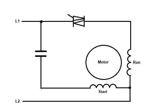

  Quote  That is why I think I also must add a soft-start module to the compressor.
A conventional single phase induction motor / compressor combination really requires a variable frequency drive for a soft start.
A conventional soft start circuit may prevent the motor developing enough torque to turn over the compressor, making the situation worse.
The other option is a very beefy solid-state relay or triac to switch it on at the peak of the AC cycle. With the first half cycle reduced to a quarter cycle the chance of pushing the stator into saturation is greatly reduced. Saturation briefly takes the current well above the LRA. The normal inrush current will follow but your inverter should be able to cope with that.
Hi phil, thanks for the info.
VFD might be too expensive. Even the Micro Air Easystart is not affordable, besides it requires wiring modifications to the compressor circuit.
I am leaning towards your suggestion of the triac option with a dry contact relay to bypass the triac after a preset delay.
But first I have to fix/improve the inverter power board which I have switched with mine to get my son's inverter working.

Looked up the Micro Air Easystart and it clearly is an improvement on a conventional soft start circuit, hence the high price.
  Quote  Precise Overcurrent and Stall detection to protect compressor motors from harmful sustained or abrupt low-voltage conditions.
It appears to only control the motor main winding current, as that is the main problem, while the start/run capacitor and winding get full volts.
This ensures good starting torque. The start/run capacitor prevents the start winding drawing excessive current anyway.
Applying the same method to the triac quarter cycle starter would be a good idea.
Build it into the air-con.

Something like this. The existing controller relay contact could be in either L1 or L2.
Posted: 04:39pm
30 Aug 2025
tinyt
  phil99 said  Something like this. The existing controller relay contact could be in either L1 or L2.
Thanks.

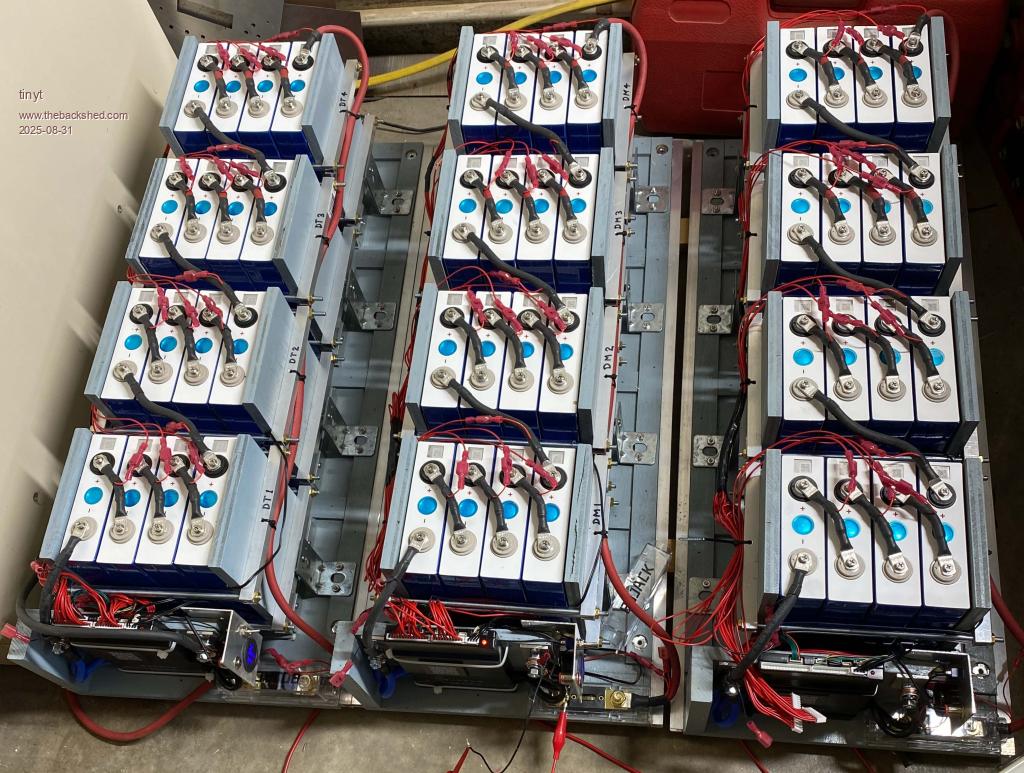

No change/difference. When I was assembling them I added two 10000 uF to the existing six 3300uF bulk capacitors. I also beefed-up with more solder and solid wires the high current carrying copper traces at the back of the power board. Maybe they helped.
The battery bank is 16S3P EVE LF105.

Interesting, I'm not sure if those inverter boards have low output voltage cutoff, and with what looks to a single toroid I suspect there was some AC voltage drop when starting the HVAC, if so the HVAC would receive much less current than the LRA rating and more like a sort start at that point, so yes it could start it and if lights where connected would have seen them dip/dim when starting large loads.
Only going by the information provided, probably a scope and some voltage logging would show exactly what is happening.
Nice looking build, would be interested to see how you go with a soft start.
Battery setup is looking good too.

The AWG8 wire length from the inverter cabinet port to the compresser is about 82 feet both ways which is about .052 ohms resistance. Including the added grid/inverter transfer relay contacts and inverter output contactor contacts, maybe series resistance is .07 ohms. So roughly voltage drop is 148 x .07 = 10 volts at the compressor. Including load regulation limitation of the inverter, maybe there is a limited soft start.
One of the four alarms of the EGS002 is undervoltage of the AC output and it is monitored in this inverter board. But detection and shutdown by the chip is 3 seconds after the event.
One of the strange behavior of the EGS002/EG8010 that we found out is under certain monitored AC output voltage condition, it will trigger overcurrent alarm despite it being disabled. It took us over a month to figure a solution and we are still not sure if we really fixed it. But that is another story.
