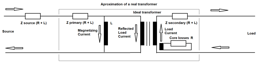

For a half-wave load it is more complicated.
The primary current has two components, the magnetizing current and the reflected secondary current.
Flux imbalance due to DC in the secondary current is almost exactly cancelled by an equal and opposite flux imbalance produced by the reflected component of the primary current. You don't want to "correct" this.
The magnetizing component of the primary current is where the problem arises. Any DC offset there can push the core toward saturation.
This is what needs correcting but how do you separate the two DC components?
Fortunately as KeepIS and others have shown as long as the halfwave current isn't too big it doesn't matter.

The two components of the transformer primary current can be seen better if you view a real transformer as an ideal lossless transformer with an inductor across the primary (assuming its series resistance and inductance are small).
Then the inductor current is the transformer magnetizing current and the primary current is simply the load current multiplied by the turns ratio.
The load determines what that current is, you can't change it without changing the output voltage. If you reduce the drive to one half cycle you will get a distorted voltage waveform.
Easier to see if the ideal transformer is 1:1. Vs = Vp and Ip = Is, You could replace it with a pair of wires. The only thing left is the parallel inductor.
All you need to do is ensure there is no DC through the inductor by adjusting the PWM a small amount.
The low impedance of the H-bridge will give the load whatever current it demands. The PWM adjustments above mean a non-linear load will produce a little voltage distortion but you just have to put up with that.
The only catch is in the real transformer you can't directly measure the inductor (magnetizing) current, making correcting it tricky.

Wouldn't the magnetizing current be approximately the primary current minus the (secondary current x turns ratio)?
Another thought I had is to use a fast comparator and just limit the peak current cycle-to-cycle. The IRF21844 gate drivers I use has a shutdown pin that could be toggled in an extreme over current event before saturation. It might be better to latch it off and let the controller turn it back on after some amount of time.
Posted: 02:58am
04 Oct 2026
  Quote  Wouldn't the magnetizing current be approximately the primary current minus the (secondary current x turns ratio)?
Yes, provided the current measurements are accurate enough and read on each cycle of the PWM frequency (to cater for distorted waveforms).
The magnetizing current is very small compared to the maximum primary current, 1% as a ballpark figure. So the accuracy of the transducers (not just the resolution) would need to be 0.1% to get a barely usable figure that is within +-10%, and 0.01% to get a reliable figure of within +-1% of the magnetizing current.

  phil99 said  Then the inductor current is the transformer magnetizing current and the primary current is simply the load current multiplied by the turns ratio
Er no, over simplified, the primary magnetising current 180° sections are not equal for a large half wave load due to the impedance issues outlined above.

Just measuring the primary DC component isn't enough. When there is DC current in the secondary an equal number of DC Amp-Turns must flow in the primary to counteract it. Only the imbalance between primary and secondary DC Amp-Turns needs to be corrected.
The net flux in the core (AC and DC) is the difference between the fluxes produced by  both primary and secondary Amp-Turns, plus the magnetizing current.
I hope this diagram better shows what I was trying to describe before. In that I left out all the series impedances as they are small compared to the load impedance (after factoring in the turns ratio) but have included them here for completeness.
Edited 2026-10-05 16:58 by phil99
