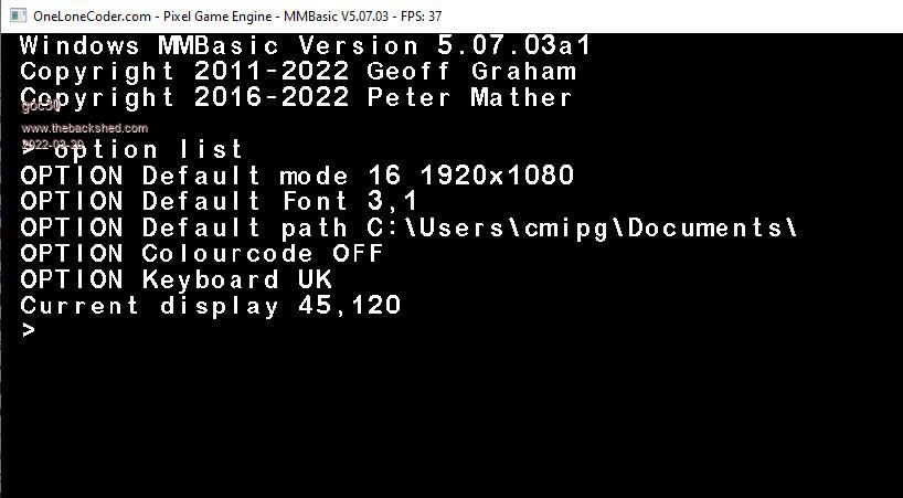

I would like MMbasic for windows to respect the basic rules and for example, when using the windows resolution, "MMbasic for windows" does like 999 999 999 applications, and positions the point 0,0 at the top left of the window and not under top horizontal border, as it does with mode 16 in 1920x1080 screen resolution
Posted: 07:39pm
18 Mar 2022
  Quote  I would like MMbasic for windows to respect the basic rules and for example, when using the windows resolution, "MMbasic for windows" does like 999 999 999 applications, and positions the point 0,0 at the top left of the window and not under top horizontal border, as it does with mode 16 in 1920x1080 screen resolution
It doesn't do as you say if you have a screen resolution big enough to display 1920*1080 with a border. e.g. a 4K screen
Use mode -16 to get full screen if you must otherwise use a lower resolution that fits your monitor.

first, can-you explaine this screen_capture
I am in 1920x1080 res and you can see that first line is visble, not under mmb4w window's top border
If the A1 version works and after that it no longer works, it means that you have modified something that worked well for something that has a malfunction.
Second, in mode 19 , I lost 80 pixels why?? have you tested a resolution of 1920 x 1079 ??
Third, If I put my second screen after bottom of first screen (posy1=1080, posy2=2159), mode 16 work correctly, but bottom bord of mmb4w's window is in second screen (y1=0 and y2=1080) why y2 pos is not 1079 ??
in all app working under MSWindow (from 3.1 to 11), windo's borders are into screen resolution, not out of, except mmb4w
