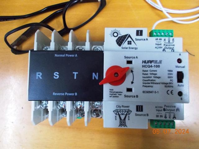

From the beginning I use the large ATS switch, the photos of which you showed earlier, I have the 4-pole version, and I use all poles. On the "receive" side, near the ATS, I placed a 275V AC rated surge protectors. I would really be afraid to use these tiny relays, especially when charging capacitive loads and disconnecting inductive loads.
This large 4 pole switch seems to be OK as it will never turn on both AC sources at the same time. My only concern is a failure where the contact servicing the neutral line will stick and the other contacts will switch, but I'm not sure if it's even possible with such a large electromagnet arm.
4p ATS definitely faster towards switching to the inverter, switching to the mains is slower and some LED lamps dim, but it does not make any difference to other devices - TV,
computers etc won't even blink.
However, it's good that you were there and the injuries are not painful

Thanks, nice to hear yours AT Switch is working fine, we mentioned previously that we  had the same 4 pole unit ready for install. Interestingly, mine appears to have the same fast switching speed in both directions.
The first time I tested it on the bench, I thought I'd blown something, I wasn't ready for the force and noise generated as it switched, dam thing nearly jumped of the table, I said
I've tested it quite a few times now and it's definitely faster than the old unit, the inverter is a lot happier as DC input current on changeover is noticeable lower for the exact same loads.
This makes me wonder what sort of small arcing, contact bounce, contact loss or delay was happening all along in that old dual relay switch.
I should have stripped it down years ago and checked correctly, but I simply went by online reviews at the time - kicking myself now.

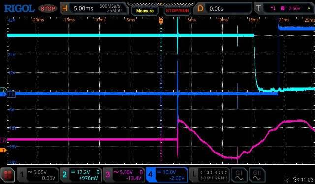

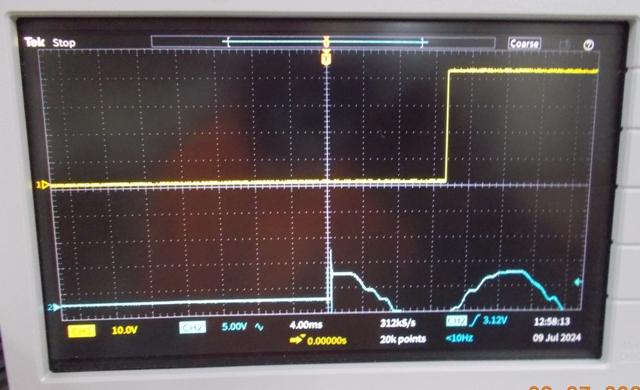

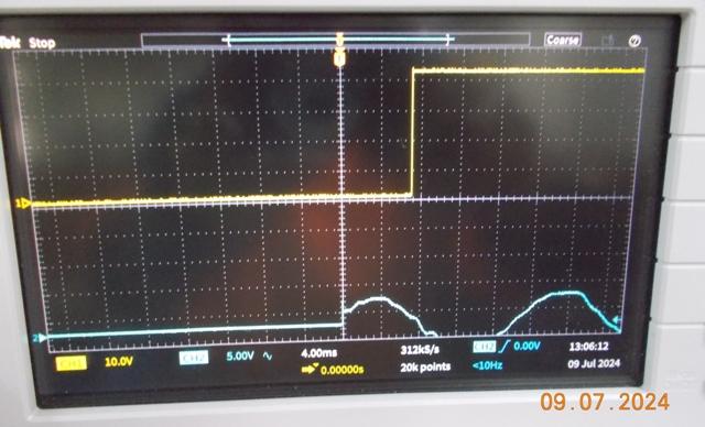

Hi Dex, I had another look at the transfer switch changeover timing:
Transfer time appears to vary between 7ms and 13ms on my unit.
I was switching 50 volts DC and triggering on solenoid 240VAC input rising edge. I had a 0.01uf cap across the CRO probe to remove some slight contact de-bounce with zero current DC switching.
There may be some bias timing in one transfer direction, however I put that down to mechanical variances, the rotational shaft movement and solenoid layout appear to be physically mirrored, obviously there would be some variation between all these ATS units.

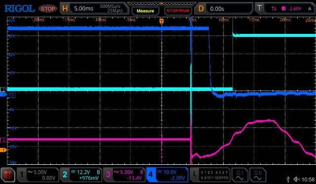

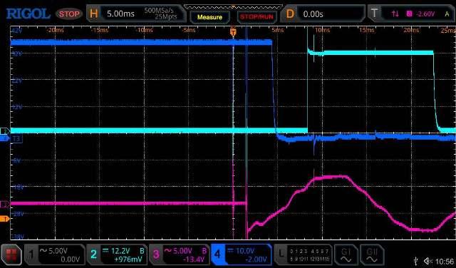

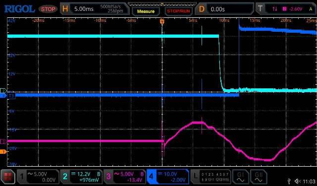

I thought about the timing variations and realized that I had not tested this correctly.
The Spec suggests that these Solenoids under load will not pull in much below 200VAC, they will quickly burn up trying to rotate the switch shaft as it may never reach the solenoid disconnect micro switch.
So I added a a third probe to measure the physical transfer time of the contact transfer independently and it's consistently around 5ms in both directions.
The command to initiate a transfer is controlled by switching 240vac to enable the selected solenoid, the point of switching in the AC cycle could be influencing solenoid pull in time? maybe not?
There is also inrush current in an AC solenoid at turn on, and the slower it moves from it's off position the longer the inrush current is drawn before it starts to fall, I can see this at times by a flick in the overhead LED lights on energize, I'm wondering if this is due to the point of enable in the AC cycle or just mechanical difference in force / friction to rotate the switch shaft in one direction?
The trigger is still AC across the Solenoid, triggers in both directions, trigger capture trace starts at 0ms, but AC appears to be delayed in some of the captures, you can see a trigger pulse but no AC at T, I'm closing a switch to enable AC, wondering if I'm getting some weird contact bounce on switching AC to Solenoid.
Thoughts or corrections welcome from someone with experience of AC solenoids etc.

Posted: 06:02am
10 Jul 2024
  Quote  the point of switching in the AC cycle could be influencing solenoid pull in time? maybe not?
First  question, yes. As the coil is an inductor the initial peak current will be almost double the normal peak if switched on close to a zero crossing of the supply voltage and equal to the normal peak current if switched on close to a + or - peak of the supply voltage.
Higher current = faster pull in.
Second question, the coil is a variable inductor that varies greatly with the position of the plunger. Increasing L as it pulls in, hence the overheating if it takes too long to pull in or the voltage is too low to pull it in.
If you are concerned about that add a suitably rated PTC thermistor in series with the neutral of the two coils. If the current is too high for too long it will heat up and go high resistance.
Most refrigerators use a PTC to switch off the start winding before it overheats.

Posted: 06:43am
10 Jul 2024
KeepIS
Thanks Phil, I indicated the inrush current but I didn't bother expanding on inductance change as the solenoid plunger entered into the coil housing.
Coming back to that initial question, as you know, one of the main advantages of an AC solenoid is the speed, mainly due to that initial high inrush current that also has the advantage of decreasing current as the solenoid is fully energized (max inductance)
My question is more about the AC waveform being around zero crossing at solenoid energize, could that cause a delay of few ms before the solenoid was fully energized?
Keeping in mind that these solenoids are wound for a very short high energy burst lasting less then 50ms worst case.
The PTC is a good idea but not really warranted in my case, if the solenoid inhibit micro switch did not close, it usually means that the mechanism has failed/broken anyway, or AC is below 200vac on mains AC, which would be a brownout followed by no power here.
AC can't be low on the Inverter output as AC must be above 239vac before the controller will switch the AC output on, and if AC output drops below 220vac, the controller will disconnect it.
Posted: 07:39am
10 Jul 2024
  Quote   the AC waveform being around zero crossing at solenoid energize, could that cause a delay of few ms before the solenoid was fully energized?
With a pull in time of 5ms, which is 1/4 cycle it probably won't make a big difference at what point in the cycle it is energised.
Energise it at peak volts and in 5ms it will be 0 volts.
Energise it at 0 volts and in 5ms it will be peak volts, so about the same.
Where there may be some difference:-
Energise it at 2.5ms before peak volts and during the 5ms it will rise from 0.71*peak volts through peak back to 0.71*peak. So maybe a little faster.
Energise it at 2.5ms after peak volts and during the 5ms it will fall from 0.71*peak volts through 0 back to -0.71*peak.. So maybe a little slower.
The main variable is probably friction.
Edited 2024-07-10 17:50 by phil99
Posted: 08:39am
10 Jul 2024
KeepIS
Thanks  I think you are right, friction would likely be the major influence, considering the cost of these units they preform pretty well, but long term we shall have to see, fortunately it only operates occasionally in this setup, and the way our grid design is going, it may only have to last for a year or two before it's permanently off grid

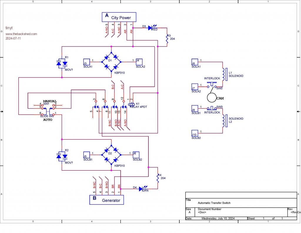

I'm using the 2 pole version of this similar unit for now.
There are dozens of the videos on the internet, some are wrong and would burn out a solenoid in no time, none show any use for the passive relay contacts apart from switching indicator lights, and the dam circuit supplied with them is wrong, and circuits on the internet are also wrong - WTF.
None mentioned the warning about burning out solenoids if the AC was low, the manufacture does not hint why, but one look inside and it's bleeding obvious, I should have realized without opening it, but when your doing 100 things at once - sigh.
So, I have it working with the addition of a single small 3A AC SSR "Solid state Relay"
I used the same Mains/Solar priority switch with a tiny 240vac to 6v transformer and small housing I had used before, the only connections to the inverter are the AC enable output pin from the controller FET and a ground connection - brilliant!
The circuit shows two relays, one on the Main power input and one on the solar/Generator input, this is wrong, there is only one relay for the two "Passive contact outputs" on each AC input.
That relay is controlled by the Top input only, because of that, it allows the use of lower input passive contacts of that relay be used to stop the backup AC input powering the solenoid if the Top input also has AC mains. You cannot have AC on both inputs unless one solenoid is disconnected. The solenoids are driven by two wires from each AC input connected to the AR, AN and BR, BN terminals on the two green plugs.
When a solenoid detects AC, it pulls the switch cam across and a micro switch disconnects the Solenoid to stop it burning out. You can see what would happen if both inputs had AC applied. It turns out though, that this is a really brilliant design and so easy to use once you realize the dam circuit is wrong.
I can post the connection layout I used if anyone is interested.

Nice job of drawing that up and I'm glad you went to the trouble, it reveals a difference between these 4 pole units and the two pole unit I disassembled.
Note: Some of these ATS devices have different labels for A and B inputs, Like Solar and Generator, or Solar and City power or Common power and Generator.
The two pole unit does not switch the solenoids or prioritize "A" input with K1 - which is not ideal, If both solenoids have AC applied, one will burn out, I used the passive contacts on "B", which is actually controlled by "A" input, to disconnect "B" solenoid when "A" is energized, which is what the 4 pole design is sort of doing.
With these 4 pole units, "A" will always prioritize as it controls relay K1. You only need to decide if you want generator AC or Inverter AC to have priority, and that's it, but it can be easily changed with an SSR and a switch.
However there is an error in the passive relay connection labels, if "A" is in NC  position (which it is when not energized) then "B" must be in the NO position, check with a meter and if it's like mine, NO on "B" will be shorted when A-NC is shorted.
Notice that input "B" does not have to switch relay K1 to energize B-solenoid, however "A" must energize K1 before A-solenoid is energized, this adds quite a few ms to the transfer time when "A" is energized, and is slightly slower than "B" when switching, which I'm guessing is what Dex is noticing, K1 is an AC relay so it might be quite fast but there is a difference as shown in the DSO pix.
In order to add a priority override, I used a small 240vac/3A SSR, previously when testing relays I found delays over 5ms on some small relays, an SSR is fast.
I connected the SSR in the "AR" lead and used a tiny 240vac to 6vac transformer with a single diode and a 47uf cap, a 1K resistor connects this rectified DC to the 3vdc-32vdc enable pin on the SSR, so if "A" input has AC, the SSR is on and everything is normal.
The Controller AC enable pin switches to ground on AC enable, so this enable pin is wired to the SSR enable pin via a single pole switch for Generator AC or Inverter AC priority.
If the Inverter AC is enabled, shorting the SSR enable pin to ground stops the Generator AC input from activating, if inverter AC is on "B" input, "B" activates and solar has priority until the Inverter disables the AC enable line. Turn the single pole switch OFF or ON and you have Generator AC or Inverter AC priority.

FYI: The delay and spike at 2.5ms after AC input is applied at 0ms trigger point, and when AC appears, is caused by relay K1 closing and energizing the solenoid.

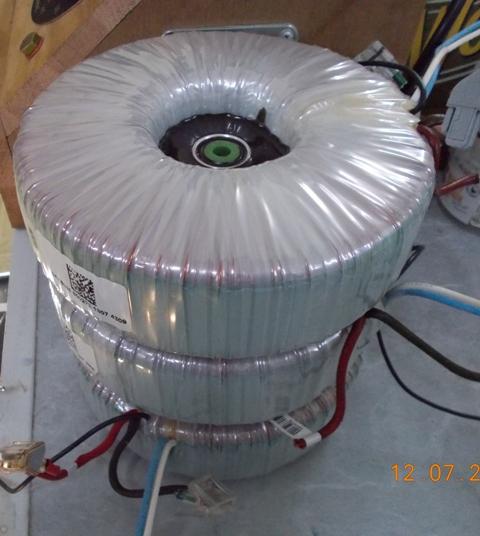

By some weird coincidence, look what followed me home today
Looks like another one of us on the forum might be having thoughts of a twin power stage inverter starting to appear, in my case, a conversion from a single 3-stack toriod to a 6 Toroid Inverter, a Nano controller and two 3-stacked Toroids with 2 power boards.
_

Go for it you can test the two power boards 12KW design before I get to it. Are those Toroid 3 phase and you going to wind them in series like a warpinverter ? I would like to see the two power boards in action running 12KW.
Posted: 11:10am
12 Jul 2024
KeepIS
I use these toroids because they have a heavy 93vac first winding on the cores, I remove the 235v outer winding from each, I stack the 3 toriods and wire the three 93V winding in series.
I wind 14 turns of heavy primary through the stack and it's ready to go. I use the exact same 3 stack toroids on my existing inverter, it's taken a long time to find another three exactly the same, the day after we discussed it on the forum I found these.
I have come up with a plan to have 5 smaller housing that lock together as they are placed on top of each other, the idea is to make it easy to simply undo the interconnect cables and move / lift each section for any servicing, the idea is to keep the weight of the two toroid and choke housings to a minimum. This is just a variation of the three tier single cabinet I currently use for the inverter.

Ok I'll bite - where did you "find" them, it was certainly a good find and quite unusual to score 3 identical ones in the one hit ?  I am also interested if you have found an easy technique to remove the centre plug which I agree is almost like concrete to shift.
Edited 2024-07-12 22:10 by wiseguy
Posted: 12:15pm
12 Jul 2024
Cpoc
Very interesting and a different approach. I don’t have access to spare Toroids over here so I have no choice but to buy new. If you can reuse and recycle then hey why not and save quite a few dollars as well. Since it’s been a while since my last build it may be my last but then again some people may want me to build them an inverter. I hope not because winding toroids by hand is a really pain in the ass. The primary is super easy it’s the secondary that’s difficult. That’s why I use AWG 9 or 10 gauge wire because while the wire is thicker I only have to wind one layer. In your case the hardest part is done and winding the primary is super easy. I would really like to see the two power boards up and running being driven by a single mainboard running at full 12KW.
