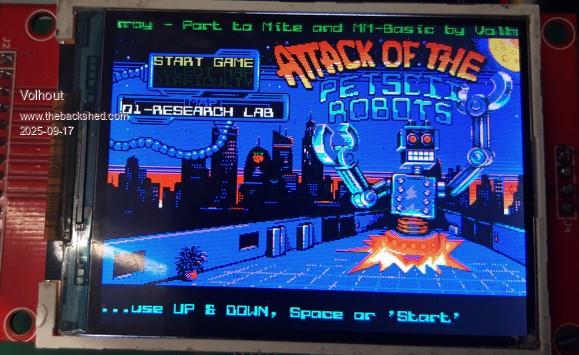

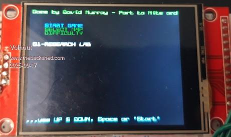

16 Sep 2025
@Peter,
I have problems with b12
- On 2350 gamemite: when running petscii robots, framebuffer merge does not work anymore. This works fine on b11.
- On 2040 gamemite: when copying from B:/ to A:/ files get corrupt.
Sorry, this is not a good move forward.

Posted: 09:09am
17 Sep 2025
  Quote  EDIT: Framebuffer merge problem: also present on 2040.
Works for me on RP2350 running Petscii. Haven't got a Game*Mite to test on - may be something to do with the OPTIONS. Please try OPTION RESET GAME*MITE if you haven't done this recently

Posted: 09:48am
17 Sep 2025
@Peter,
This is the phenonem.
b11
b12
Seen this on 3 different pico-lcd combinations. The photo is from a non-Game*Mite LCD connected (SYSTEM SPI) 2040. But it is the same on the Game*Mites.

I simply can't replicate - works perfectly for me with the firmware just posted above
Posted: 10:04am
17 Sep 2025
Confirmed
This last version works okay for 2350 in Game*Mite with Petscii robots.
I still have to check the file transfer issue, but the framebuffer merge issue is gone.
Edited 2025-09-17 20:04 by Volhout

Posted: 10:18am
17 Sep 2025
Petscii loads many files, and copies them to flash. Maye in that transfer faults resulted in framebuffer faults in the game that look like the merge is going wrong.
So they may have been caused by the same problem.
