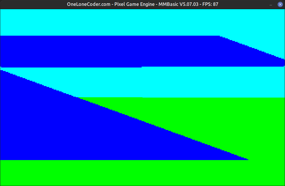

04 Apr 2022
LeoNicolas
Hey Peter
I discover two issues running the MMBasic on wine (I don't know if they happen on Windows)
1) The page copy seems to do not respect the B argument. It is generating rendering artifacts.
option explicit
dim c,k1%,k2%
mode 3,1 ' 320x200
page write 1
do while 1
 timer=0
 ' Keyboard
 k1%=keydown(1):k2%=keydown(2)
 if k1%=120 then exit do
 ' Draw scene
 box 0,0,mm.hres,mm.vres/2,,rgb(cyan),rgb(cyan)
 box 0,mm.vres/2,mm.hres,mm.vres/2,,rgb(green),rgb(green)
 for c = 0 to MM.HRES
   line c,30,c,170,1,rgb(blue)
 next c
 ? @(0,0) str$(1000/timer,0,2) ' FPS
 ' Copy memory page to screen
 page copy 1 to 0,b
loop
page write 0
cls
mode 1

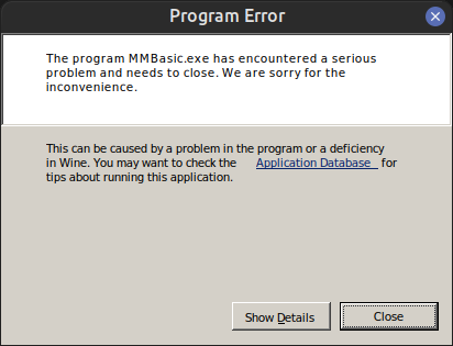

2) Sometimes the interpreter closes with the following page fault:
This is the backtrace:
Unhandled exception: page fault on read access to 0x00000014 in 32-bit code (0x00443f74).

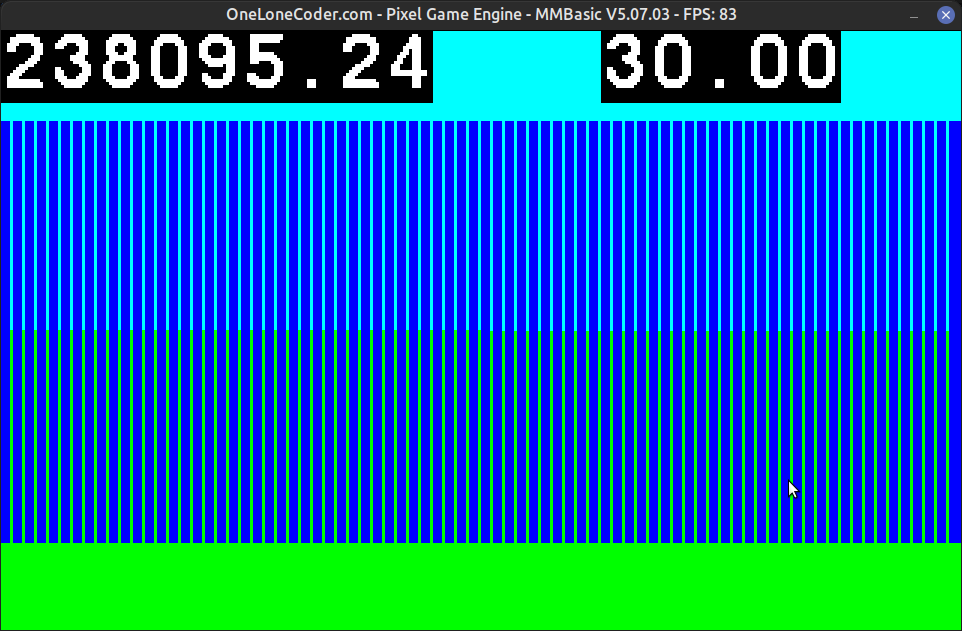

Page copy does not implement the "B" or "D" as there is no way of knowing the raster timing. Without the copy in a tight loop as you have it the copy is so fast that you shouldn't normally see any issues. I'm seeing 1700FPS on your test vs a screen refresh rate of 60Hz hence the artefacts (the framebuffer is getting written 28 times for each screen refresh)
Can't help with the wine issue. Looks like it might be running out of memory and unable to page - can you set the pagefile size in wine?

  matherp said  Page copy does not implement the "B" or "D" as there is no way of knowing the raster timing. Without the copy in a tight loop as you have it the copy is so fast that you shouldn't normally see any issues. I'm seeing 1700FPS on your test vs a screen refresh rate of 60Hz hence the artefacts (the framebuffer is getting written 28 times for each screen refresh)
Thank you Peter
I updated the code to control the scene repaiting. The left counter is from the main loop and the right one is from the screen rendering.
